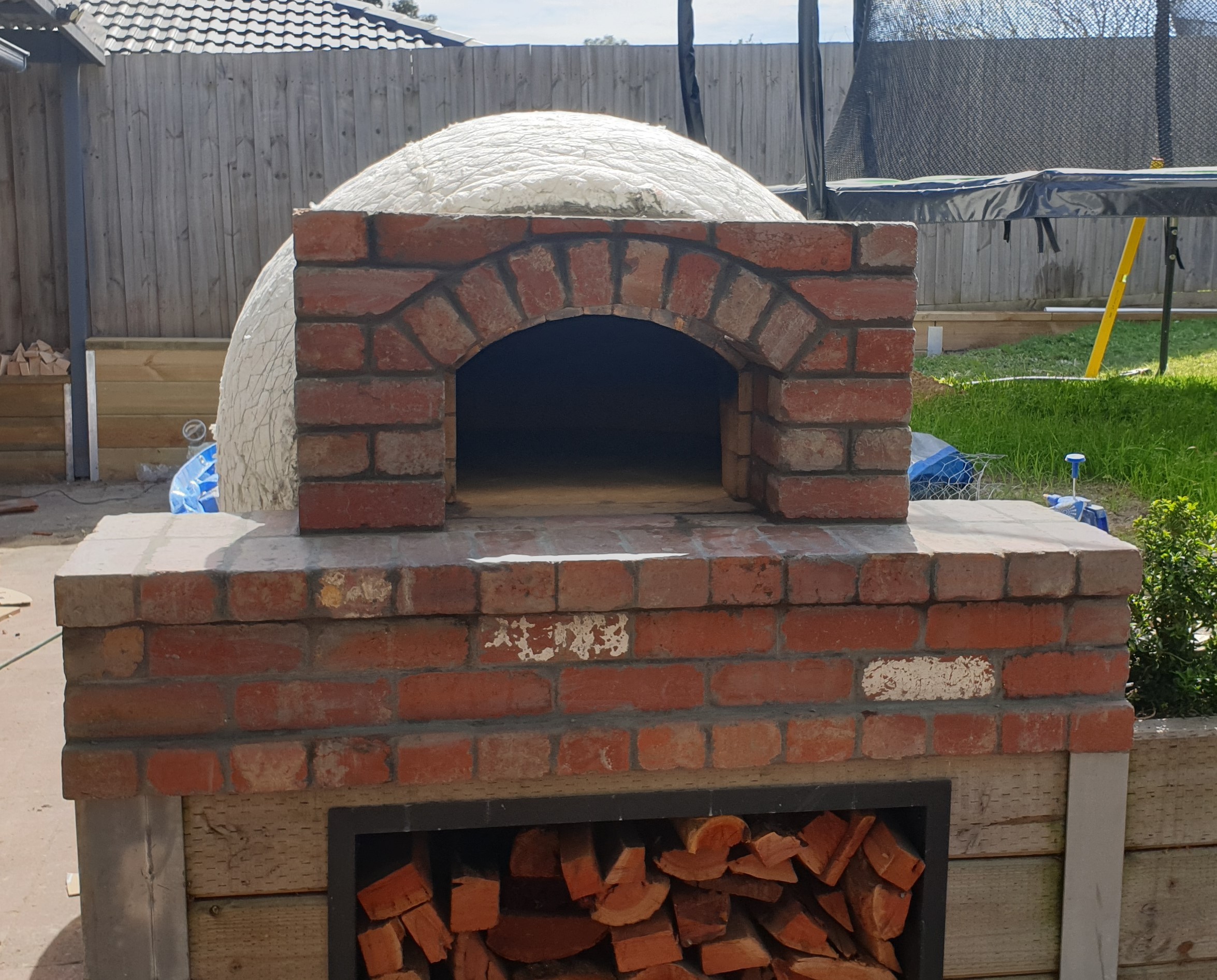

          Thought I would post an update, I have built the landing and outer arch, put on 3 layers of ceramic blanket and put on the chicken wire, now on to chimney.
          Things I learnt this week are - I would not make any money as a brick layer, and lime is brutal on the hands.

            Finished it

              Congrats Paul, looks good.

                Nice work Paul. I like your door and door handles. I'm busy making a door for my oven at the moment.
