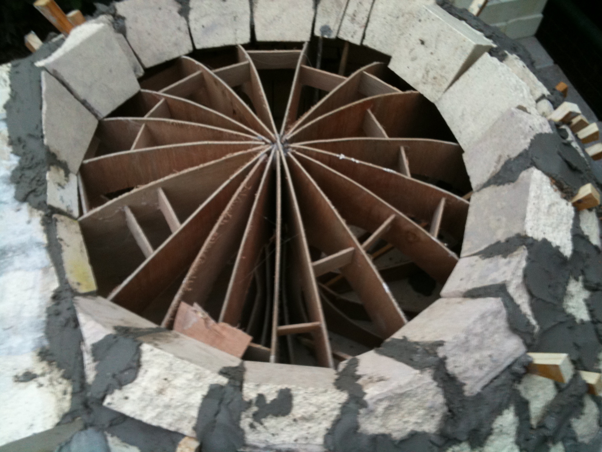

                        Told you masonry impaired

                          Restarted build last week after cold winter and extended spring holiday. Happy to report refractory mortar is setting just like ordinary concrete mix. Oven archway entrance now complete. I've posted a photo of the early stages of the archway build. This was relatively straightforward given that I'd built a really good former. The former has one eighth inch plywood shims underneath and at the sides which will be removed before I draw it out of the arch.

                            Great to hear your making progress. So you going the dome vanes construction method, fair enough. If I've caught you some enough, cover the floor with some thin ply or cardboard, it will help to stop any dribs of cement sticking to the hearth floor. Makes your clean up easy.
                            Why don't you post what you planning . You'll get some advice to steer you around the tricky bits, and keep you out of trouble.
