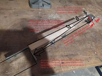

        As I mentioned, the castor height is not a deal killer but most important is the projected line from the pivot point along the wood needs to intersect the center of the brick face or you end up with stepping of the brick face as you move up in courses. The error is cumulative. I marked the attached picture for another builder years ago but is is similar to the IT you are considering using.

          most important is the projected line from the pivot point along the wood needs to intersect the center of the brick face, or you end up with stepping off the brick face as you move up in courses. The error is cumulative. I marked the attached picture for another builder years ago but is is similar to the IT you are considering using.
          Thank you, unfortunately I can't read the remarks in red on your picture, but I can see the geometry in black. I simply followed the instructions of a guy who published the built of his outdoor kitchen on YouTube.
