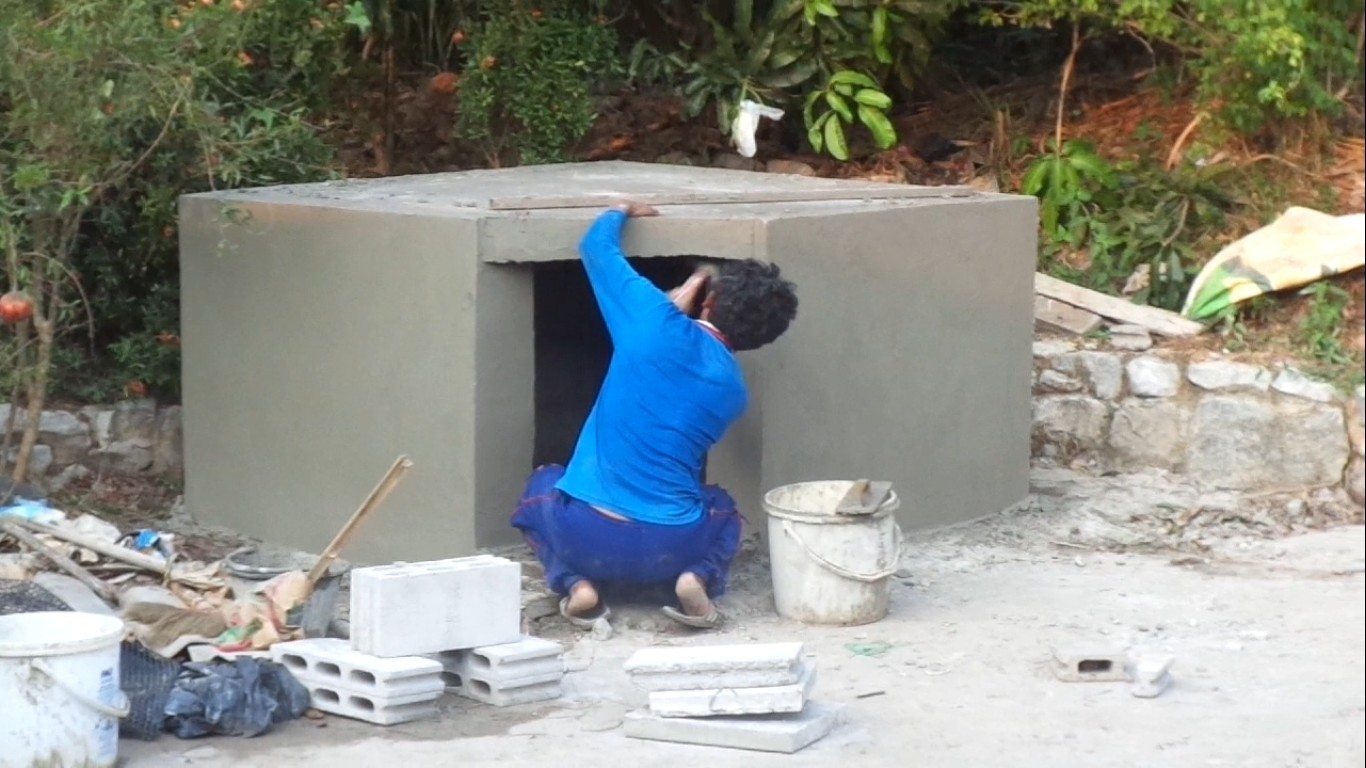

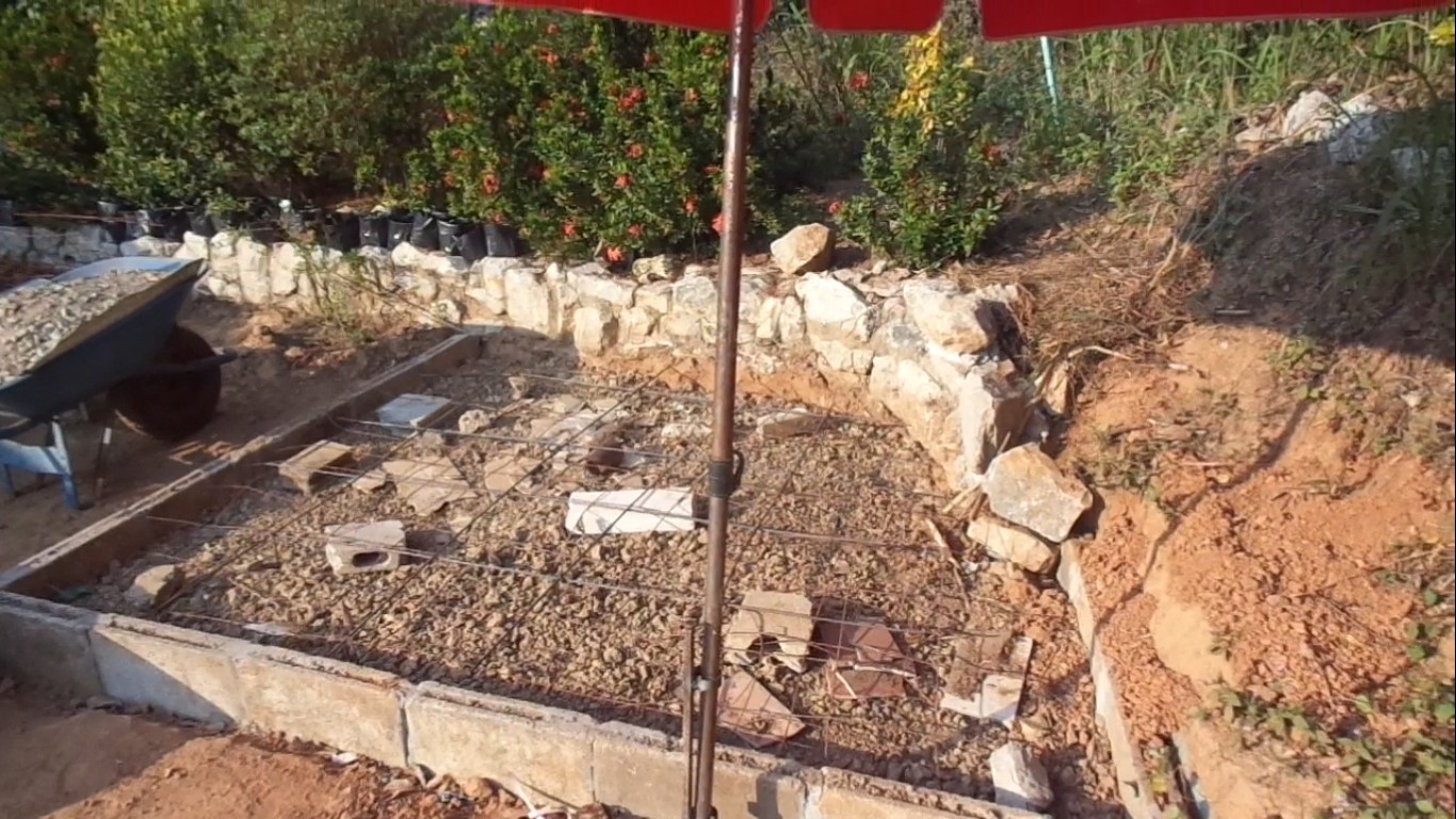

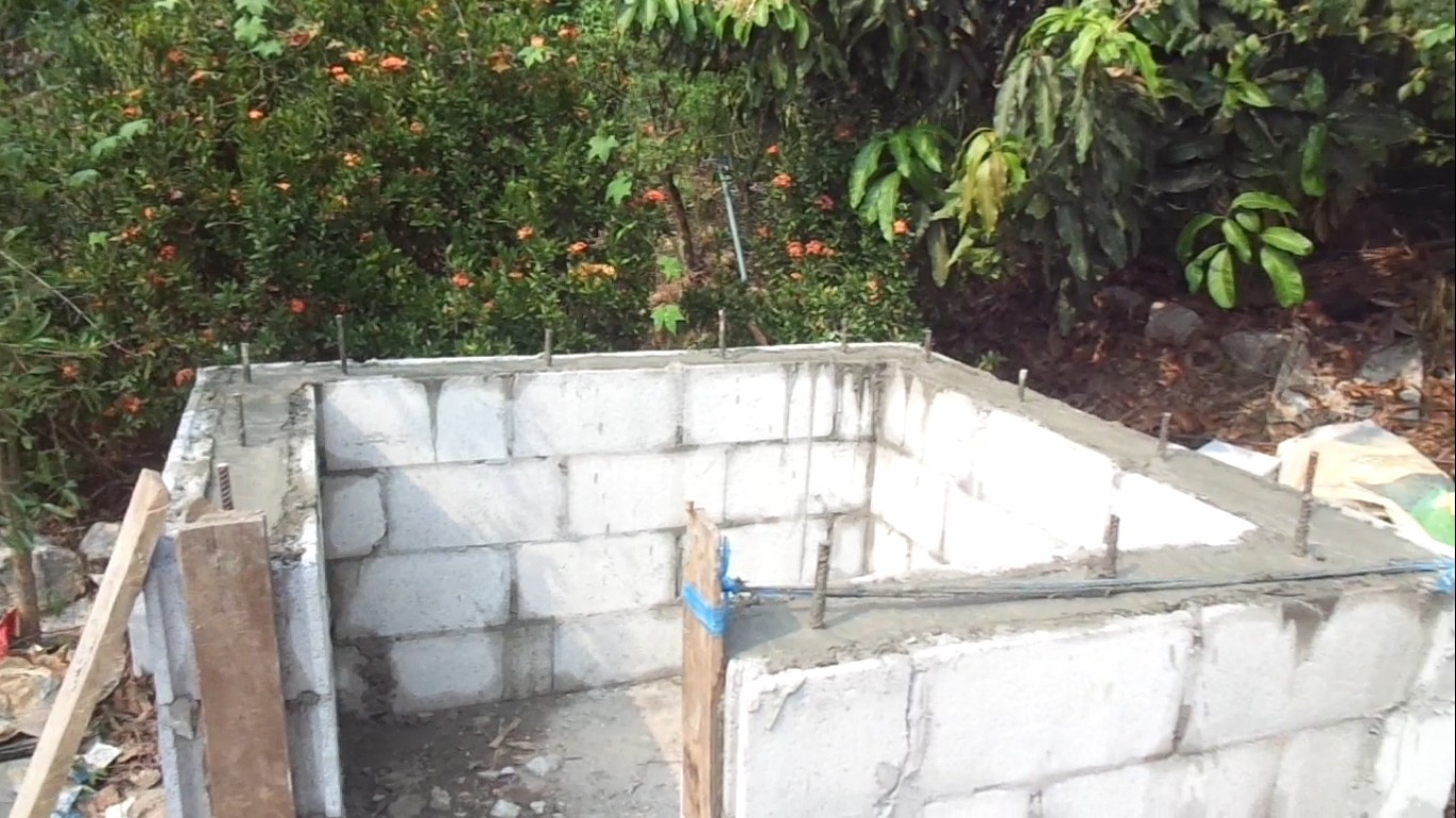

    I'm a Belgian living in Thailand since 2003, first in Chonburi where I worked until I retired in 2017. My wife comes from Loei, so we decided to settle in her village, uphill outside the village in fact. The first purpose of that project of pizza oven is to bake bread, and hitting two birds with one stone, also pizza and other foods using the remained heat.

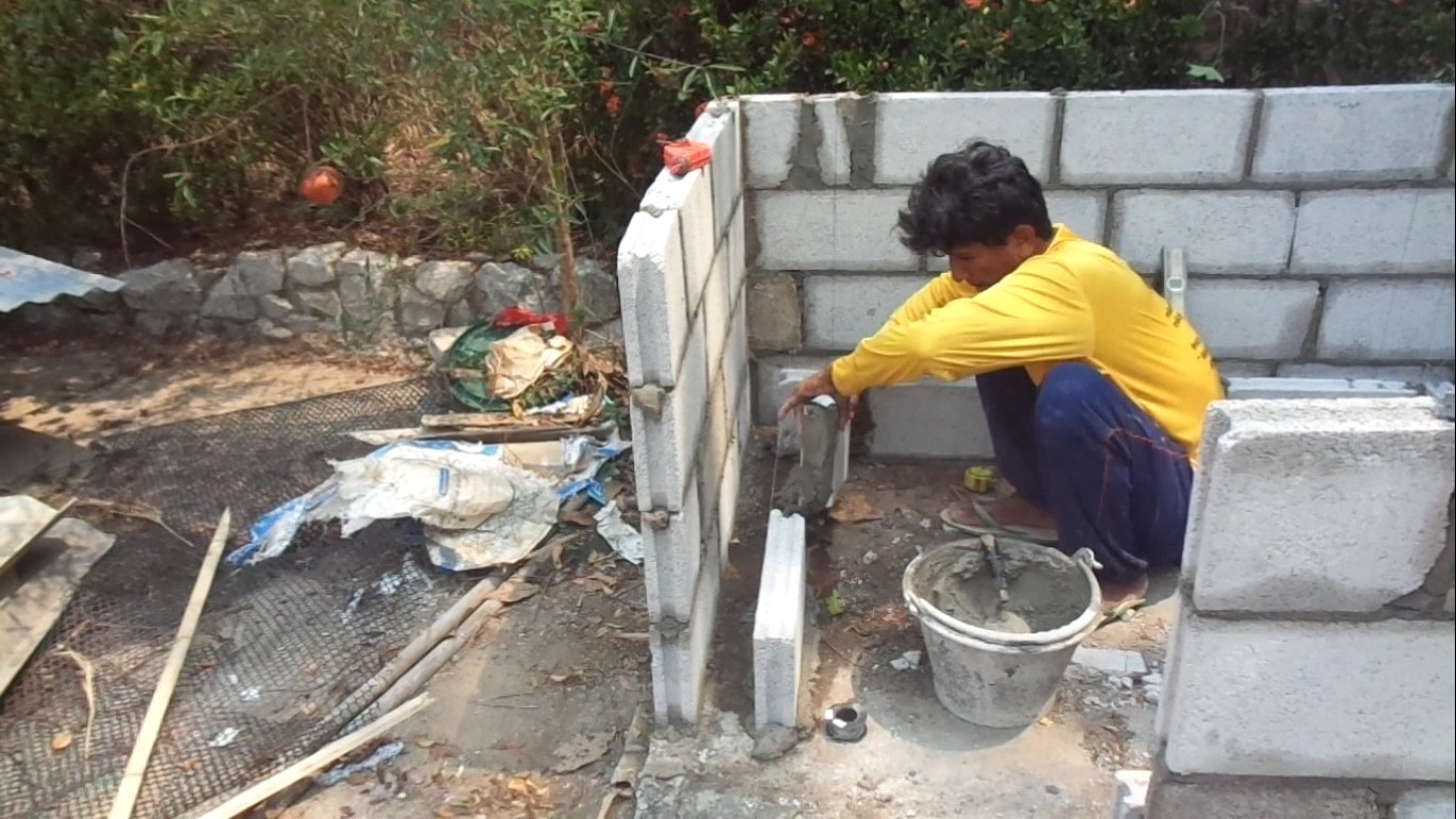

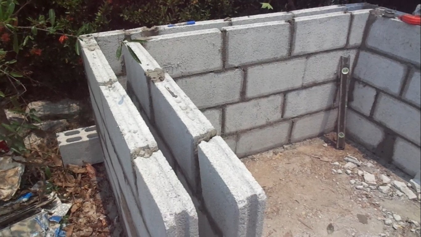

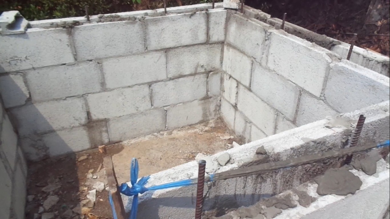

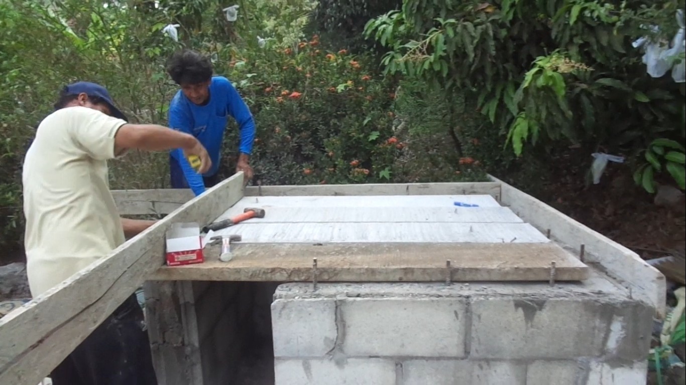

    The size of the oven will be Ø 40 inches. I built the foundation two years ago because we were going to pour concrete in the yard in front of the house. The base has just been built by people from the village. I had two walls built because you don't find big concrete blocks here. I'm afraid, I will have to build the rest by myself because it's a technique that neither they nor me are aware of. The next step will be the laying of the vermiculite floor, 4 inches thick. I found a factory of refractory products in Prachinburi and I will go myself to look for the refractory bricks, the refractory mortar as well as the clay for the laying of the refractory bricks of the bottom.https://motproduct.com/%E0%B8%95%E0%...%E0%B8%B2.html I get a lot of inspiration from the videos made by Artisan Made.

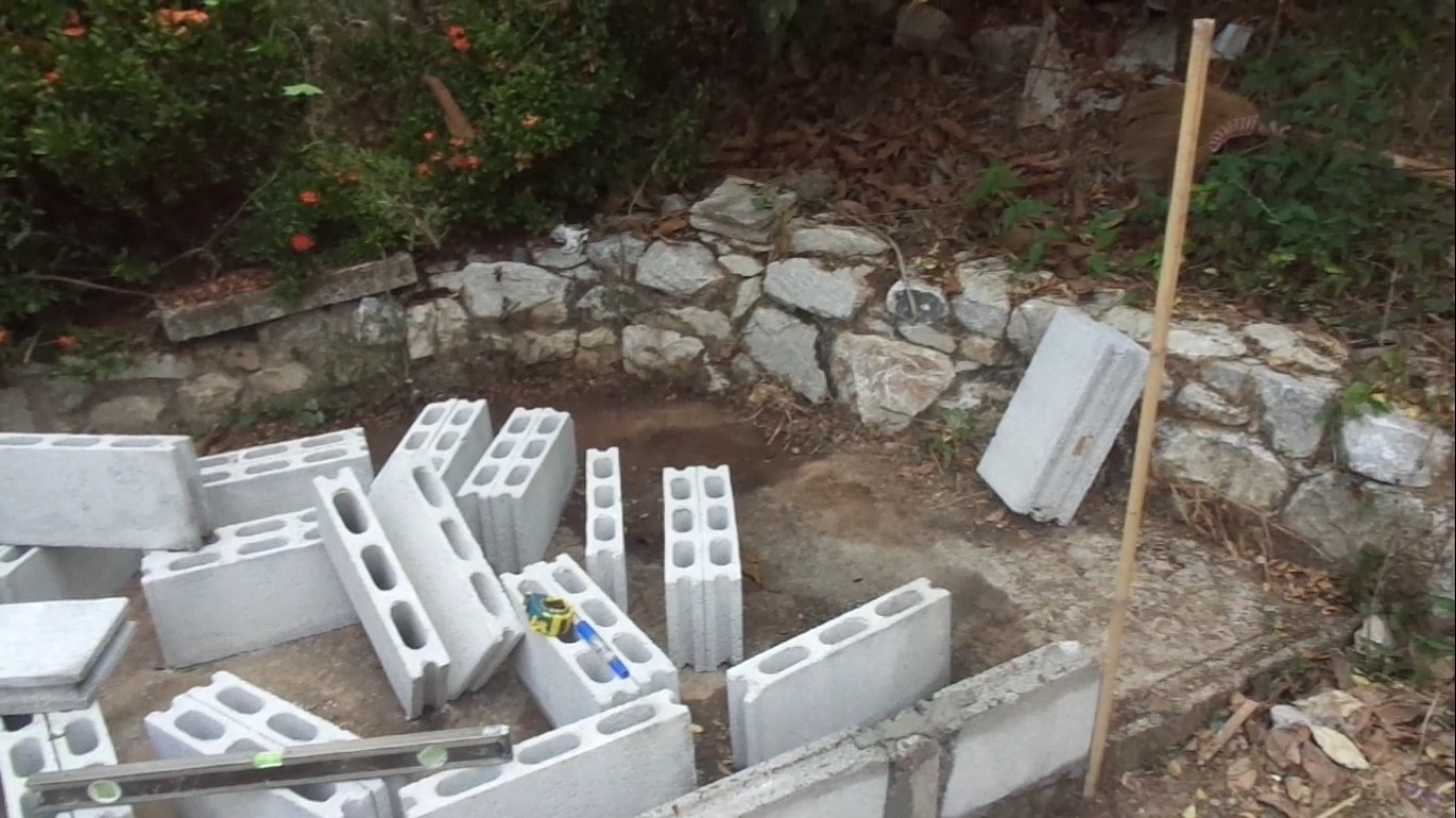

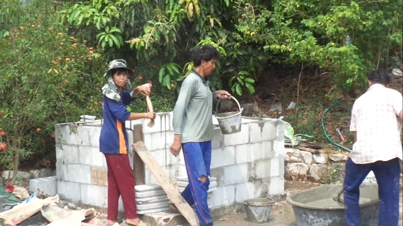

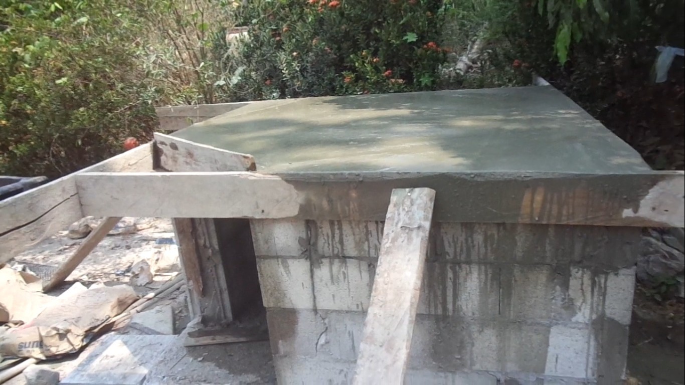

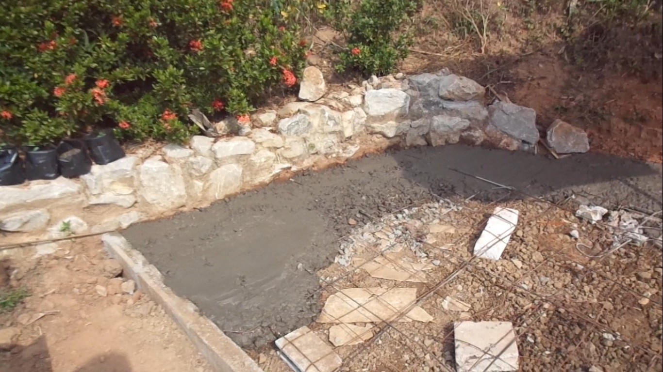

    Some more pictures

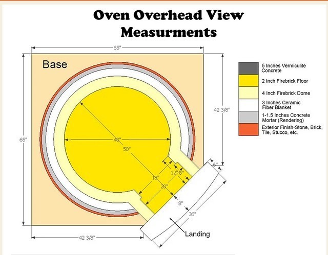

                    My concern about that video is that the first template he shows at the beginning of the video is longer that the one he actually uses in the end.
                    I this a correct drawing (see picture)?
                    • Garouda
                      • May 2023
                      • 40
                      Anyone has an oven floor template for a 40" oven? I'd need drawing plans to build the vermiculite formwork for the floor.
                      I've seen some differences on the templates, and not sure why some have straight openings and some have a bit of a diagonal opening.
                      Any thoughts?

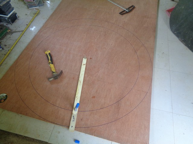

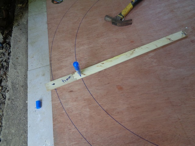

                            Next step, the formwork template Click image for larger version
Name:	base coffrage vermiculite 1.jpg
ID:	453281 Click image for larger version
Name:	base coffrage vermiculite 2.jpg
ID:	453282 it's frankly speaking too hot to work outside now, even in the shade. Normally in this period of the year we have rain, but the seasons have hanged.

                              The vermiculite has been delivered, the formwork is done, I took the cuts from the floor template to hold the circle in place and four wooden planks locked with four F-clamps made a frame to hold everything in place. I bought a tent for both sun and rain. I got short of vermiculite... I calculated a volume of 150 litres, but the two 100-litre bags were not enough, they seem to have a different definition of the litre down here...
                              Total volume: 71 cm x 43 cm x 10 cm = 30530 cm3 and 123 cm / 2 at the power of 2 x 3.14159 x 10 cm = 118823 cm3 : total 150 212.8 cm3 or 150 litres... A piece of advice, take some empty beer bottles you must have somewhere in a corner, break them in small parts to have about a 1/2" layer, and you won't risk being facing the same issue with your vermiculite. I did not consider that problem and of course, I'm not going to put glass as first layer under the refractory bricks...
