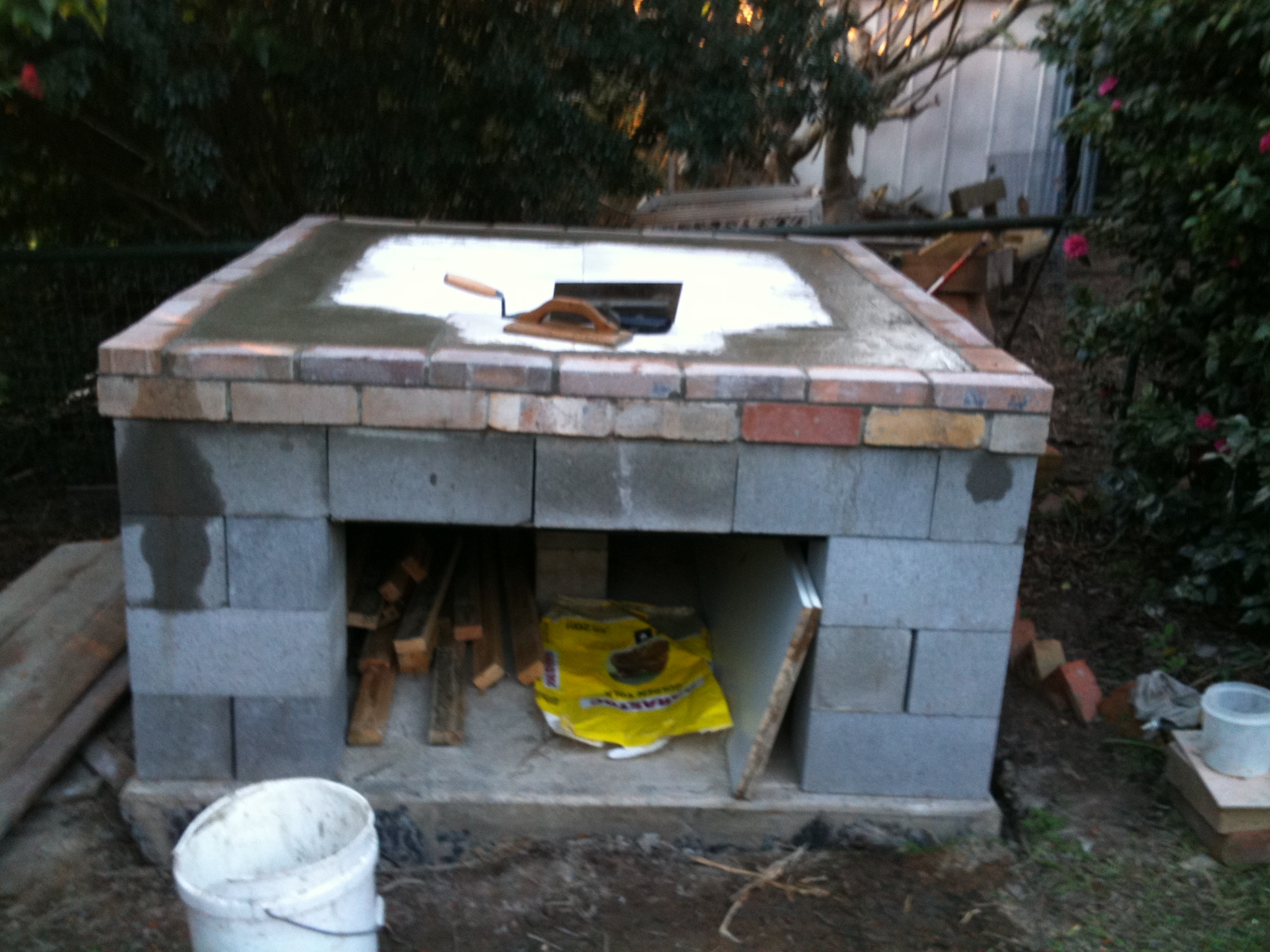

    Had a collection of bricks on hand so I ran a layer around the edge Looks good and no formwork requied for the slab edge. dropped bent steel into the every secound unfilled hole in the blockwork to the floor in the slab. Looks like I'm comitted now recon I ll need a bobcat to knock this thing down. Child bride is horrified be the size and the time taken thus far and still no pizza.Click image for larger version
Name:	floor slab poured.jpg
      Re: cobblerdaves build
      Hearth insulation
Name:	insulation layer.jpg
      for the hearth insulation I used 50 mm (2 in) Hebel block mainly because I was given some free again used a layer of 50mm payers at the edge of the slab instead of building formwork should look good at the end I hope.
