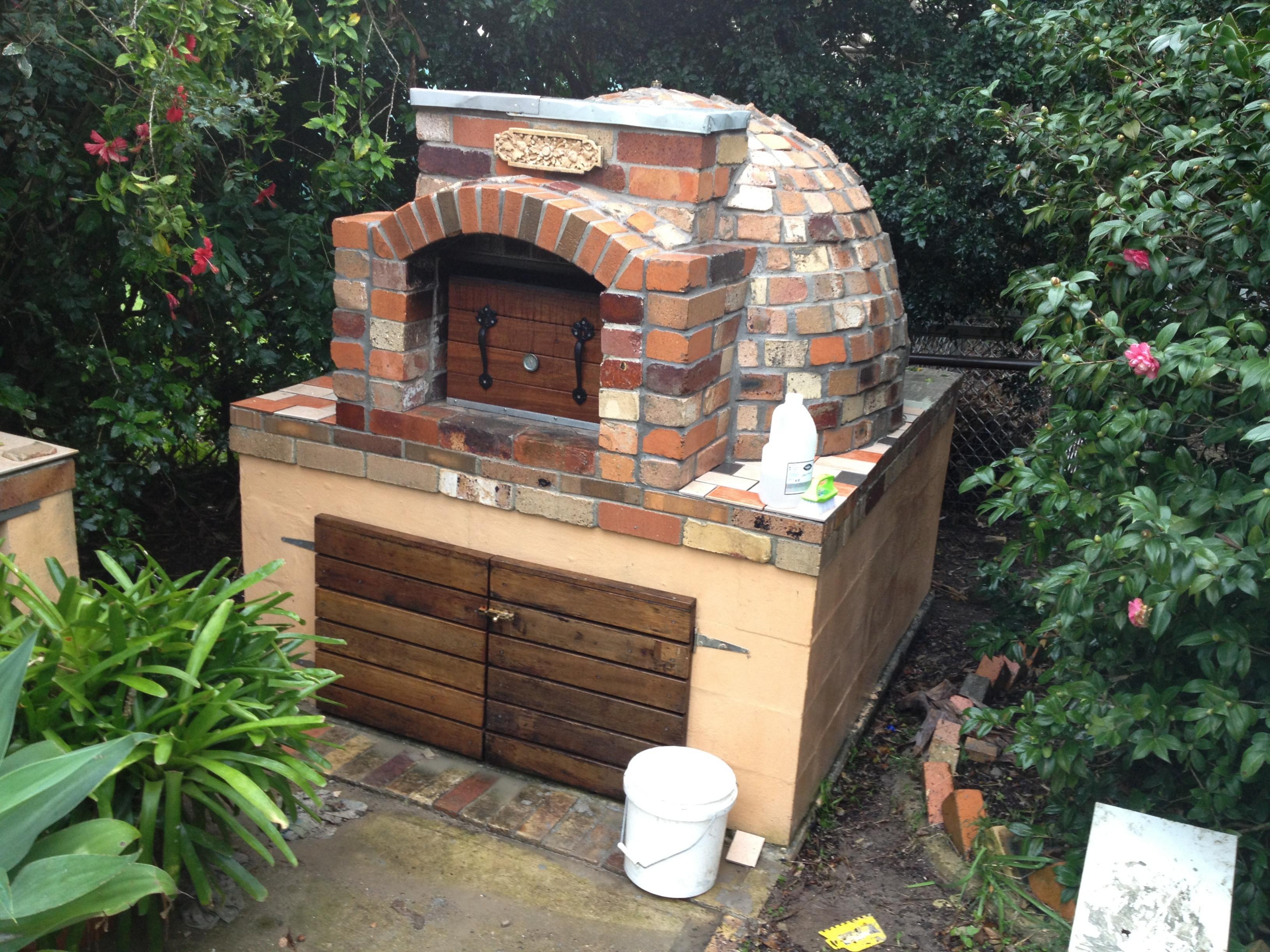

                Rained off and on all week and the today yep you guessed it rained again. Which is great. Let me make some more progress.
                You are probably thinking at this stage I have gone bonkers , but it has been heaven sent. Course can't finish the tiling, but the week of rain has gone well to soften the lime scale over the oven!
                Broke out the scrubbing brush and a bottle of vinegar and gave the bricks a good scrub. Now vinegar isn't the best choice for removing lime scale but its pretty soft on the skin ,cheap and after a week of weathering works a treat.
                Add a pressure spray down and.....
                Now it just has to stop raining so this puppy ill dry out and I can put on some brickseal and were done ....almost
                • #53
                  Re: cobblerdaves build
                  Dave save your vinegar for the fish and chips, once the water dries off the oven the scale will still be there.
                  My Build.
                  Books.
                  • #54
                    Gudday
                    Beg to differ .... But it does work. Have you never used it brickie. Anyway it's perfect for my needs. Those old bricks I want to remove my lime scale only and leave the pantina of old mortar etc cause there old bricks and I want them to look that way.
                    If you really want to wipe the surface clean so to speak and still keep from buying heaps of stuff you can use ....
                    Use diluted hydrchloric acid pool suppliers ( small amount for spa )or best somone with a pool cause you don't need much.
                    Or deck clean from the hardware contains 10 per cent a asolic acid.
                    • #55
                      I have used it, thats why I know it dont work.

                          • #58
                            Gudday Matt
                            No that will not be a problem. I have 50 mm of ceramic and 100 mm of rockwool , the outer surface will remain cool
                            I do not have a heat break so a little heat gets to the entrance but you will not feel it till next day . It's not hot but above the air temp so you could lay your hand on it all day. Chimney much the same, may be hot on the inside but by the time that heat migrates to the outer surfaces its quite cool.
                            Have a look at Karangi Dudes build he has a set of readings of how the heat migrates through the brick.
                            Regards Dave
                            • #59
                              Originally posted by cobblerdave View Post
                              Gudday
                              It is good for what you did CD. Acid is often made too strong, and it attacks the mortar in the joints as much as cleans up staining.
