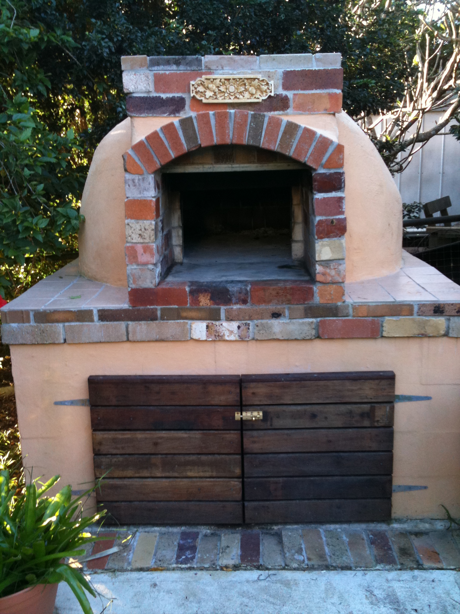

Progress to date on sealing this oven Great... and is successfull. Oven remins dry even though we have had a least one good shower of rain a week.
Arch complete so the hearth now has overhead cover from the rain and any drips from the edge fall outside the oven. The entrance is deaper than what you would normally find but I have a rectangle dome entrance and tending the oven is no problem. I do have the advantage of an extra large entrance which let you lite an ambient fire to sit in front of once the eatings over and just talk and watch the flames... priceless...
Brickwork has been cleaned down with vinegar and finally pressure sprayed to remove the last of the lime scum, Then it has been given 2 coats of "Bondall"
sealer to prevent the old bricks from soaking up any moisture. This has darkened the brick slightly not in a bad way...best way to put it ..inhanced the colour.
Yes I have thought of inclosing the whole oven at times ..but really I like the dome look. As long as you take measure such as sealing the dome render with a sealer and the entrance is covered you shouldn't have any problems.
The main difference is that I used old bricks which were not as water resistant as you would hope. The bondall sealer has solved that and I like the look that the mix of different colours and texture has given the oven. By the way some of the bricks in sections come from an old church and 1 I had for years as a door stop came from an old pub.
Regards Dave
