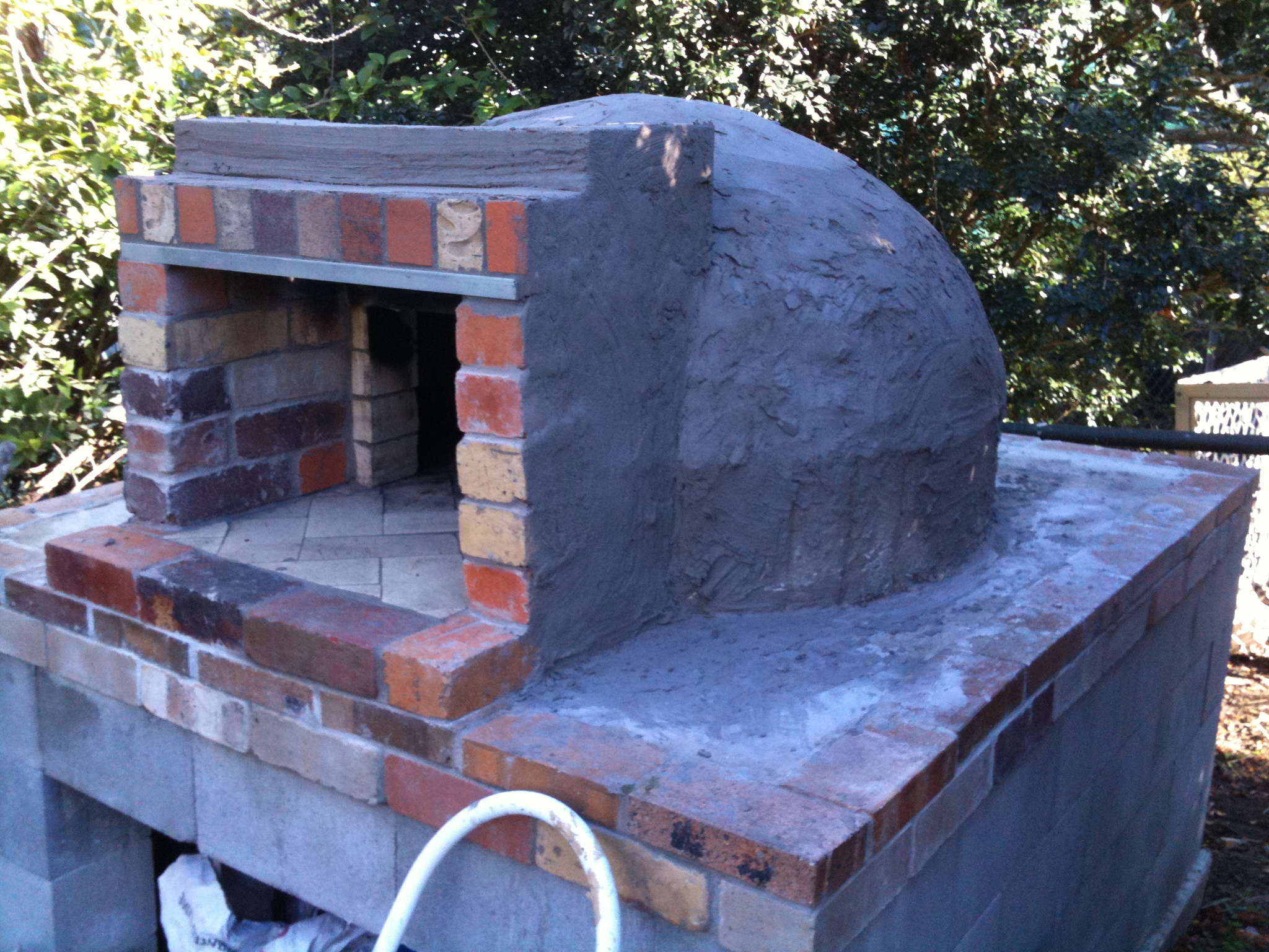

                  Better finish this off
                  Chimney since I change plans mid stream I was left sorta not knowning what I would do for a chimney. original plans were to have a stainless steel one but since I ended up with a large oblong opening I continued along these lines and have a wide low oblong "60" style ... cool. (I Hope). height to be determined by the height of the dome after insulation.
                  Insulation Bit. the bullet again and went Hi Tec again and got me some ceramic thermal insulation. Great stuff easy to work with went on like a charm and I ended up with 2''or 50mm over the dome bar the last 200mm whwere it only 1 inch. Next was to be a layer of perlite cement but this was to be a nightmare. the stuffs not able to be trowelled ended up building a cage to contain the blessed stuff. To top it off it rained no tarp no 2 son lent it to someone. A frantic race started to rip the cage off remove the pertite layer before it melted into the ceramic lot and finally cover the ceramic layer in a tape layer of plastic garbage bags. Bit of a mess to clear away Don't let my experience turn you of the pertite I just had bad luck. Did a bit of investication turns out rockwool insulation is formed at 1400 C that I had. A bag left in the roof, low on funds, what the heck a few inches of high tec insulation should protect from the highest heat. Added a coupla layers compressed it with the remains of the wire that was for the perlite recon the ceramic layer would handle the hottest heat of the brick dome. Works? seems to... months later the dome always remains cool to the touch.
Name:	rendered over insulation.jpg

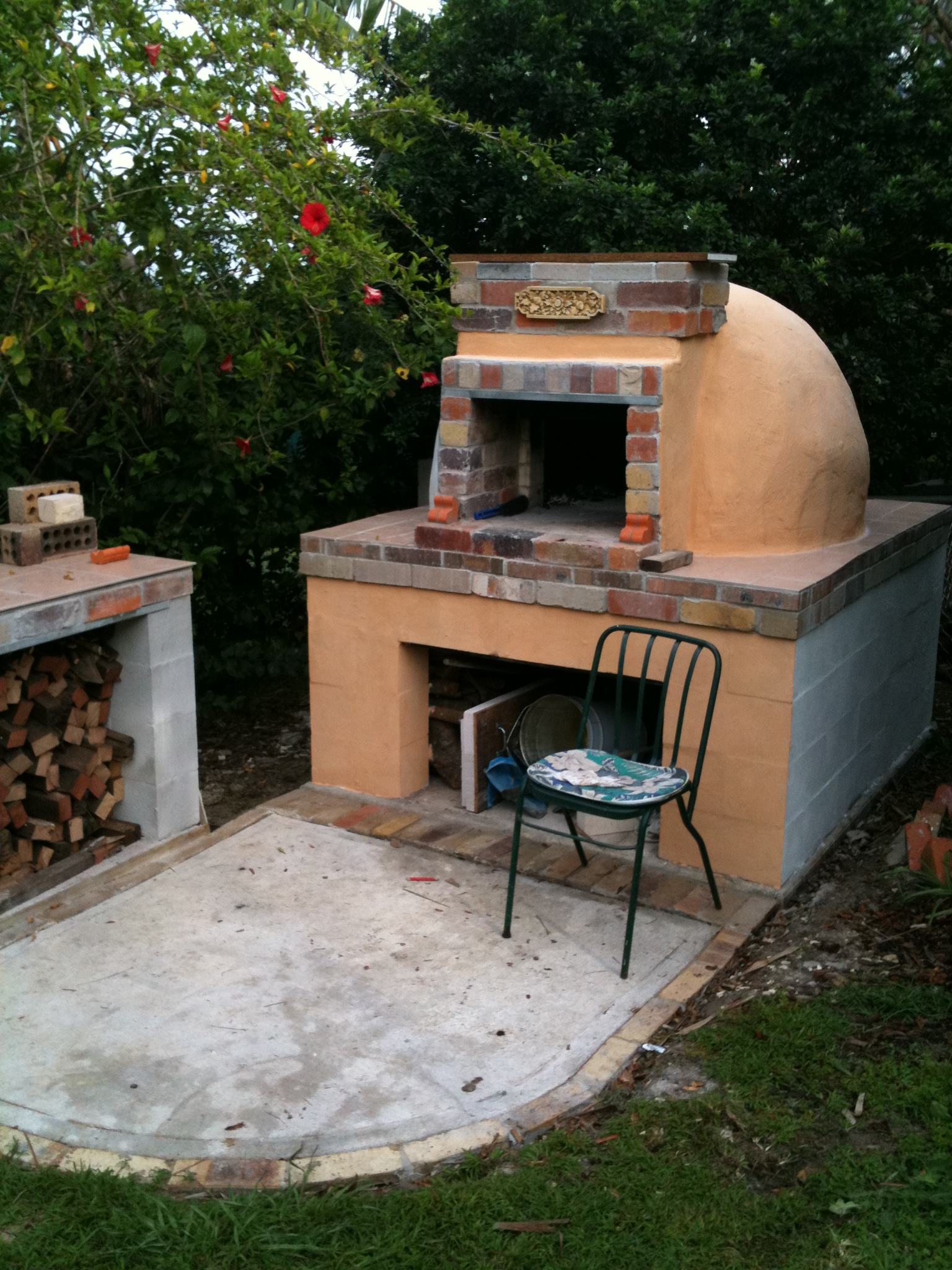

                    Re: cobblerdaves build
                    The pic shows the state of play today not all finished but a lot more added.
                    Rain was a major stubbling point spend ages with the dome soaking wet anable to use it as a small fire would make it steam so after it dryed out enough i sealed it. as you can see not all the works finished. But its getting there rain permitting.
                    Cooks well? YOU BET makes a great pizza and as I gain experience great for slow roasing as well. Well worth all the effort and still great fun Thanks Forno for the Plans Thanks all you guys and girls posting on the forum your a wealth of knowledge.
                    Regards ........DAVE

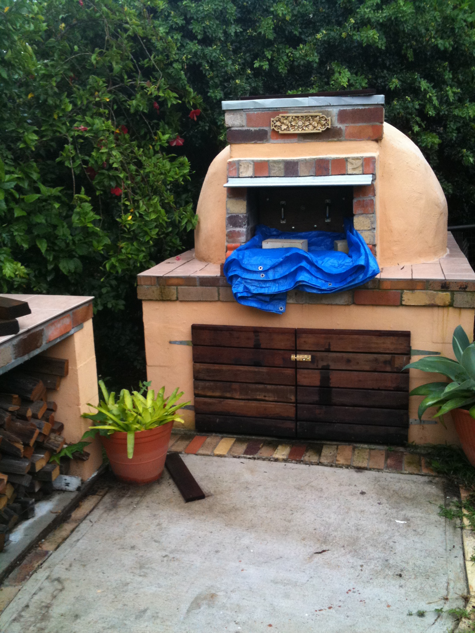

                      Hi all
                      state of play thus far still suffering from intermittent damp. As you can see from the photos the ugly piece of tin and the even uglier piece of blue tarp have solved the problem but a prettier more perminent solution must be found.
                      Problem stems from the hearth continuing to the edge of the slab and the entrance is 1/2 brick back. Any rain doesnt flow into the oven but is soaked up by the brick and of course is wicked in by the hearth insulatution.
                      I concidered cutting the brick back to the entrance level but its good to have one level right back into the oven. That left me with the option of rebuilding the entrance itself. Wow that would involve knocking down quite a lot a major job at this stage. And it would give me quite a tunnel to work the oven through. I decided ... Do noting rash... wait...Watch the forum and do something in the dry months of winter.
                      I finally came across few comments on a few thread on entrance depth and finally one with some measurement... great mine is'nt that bad so the plan is to build an extention to the entrance...Thanks Oscar... and its to be a arch
                      Regards Dave
