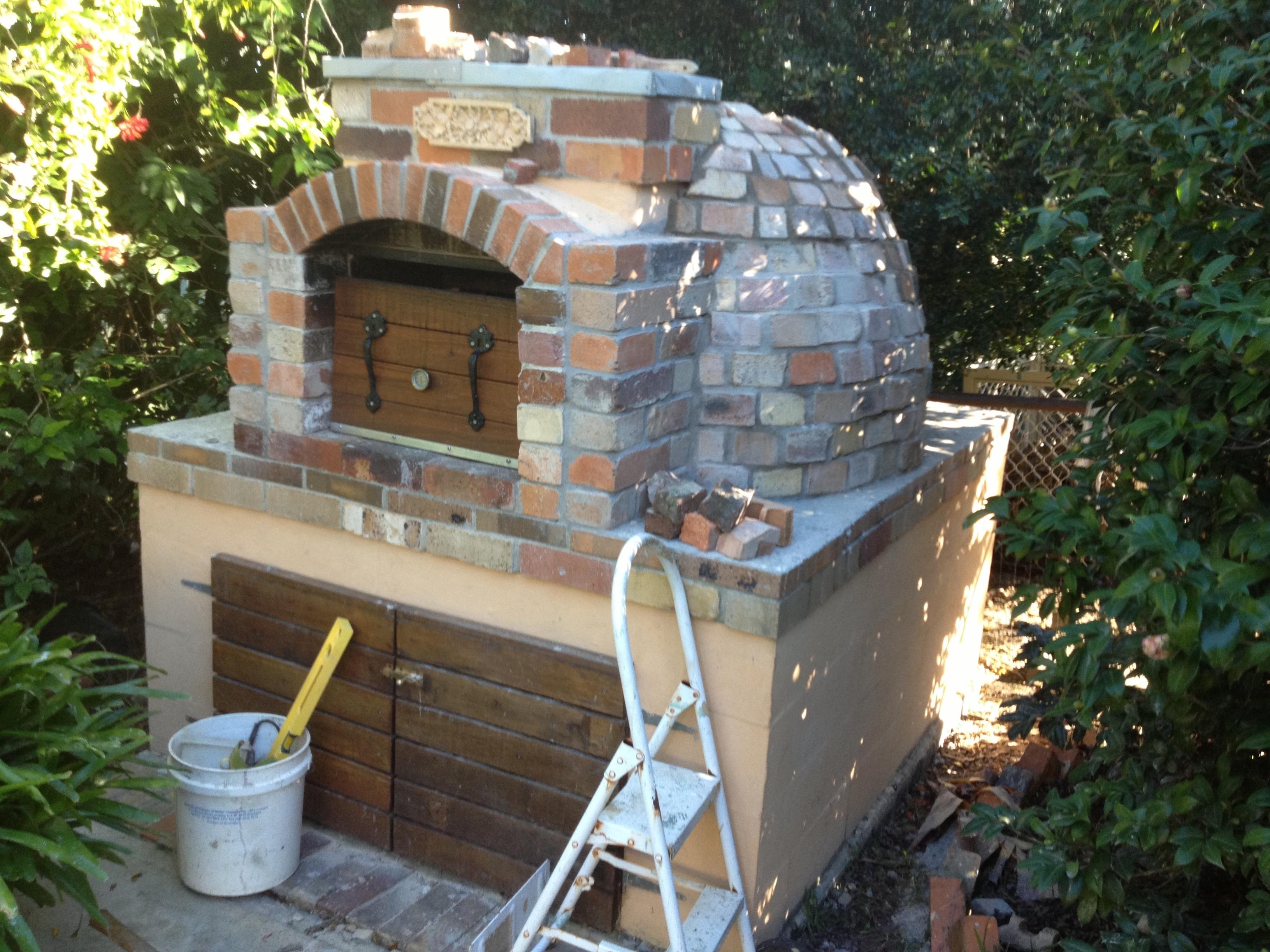

      HI Dave
      I was in Info Tech from 1980 - 2006 and hate anything Apple with a vengeance. It appears that Iphone [proprietry not open] doesn't rotate photos. . No matter I saved it and rotated it for you.
      I like that.... looks great Dave what color mortar will you use? I'd almost go with white cement/grout. Woops didn't see the buttress with grey mortar.

        Re: cobblerdaves build
        Dave, looks good. What are you using to set the brick veneer? Bruce

          #34
          CD,
          That brick veneers is going to look very nice, amazing how a flat brick can curve . I have been quite enjoying watch the Aussie and New Zealand builds and how creative you guys are with procurring materials and dealing with such high material cost.

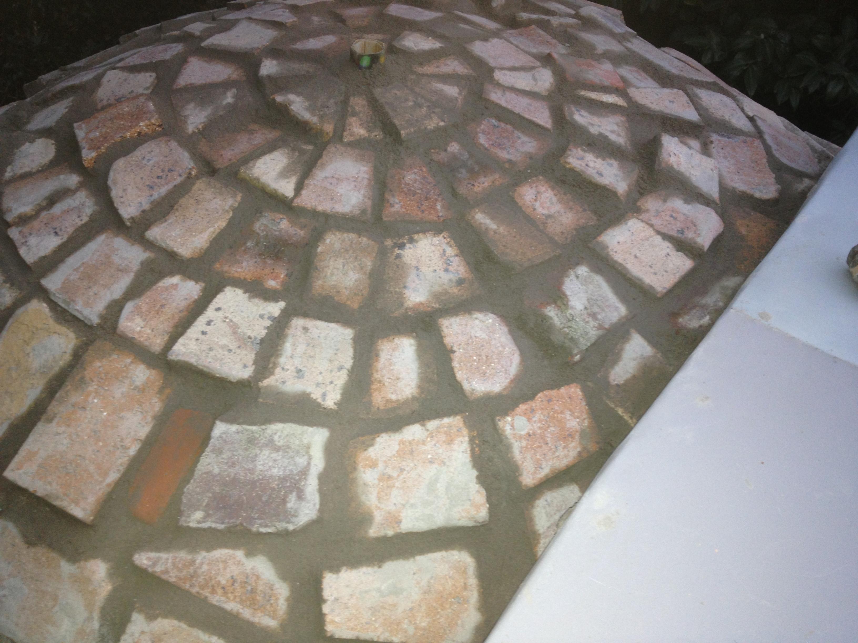

                          Gudday
                          A bit more progress I'm getting to like the effect more and more. I'm getting to the top of the dome now and the tighter circle has me using alternate 1/2 and 1/4s . Going to have to start cutting some angles on the brick though those gapes are getting bigger. Was a bit worried that the vent plug would not end up in the middle but whichever luck or good management it seem to be true enough. I cannot remember how I actually centred it when I fitted it.
                            Looks great! Dave'
                            This might help some. I stayed with halves as long as I could. I used a little "catch up" bat ever so often to help stay on bond. A young brick layer friend of mine laughed about this when he saw me use it on a straight run of a house. I was using different sized old brick. I told him that it will seem right to him when he started thinking of old brick, not as brick, but as stone .
                            But if you look just above and to the left you'll see where I quit worrying about the bond .
                            You are right about tapering the top courses. There doesn't seem to be much way around it.
                              #44
                              Gudday
                              Bricks layed Yes! Really happy with the result but did I boost that everything was straight and going to meet in the middle Da!
                              Check out just left of middle at the bottom .... See the wedge piece the dome wasn't perfect and I have to fill this in to get back to level. I know its there but I don't have many 7 ft tall guests so Hopefully I'm off the hook?
                              As for having the mortar joints not lining up .... Today I just wanted it finished so I just let them fall where they did . One thing I did notice I'm bloody sore I forgot what it was like hoping up and down that ladder for two days the back of my legs and my butt hurts.
                              Well not quite finish .... Three years or so and still counting.. Let that mortar set . Scrub with vinegar and remove the lime scale ... Seal with brick seal , tile.
                              Bugger ! Still cooks regardless

                                #45
                                Congratulations! Dave, You now have a brick oven .
                                That same teardrop formed on mine high and next to the chimney. You are right about it being hard to see. And if they do see it, they will think it was meant to be there. I know you are glad to have that done. I like most all oven finishes, but I am partial to brick. It looks great!
