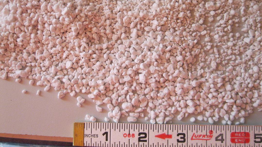

No, it was Horticultural grade. It barely had any dust at all..I was expecting more. Lots of small particles, but all intact for the most part. I'll open a bag up tomorrow and get a pic.Last edited by stonecutter; 03-14-2013, 06:00 AM.

Did you use block fill perlite? The one we have is already pretty fine, 1/4" or less with a lot of dust (as a gradation, not a condition).

I didn't find it very dusty at all, but then everything I do generates dust so my view point is probably different. I can see potential for dust if a lot of particles are ground down..the bags I had didn't have much crushed material in it.

It works, but it generates too much dust.

Actually, I thought it worked well. I liked how you can tell if the particles were coated, as opposed to vermiculite..a little harder to see. I like the idea of creating a 'slip' with the portland and water though...I'll try it next.Originally posted by Tscarborough View PostYeah, dry mix definitely doesn't work with perlcrete.
