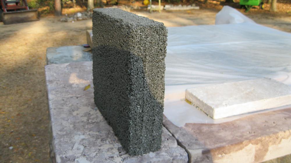

Re: My Wood fired Redux
I had a little extra material so I made this little panel to see how it would hold up. Out of the four ovens built, only one has a block surround...the rest have a wood framed enclosure. After insulating, I encase the oven with durock as an extra precaution...9 years and no issues with the 3 ovens. So I got to thinking about making my own panels out of perlcrete. This sample was compacted in lifts, so it is pretty solid. I don't care about insulation r-value too much, since it is not the primary insulation on the oven. The next sample will be around 1 1/2" thick...this one is 2.75". I'm not sure what I will settle on dimensionally just yet...probably something like 1.5' x 2'. I am going to add a polymer to the water to help bind the perlite particles a little more, and go richer on the mix...something like 3 or 4 :1
I did a 6:1 with 1.6 on the water. Take this for what it's worth..... When I portioned out the perlite, I used 1 gallon as my unit of measure. After filling the first portion of perlite, it was dumped into the wheelbarrow. Then I took the measured Portland cement and put about a third of it over the perlite. Repeat for the next two buckets of perlite. Then I was able to gently fold and mix the dry material without breaking up the pieces into fine particles.
