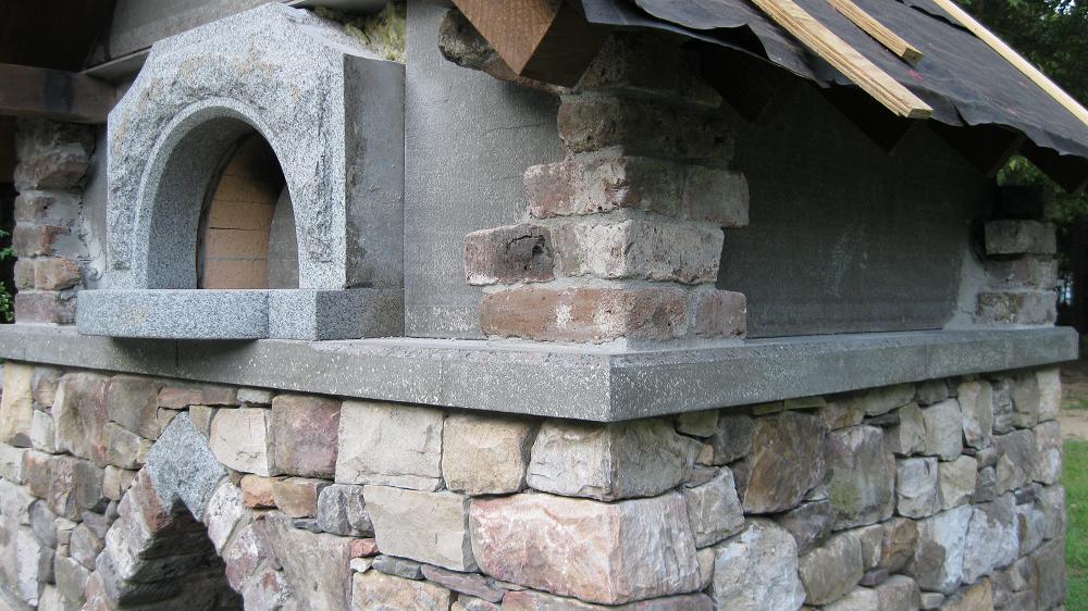

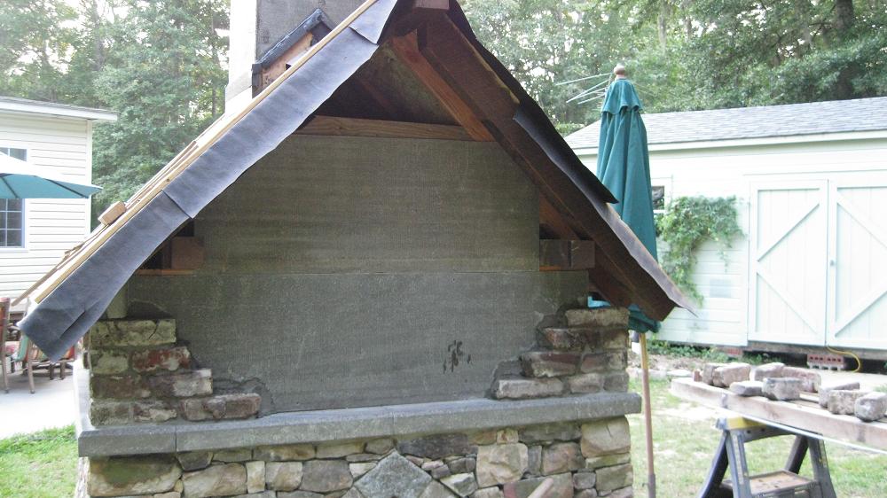

I am going to try and let the stonework go. I don't want it to look like the base, less coursing and more random..in and out. I'll run some brick out on the sides, similar to the back of the oven, asymmetrically, again to give the feeling of repair work.
2 Photos

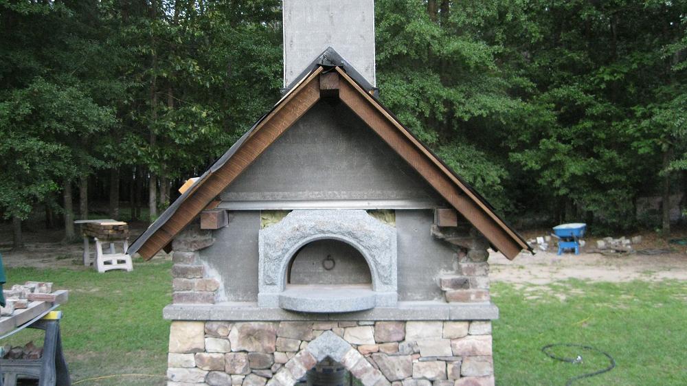

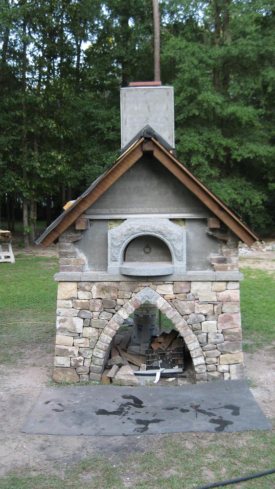

More finishes evolution...this time it was incorporating the few remaining antique brick into the veneer work. So, they were laid as corners, with no real bond pattern, because I am going to key the stonework into them...the idea is to make it sort of like an old repair or something. I just don't have enough to do anything else, and with an extremely limited stone supply, this seemed like a good solution.
2 Photos
