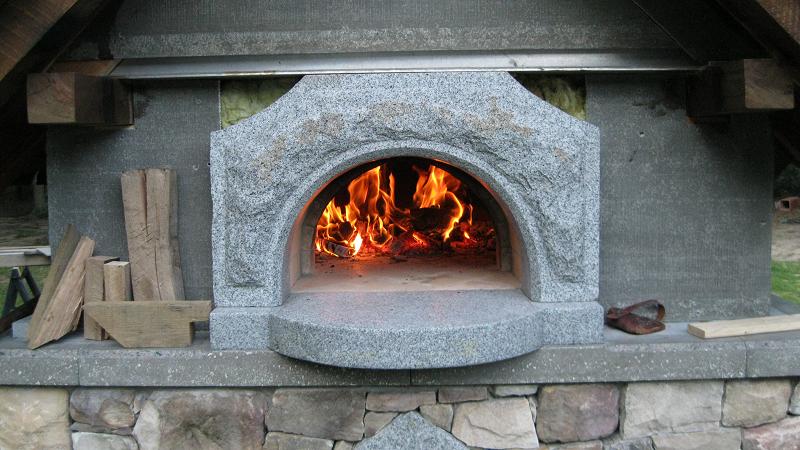

Overall, I'm very happy with how the oven is working. The draw is excellent in spite of facing the prevailing wind....had no choice on that.
The gable on the back of the oven is open on top, I checked the interior temp when we were coming inside for the night....nothing more than ambient.
Granite arch didn't get very hot at all, and I think we're in business!

The oven is insulated with 4"-6" of mineral wool....now that the enclosure is dried in I don't have to worry about rain water.
I finished the roof framing, got the plywood and paper on. Now I need to run the flue through the roof so I can install and flash the chimney. Probably going to be a brick veneer because of weight. After that, cedar shakes go on. I think the brick and the cedar will compliment each other, plus I wanted to get more brick in the design to work with the vault.
Got all the durock sheathing installed except an upper potion of the back gable, and all the wood trim is stained/sealed. I'll start picking away at the stone veneer as time allows. I'm doing more granite work above the arch so that will take a little more time too.
