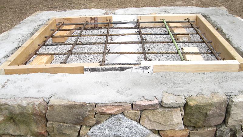

Slab done on Sunday. Going to have a couple things going at once...casting pieces for capping the base, insulating slab, cutting brick and carving some stone.
Some shots of the slab. Drain channel is filled with broken stone and crushed stone to level it out.

Thanks. It definitely would have been faster to just do a veneer over block but the base is dry except for the top course, which I turned into a bond beam.Originally posted by Stonewall View PostWhat size oven will it be? What u thinking over the dome?
Oven size will probably be between 30"-33"..not sure yet. Over the dome..well, the only thing I know is that it will resemble a small stone house. Design-wise, I'm kind of letting it develop organically because I am using mostly material I have hanging around.Last edited by stonecutter; 03-05-2013, 07:09 AM.

Yeah...that would be a move fresh off the turnip truck.Originally posted by david s View PostConcrete I hope. Heavy rebar in a vermicrete slab won't do much.Last edited by stonecutter; 07-24-2013, 06:51 PM.
Leave a comment:
Re: My Wood fired Redux
It's for a concrete slab...I've got some stonework planned and need the support. Vermiculite will go on top of the slab in the oven footprint per usual application.Originally posted by Tscarborough View PostI am cornfused. Are you pouring a concrete slab there or a perlcrete slab?
