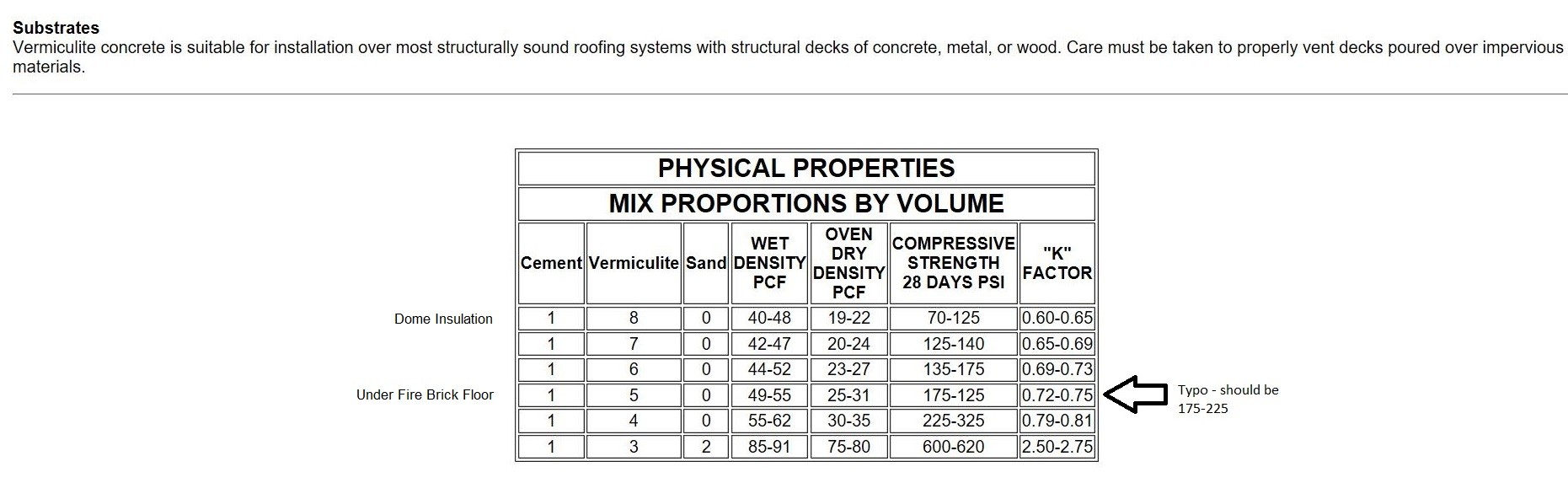

                I plan to do obviously some pizza and yes cook some roasts the next day, maybe some bread. I think I am going to notch the bottom row of bricks at about 45 degrees towards the end of the dome and fill with a perlite fill mix, I’m guessing it might get me 50% of the loss back? I've done far riskier things at work and got away with it. I’ll do 4 bricks at a time and fill underneath as I am going.
                  If you do this, the best ratio is 5 to 1, any leaner does not give you the structural support, any thing less does not give you the insulation values. BTW, very nice joint work on the arch. Click image for larger version
Name:	Vcrete K values.JPG

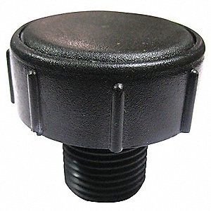

                              Before you place the final nonpcrete render be sure let it dry well and begin the cure process. Also suggest leaving a blockout that extends down to the ceramic blanket at the apex of the dome. You can use what you folks call a breather valve. This allows any water that gets in or is in the dome area vent out. When liquid water converts to steam, the volume increases by a factor of 1500. A vent allow the pressure to release without building up under the dome and cracking the pcrete or final render. Attached is a pic of what we use in the States but you have similar versions in the UK available at any auto parts store Eday UK for relatively cheap. Some builders in the UK doing cast builds found some on I think Ebay UK.
