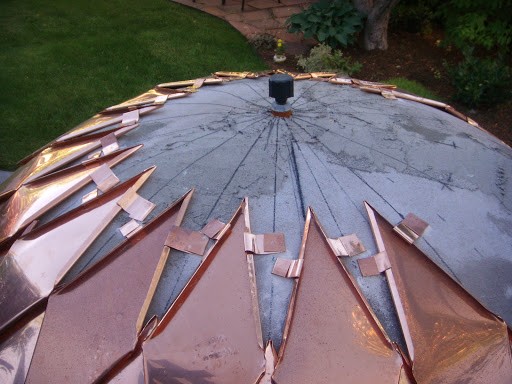

    Before you place the final nonpcrete render be sure let it dry well and begin the cure process. Also suggest leaving a blockout that extends down to the ceramic blanket at the apex of the dome. You can use what you folks call a breather valve. This allows any water that gets in or is in the dome area vent out. When liquid water converts to steam, the volume increases by a factor of 1500. A vent allow the pressure to release without building up under the dome and cracking the pcrete or final render. Attached is a pic of what we use in the States but you have similar versions in the UK available at any auto parts store Eday UK for relatively cheap. Some builders in the UK doing cast builds found some on I think Ebay UK.

      The vent on my oven I leave in since my dome is exposed and not under cover. This ensure any water that gets in and coverts to steam gets out. Click image for larger version

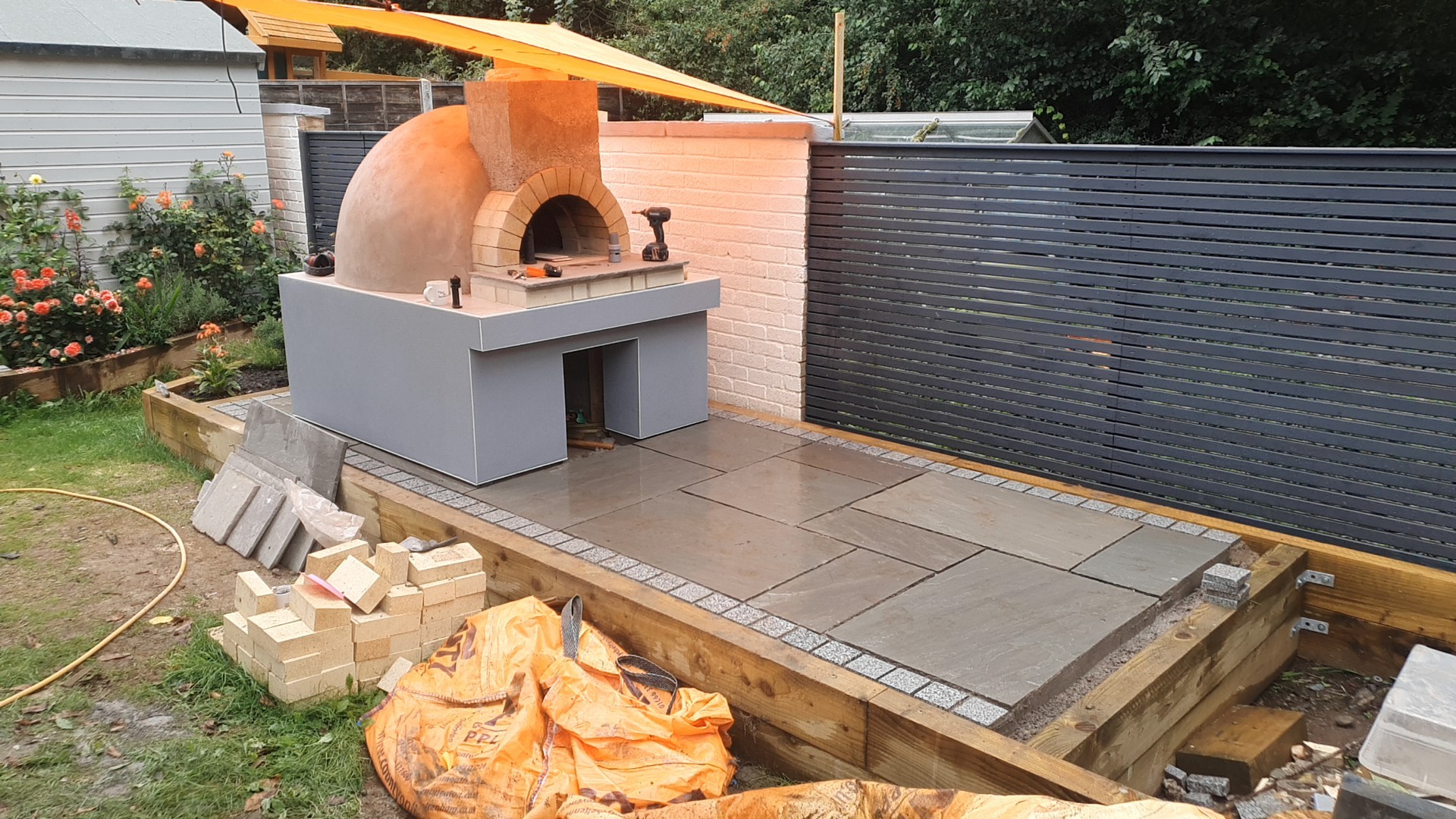

                            #28
                            Little update picture.
                            Leaving the tiling for another week and one curing fire left. Just to make sure everything is dry set and i am happy before the final bit.
                            Starting to look pretty good now. I will be raising the garden next year to the same level as the sleepers.

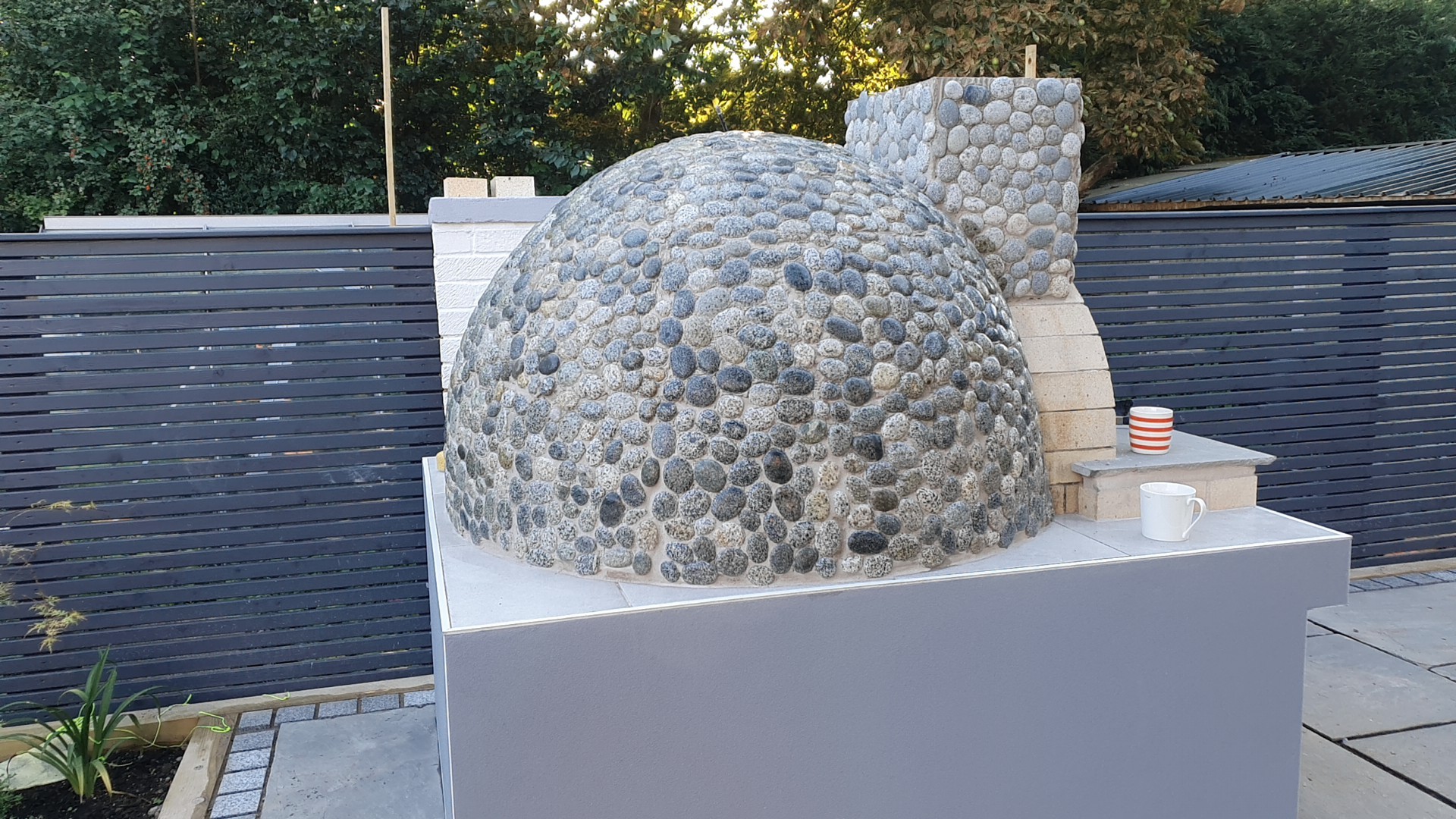

                              #29
                              Stone pebble tiles are done. Grouting left, sealing and that chimney finish?! Still a bit unsure what to do. Dont laught but i actually install ductwork systems for a living, installing flues chimneys and pipework. I will probably end up having a square to round transition with a 125mm round x 500mm long flue with a china mans hat on the top and probably enamled made at some point
