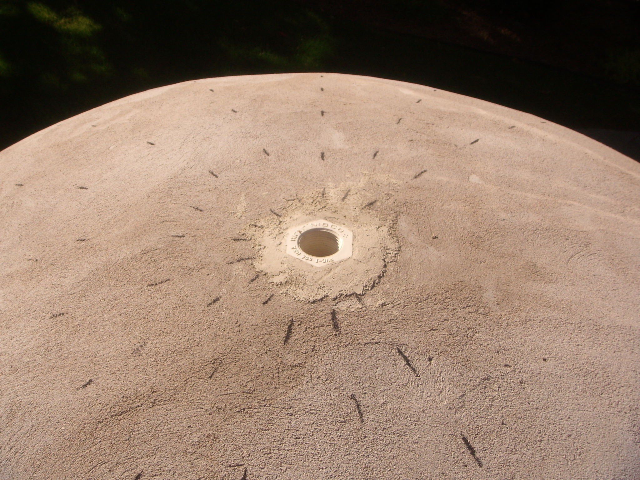

      where are we getting the pressure cap that goes at the top of the render and does anyone have a forum or photos they can show of how they went about putting in the pressure cap?
      I got mine from Amazon but some guys say they are available in auto parts stores. Look at my build. I did something similar to what others had done.

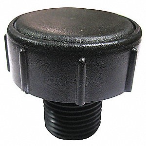

        Any auto store will carry this (see picture) and cheap (IE Grainger Less than $10). embed a 1/2" fnpt pvc bushing in the stucco with a wire mesh for extra strength(see Gulf's build) Click image for larger version  Name:	breather vent.jpg Views:	0 Size:	25.9 KB ID:	454579

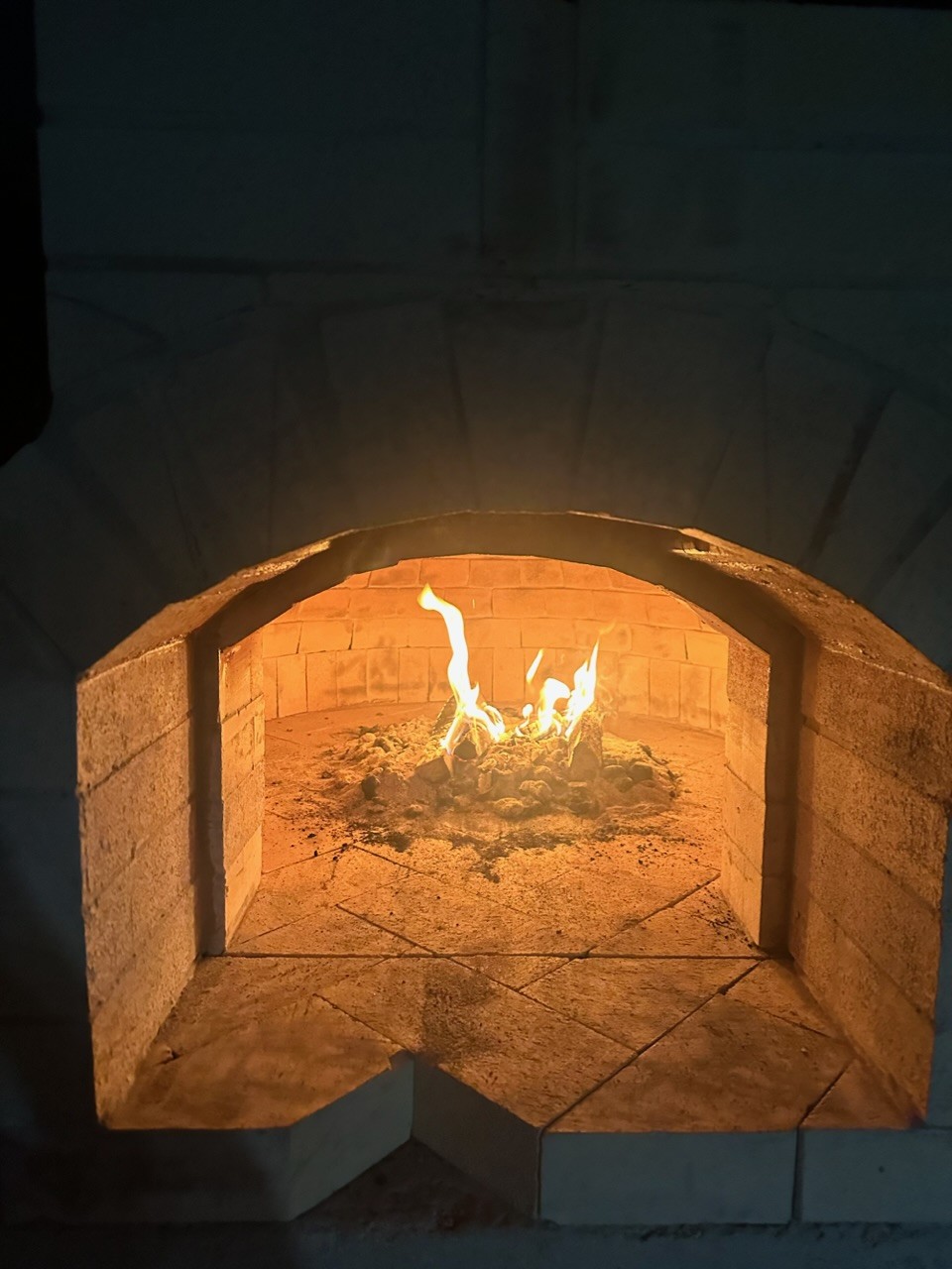

                      Alrighty we are back!!
                      we had a successful week of curing fires!

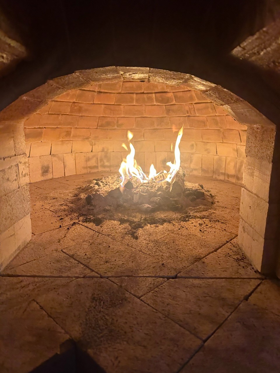

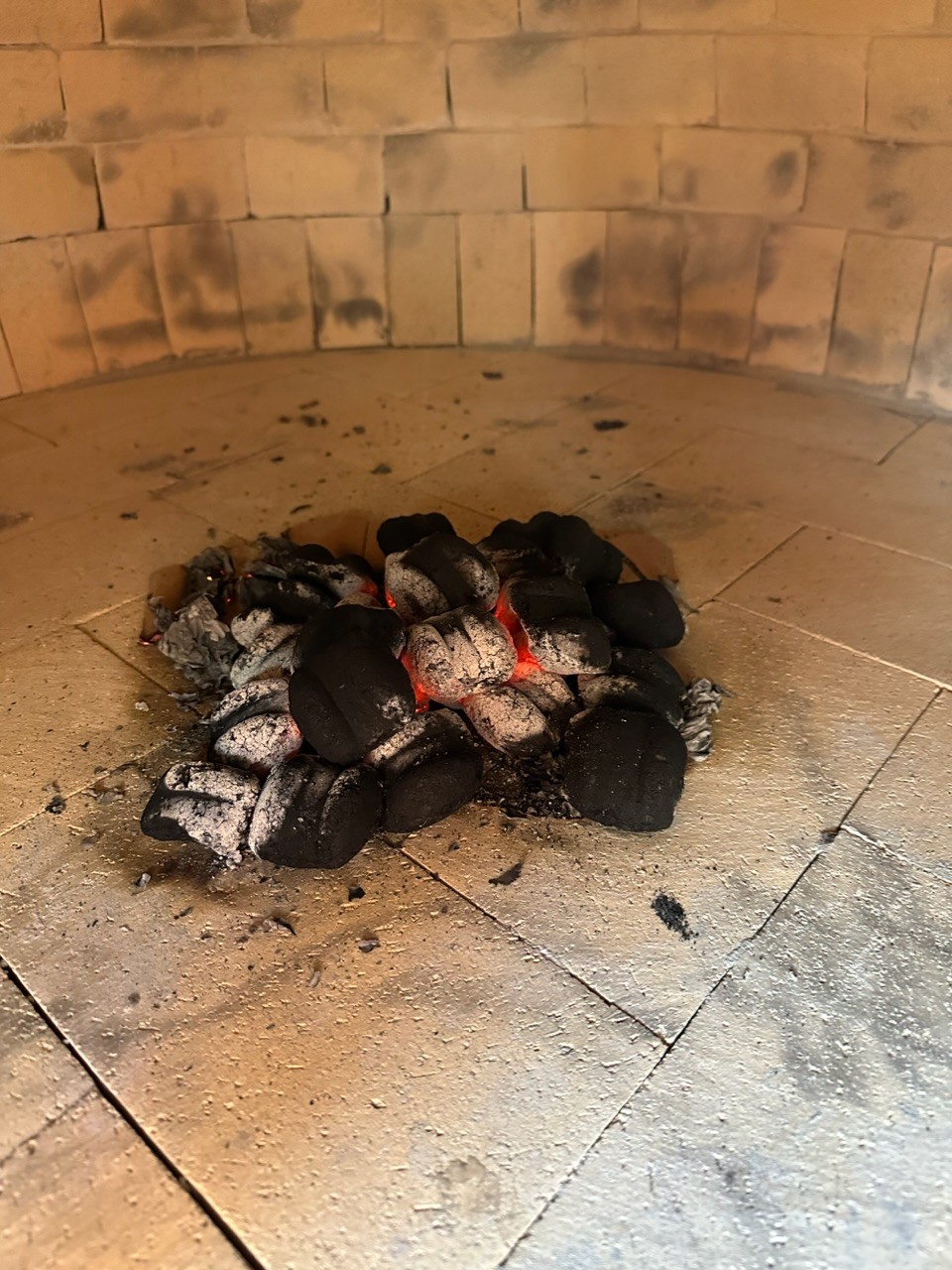

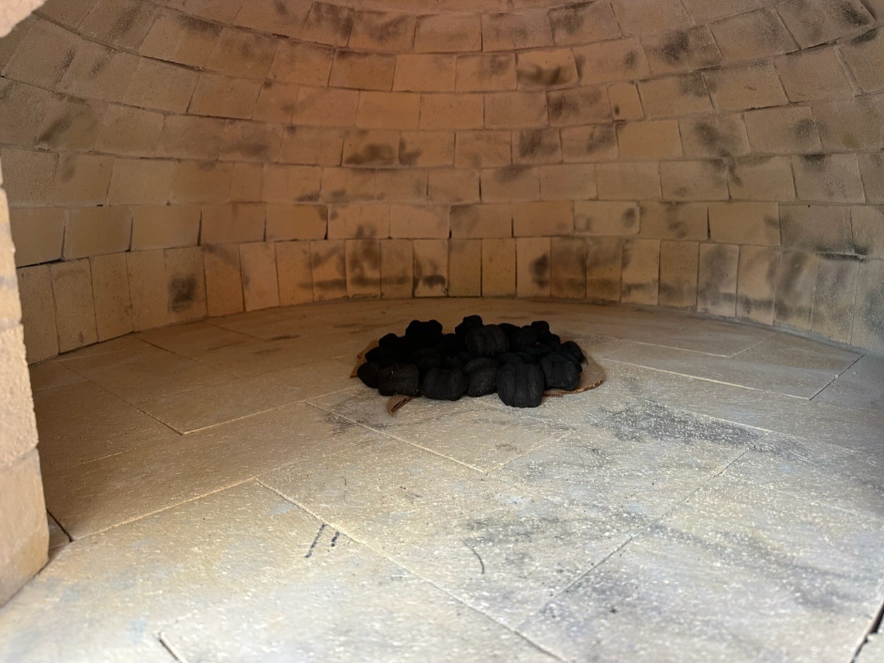

                      we began Sunday evening with a charcoal bed that I slowly grew throughout the night keeping the whole dome in the low 200s for about 6 hours then in the final two I did bring it up slightly with two small chunks of wood
                      following day we did a small fire keeping it in the high 2s mid to low 3s
                      (obviously the top of the dome was always going to be hotter then the rest )
                      I did my best during the week to take readings from every course and make sure they were all brought up uniformly
                      example: if day 2 fire the top was at 280 then on day 3 the top would be between 350-380 day 4 430-480 etc
                      I don’t see a lot of info on the amount of charcoal so I started small and slowly built it up watching the temperatures by end of the 8 hours I had used an entire 15lb bag of briquettes and let them continue to burn down for remainder of night after the final bit of wood I tossed on burned off

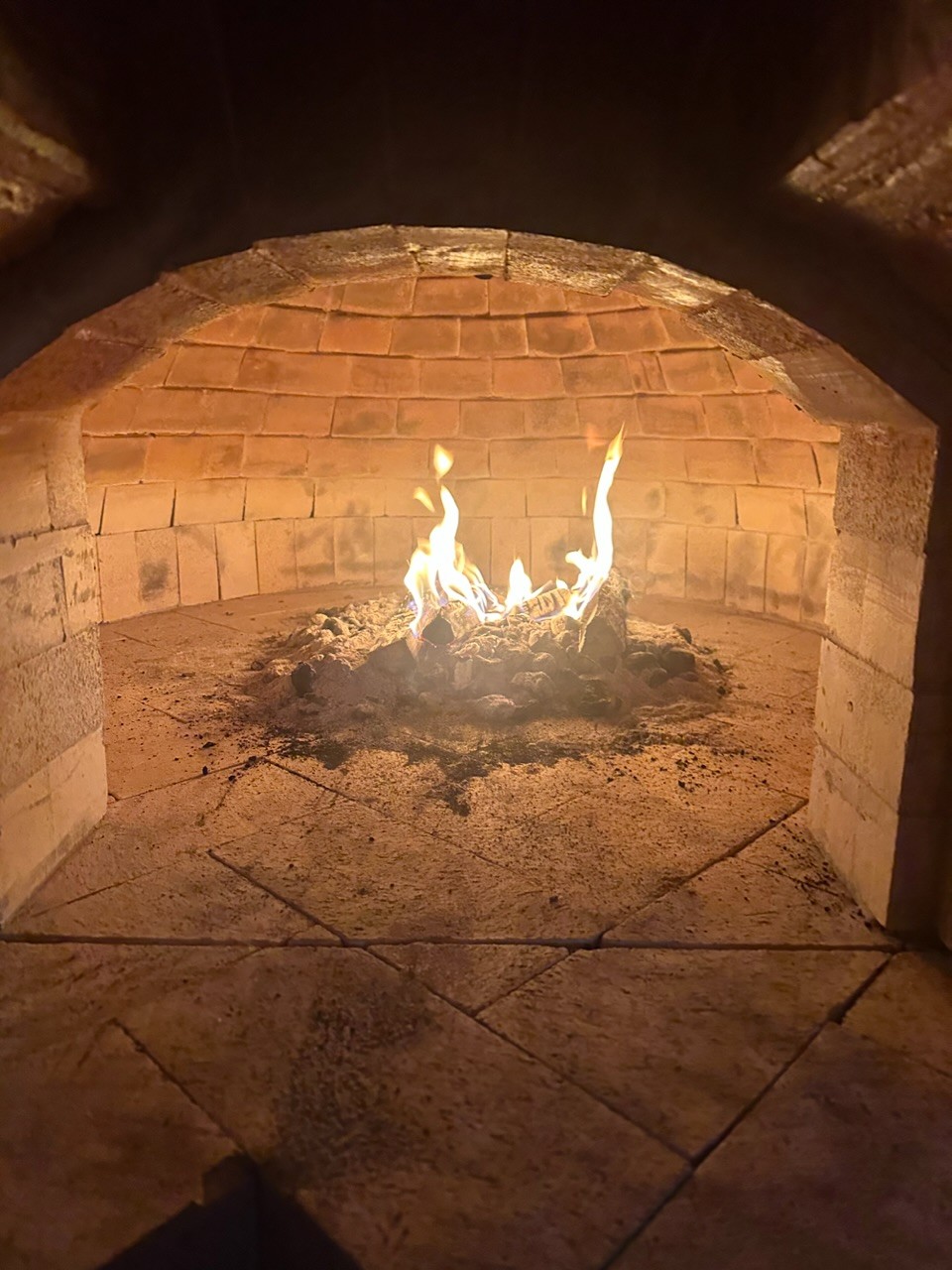

                        #71

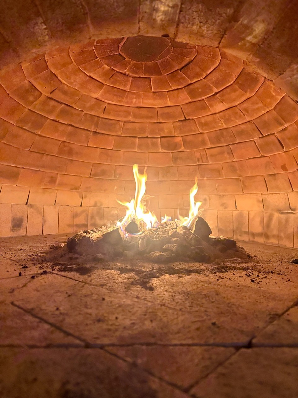

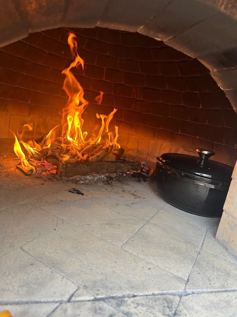

                        Day 2 went well with a smaller fire pit of wood I worked to build up a fire slowly bringing it all up to the desired temp and then spreading out the footprint of the fire so it was closer to the sides of the dome in order for the lower brick to soak up as much heat as required for the days cure
                        not sure if it’s talked about but for the curing fires I opted to go the bring it up slow and hold method and hold the fires at heat for extended durations of time seemed to worked really well for me

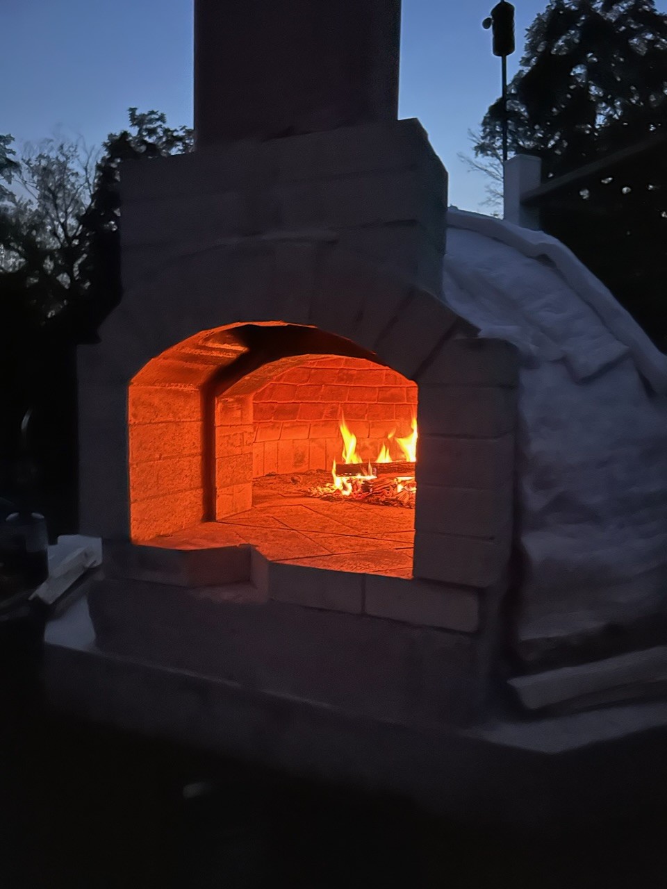

                        must say it was awesome watching the chimney perform as well as it did even with the lower heat smokier fires or even when I’d have to close out the fire cause it spiked too high the chimney would suck all the smoke up and out with little to no escaping
                        really the only times smoke would come out of the archway would be from wind blowing into the archway from across the property

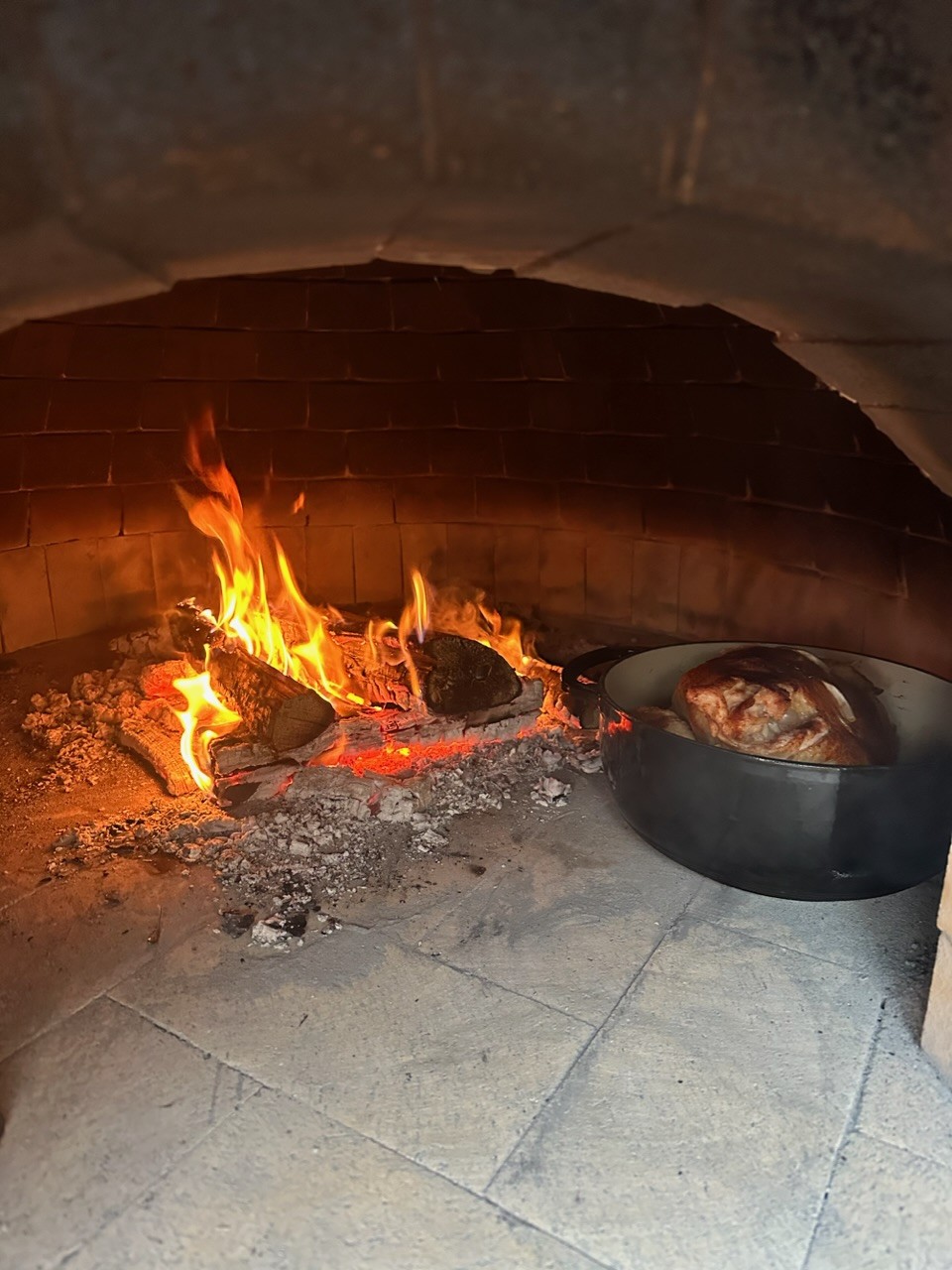

                            #73

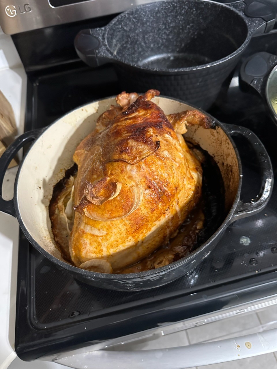

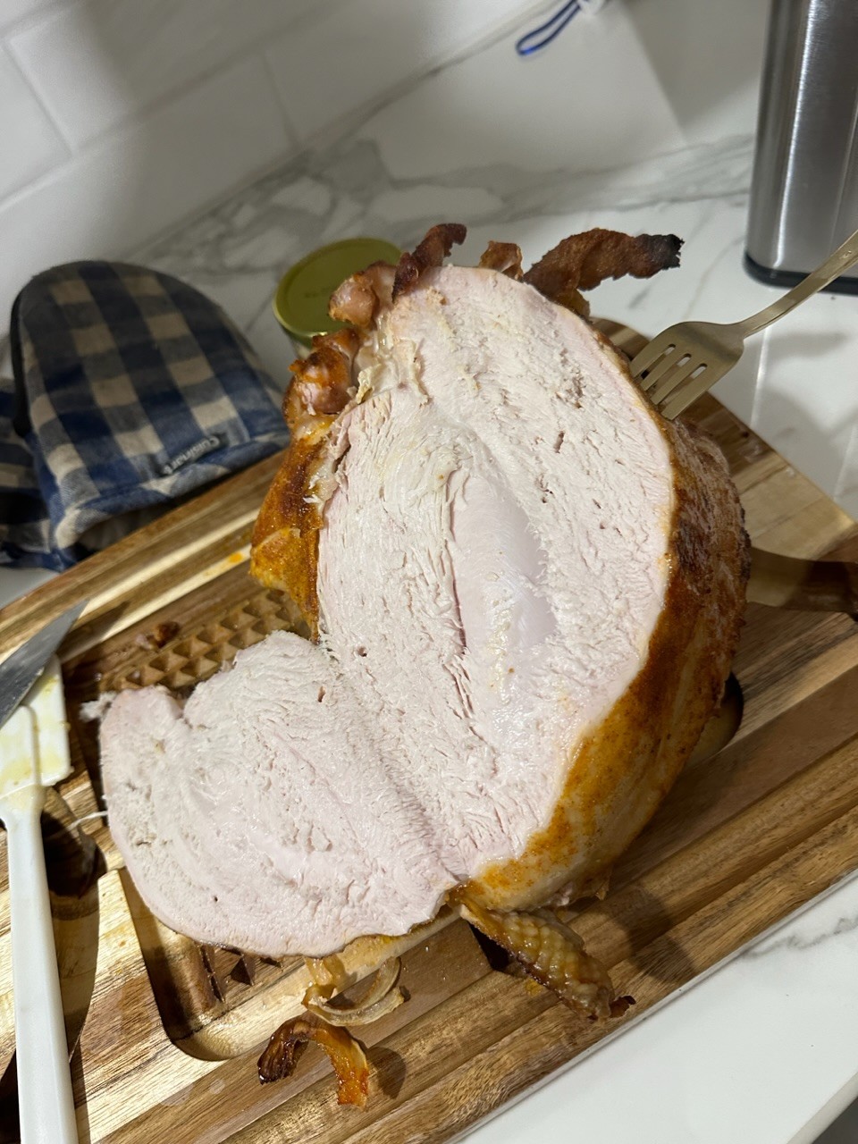

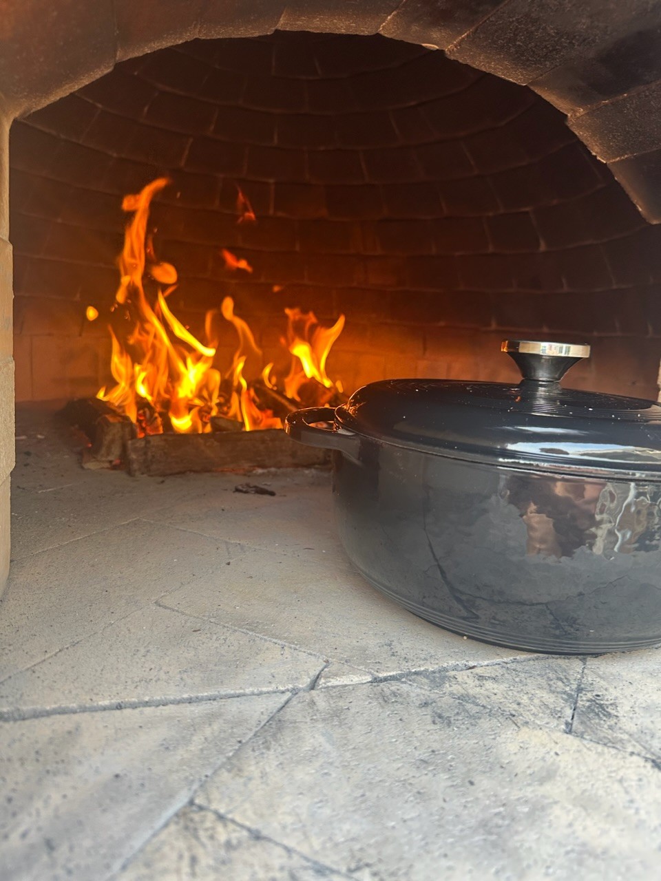

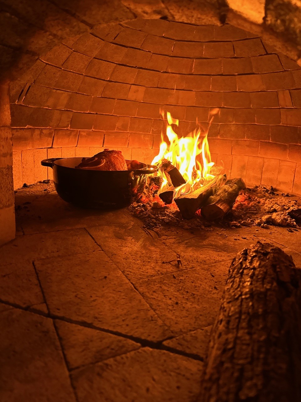

                            Day 3 went well bringing it into the 400s i opted to roast our first meal in it and we cooked up a nice turkey breast
                            it came out amazing looking forward to doing more roasts in the future
