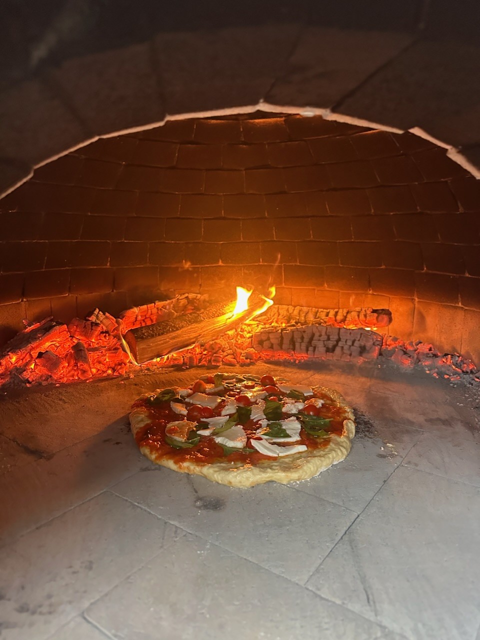

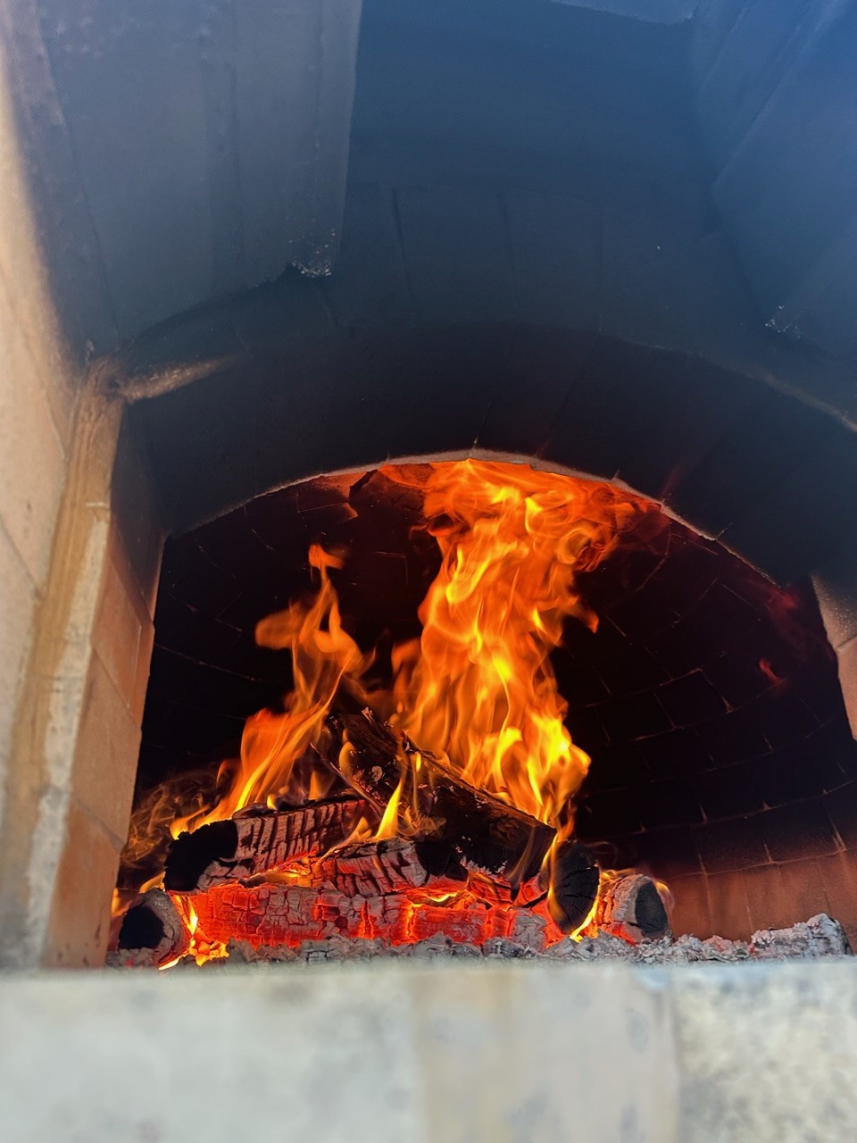

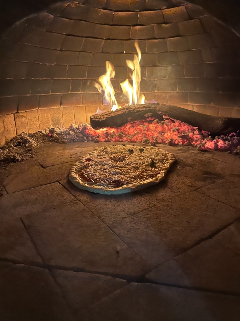

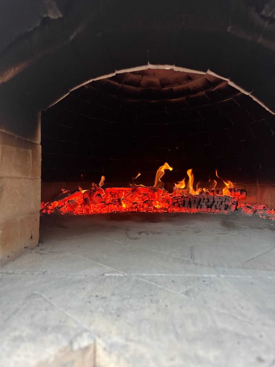

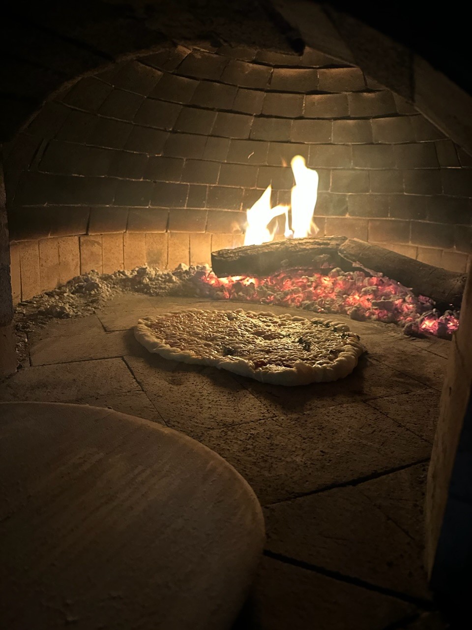

    And so that brings us up to last night which was Day 5 and our final during fire which would bring us up to pizza cooking temperatures
    i knew I had to let the dome clear to know I hit temps that seems to be the consensus form reading through other forums that you reached a full cure if and when it clears
    and we’ll into an hour of letting a fire build we began to see the roof of the dome clear the fire was burning hott
    we were seeing mid 5s at the very bottom to around 800 + at the very top
    and well it finally happened …….
    WE MADE PIZZA!!!!
    I cooked up some amazing garlic marinara sauce whipped up a couple batches of dough and we made our very first pizzas and boy did they cook quick !
    the oven worked tremendously and more on the smokeless aspect the oven was performing so well all you saw coming from the chimney was the heat waves this oven was on top of its game!
    We made two margharitas pies and one traditional plain
    just had some left overs writing this and I’m sad I cannot make more pizza tonight since I will be doing the shell this afternoon and letting it sit for another week before firing again
    idk if you will see in any of the photos but I wrapped my chimney in the towel I used as a pad for the tarp over it
    it worked well for a temporary “insulation”
    until I build the really chimney surround I am going to temporarily build a box to go around the chimeney and either use left over blanket insulation or fill with left over vermiculite until the new chimney surround is built prolly in a month or so

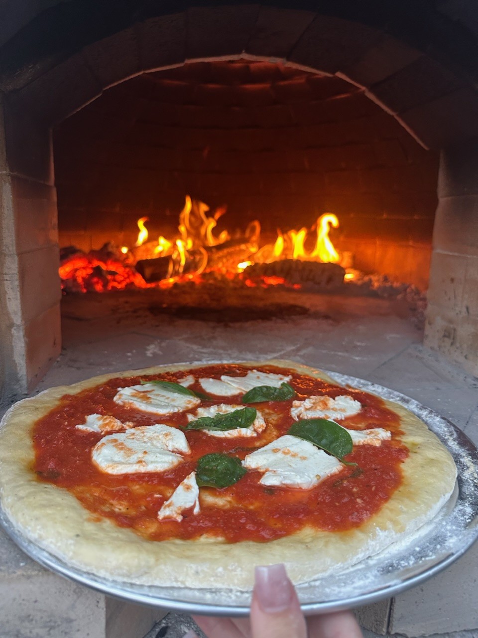

      #77

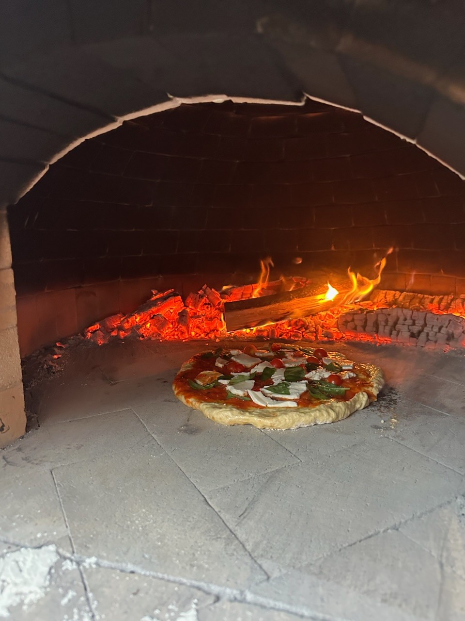

      More pizza photos

        Last photos of pizza

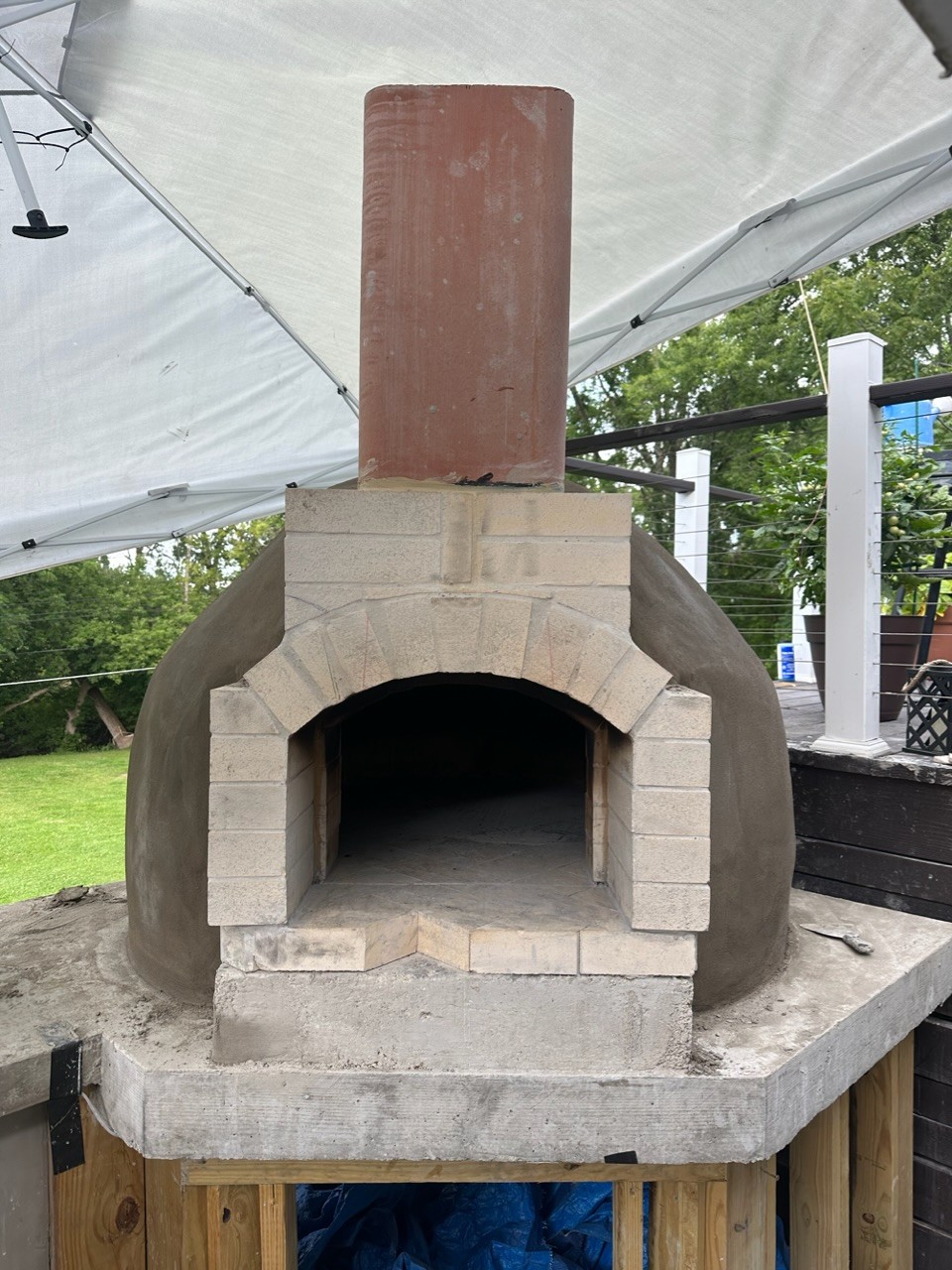

          So just wanted to go over what I used for my control joint
          since there wasn’t any caulk I was comfortable using that could withstand the temps my chimney may experience I opted to go with the rutland mortar although it hardens since I was doing such a thinn film of it mainly to encapsulate the rope gasket I assumed it would effect the thermal performance really
          looking back I probably could have went with rutlands 800degree silicone but didn’t want to take the chance of it failing and going onto my foot
          I used 3/4 gasket rope and stuffed it in and doubled it up where needed and laid it across the top to bridge to final gap between the clay flue and the mini wall I built off the dome
          I used the same mortar to secure the chimney flue onto the base worked great
          last night I took readings from either side of the control join and was getting temperature differences over 100 degrees so I will say the hardening caulk is doing good as far and insulating the two bricks
          and Again the chimney is performing amazing ! And no leaks I could find

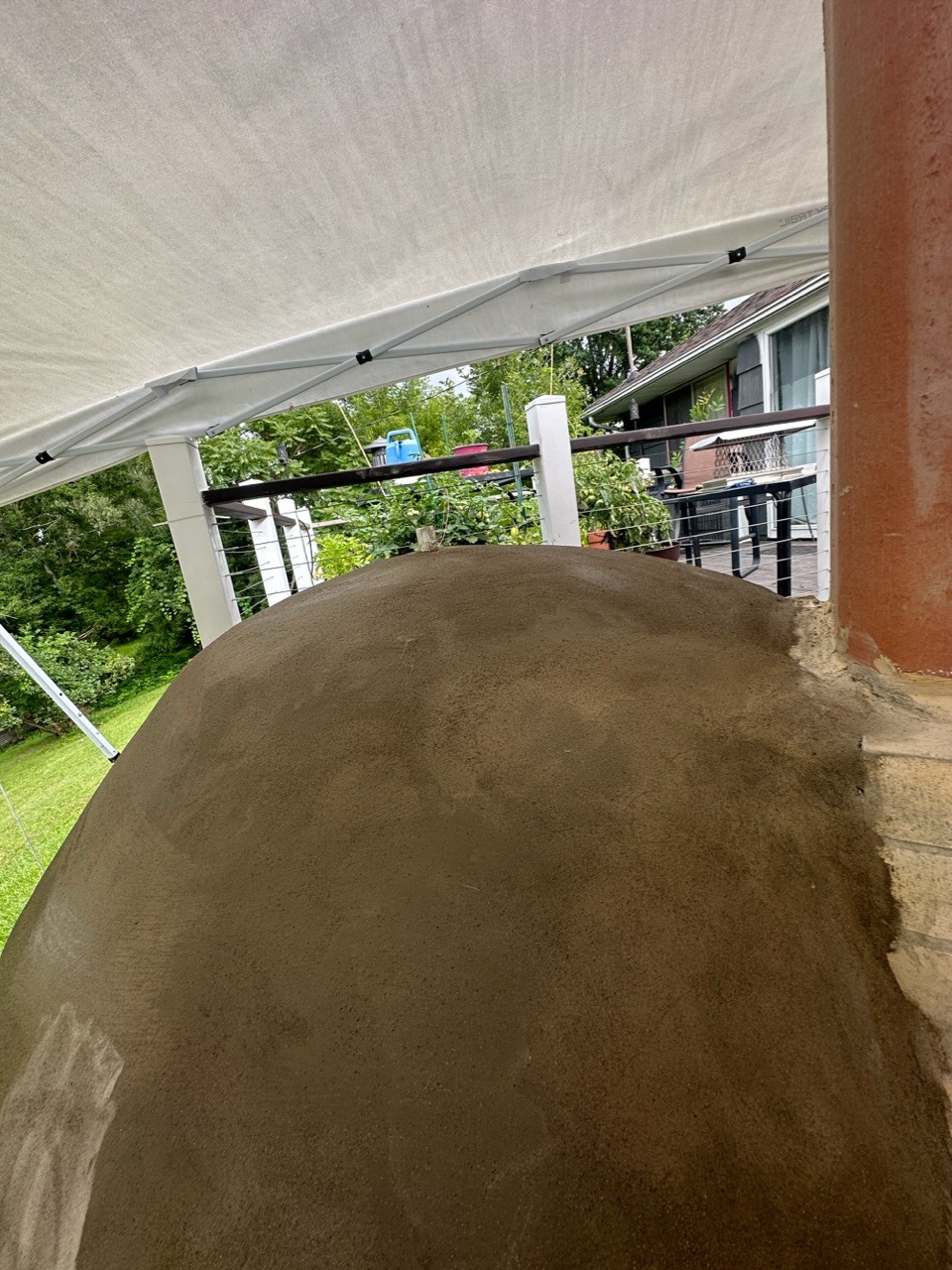

              And so that brings us to today where I will be finishing out the final layers of insulation and coating the outside with type S mortar I was originally thinking about adding additional V-Crete to it but due to space requirements it won’t work so I’m not gonna worry about it I’ve seen plenty of builds without it , I may add some to the future base of the chimney that’s going to be built but I’ll cross that bridge when I get to it
              for no time to don the long sleeves Jeans gloves and mask and step out of the A/C into the 90 degree weather and get this bad boy covered and prepped for it’s outer shell!

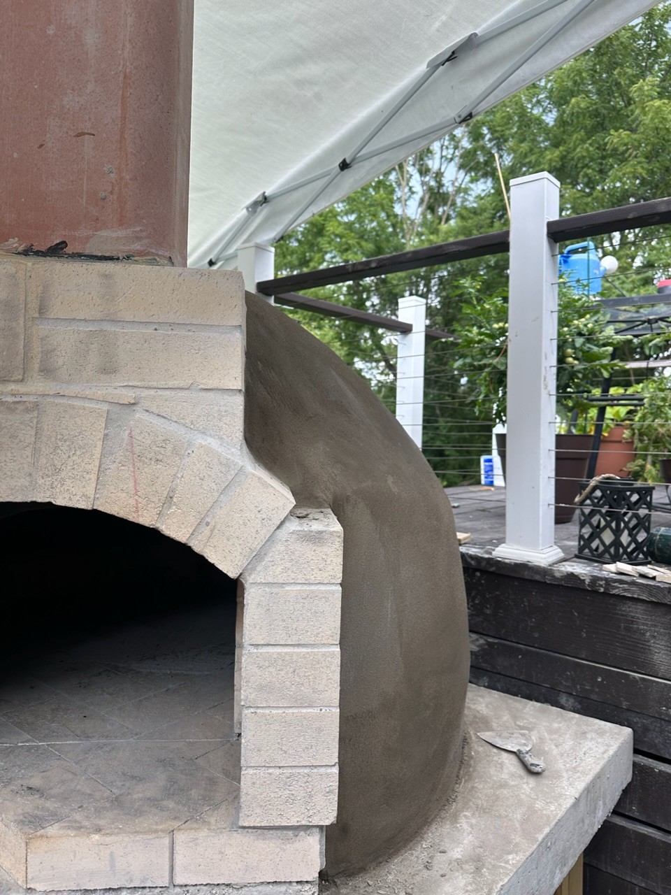

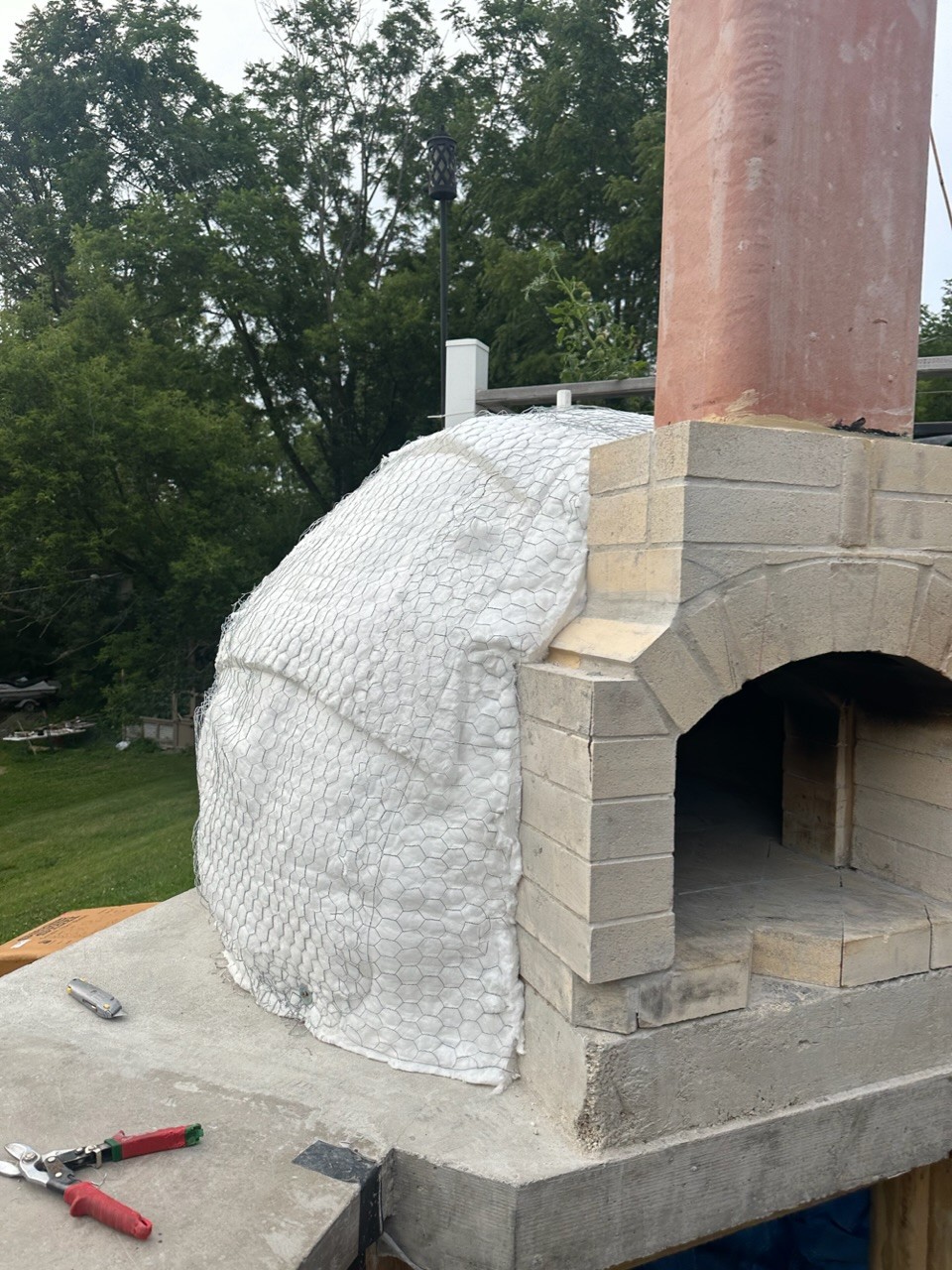

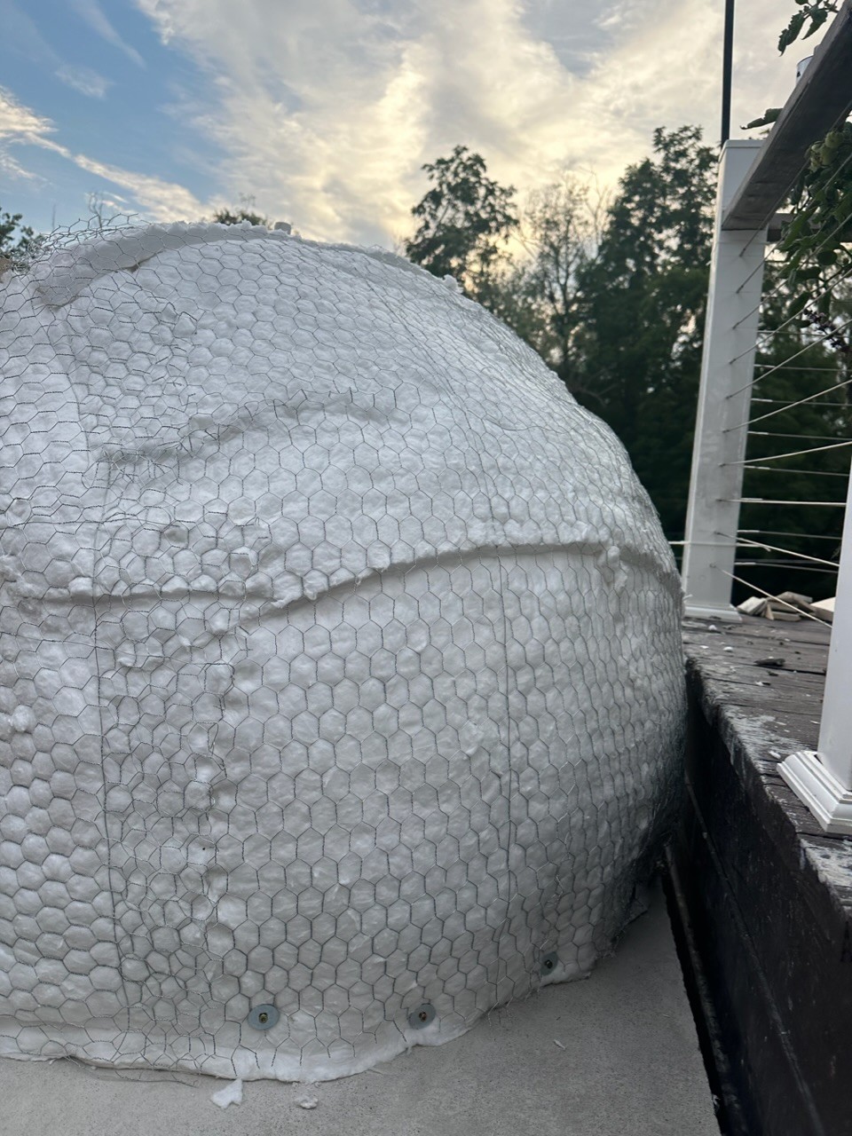

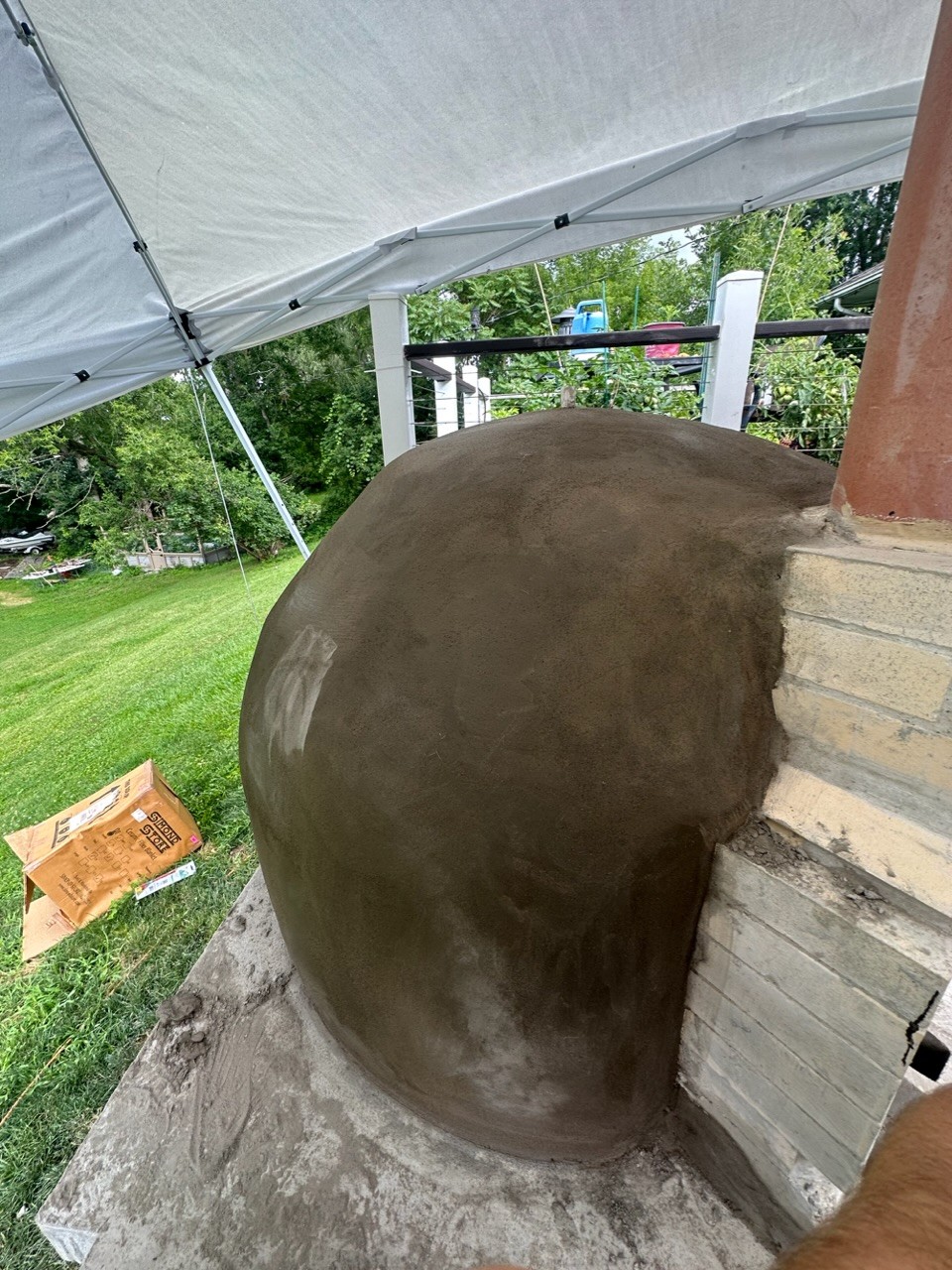

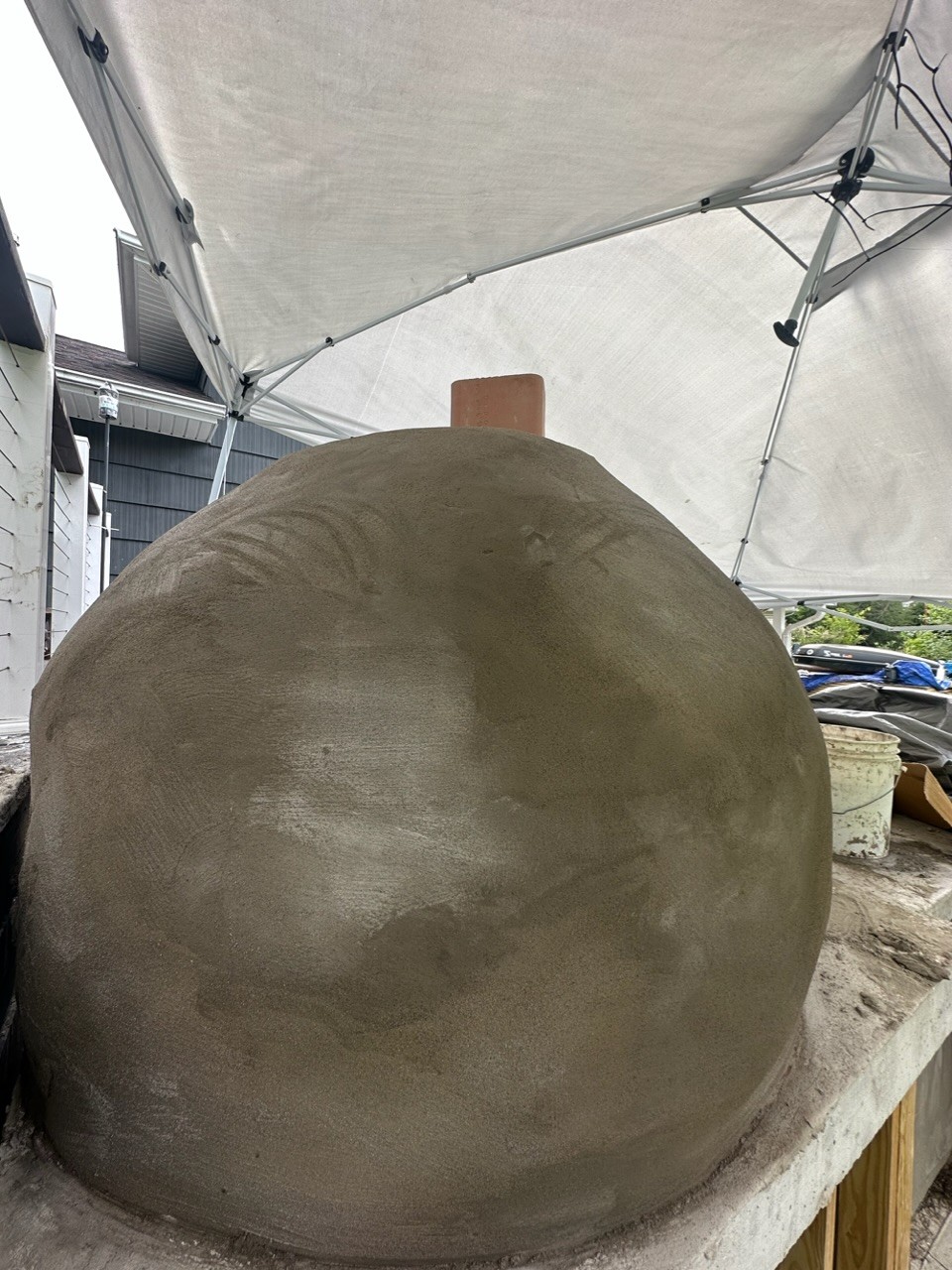

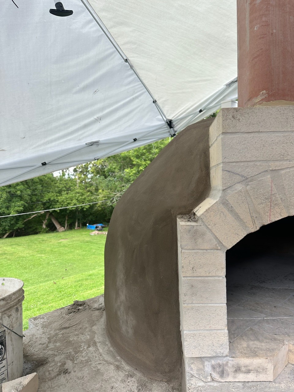

                    Well ,
                    id say the pizza oven is done all that remains now is my final tile finish on the dome , and base and building my brick surround for the chimney
                    the insulation went well I did 3 alternating layers of the 8lb CF blanket
                    (I got this on Amazon for 90 a roll)
                    the top of the dome has an additional layer of blanket as I had left over so the sides sit around 3 inches and the top half has 4
                    that part was easy

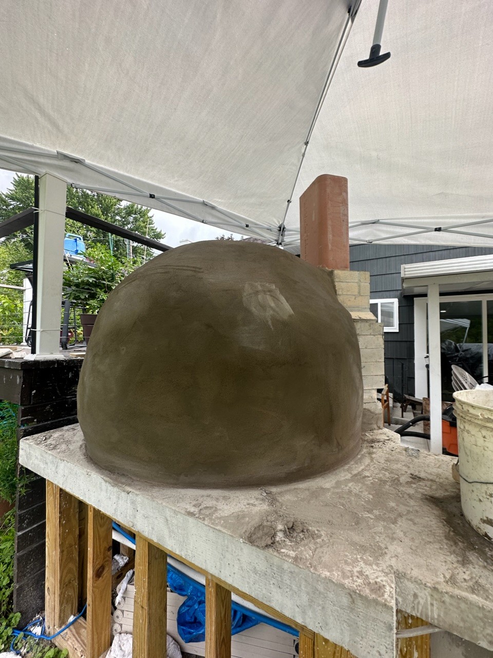

                    the damned chicken wire and getting the Type S mortar to bond was a bit messey and also made my dome look like a giant blob
                    dud to timing (it was 10pm and dark by last coat ) and the fact it was going to rain the entire next day I figured I’d cover it with poly to slow the cure and tarp it and on Sunday (day 1/2 later I’d do a second and final render cost where I could shape and clean up the unsightly mess of the first coat
                    well that went very very well! The dome is massive! Is crazy to see how large it really ends up being and I still have another 1/2 of thickness to add between tile and thinset in the future
                    due to the extra layers of insulation overlapping towards the top the dome took on a different shape then a traditional igloo but I think it looks reallly cool! There are a few areas where it has some small lumps but nothing the tile won’t be able to hide once it’s on there and it gives it a nice “hand-made” natural look so im not bothered by it
                    the chimney sits into the render really nicely and I made sure to give my self a solid base for the future chimney surround to sit on
                    more pictures of that to come!
                    no we r back to waiting it’ll sit in the shade for the remainder of today and then next two days it’ll be in the sun drying out
                    my plan is Friday to light up a small fire and slowly bring it up throughout the night to around 300 - 400 degrees and the Saturday bring it up a bit higher and Sunday go for full heat again that evening

                          Photos of the insulation

                            #88
                            Some photos of the final render!

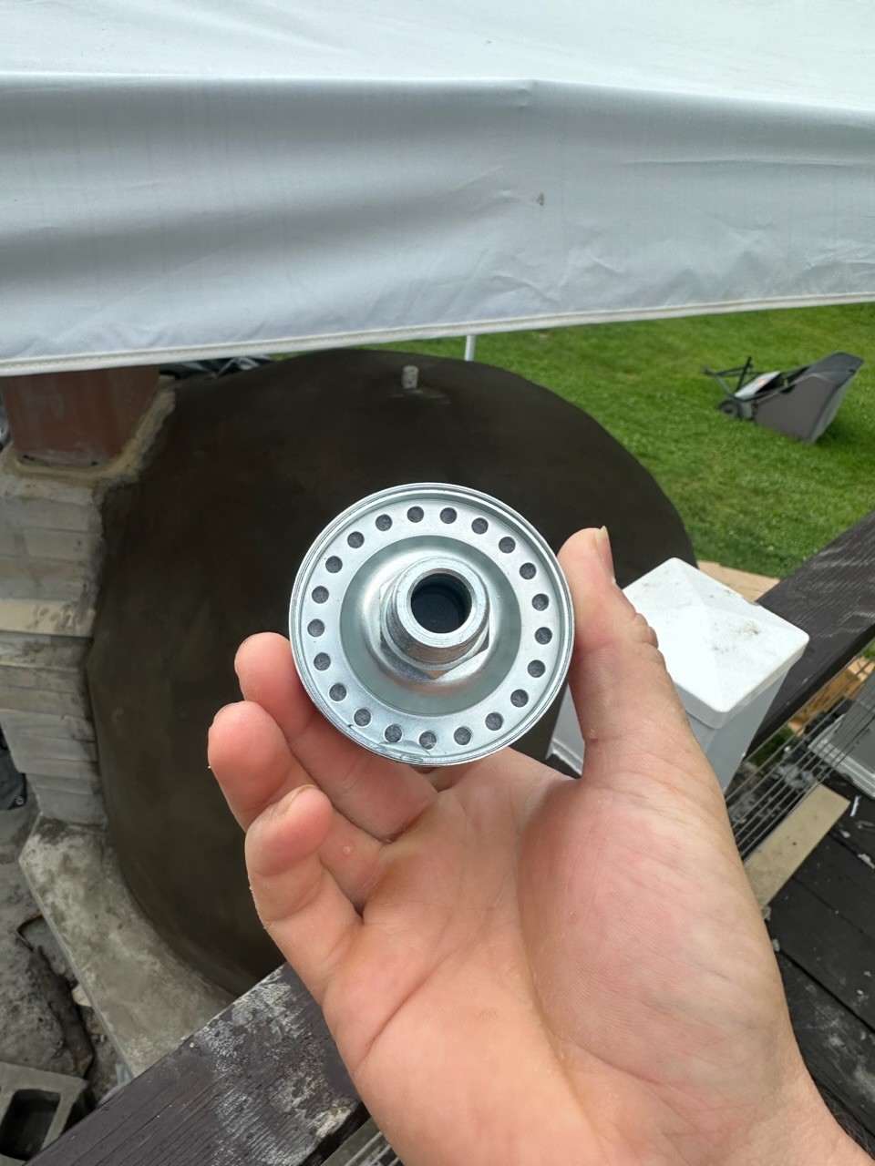

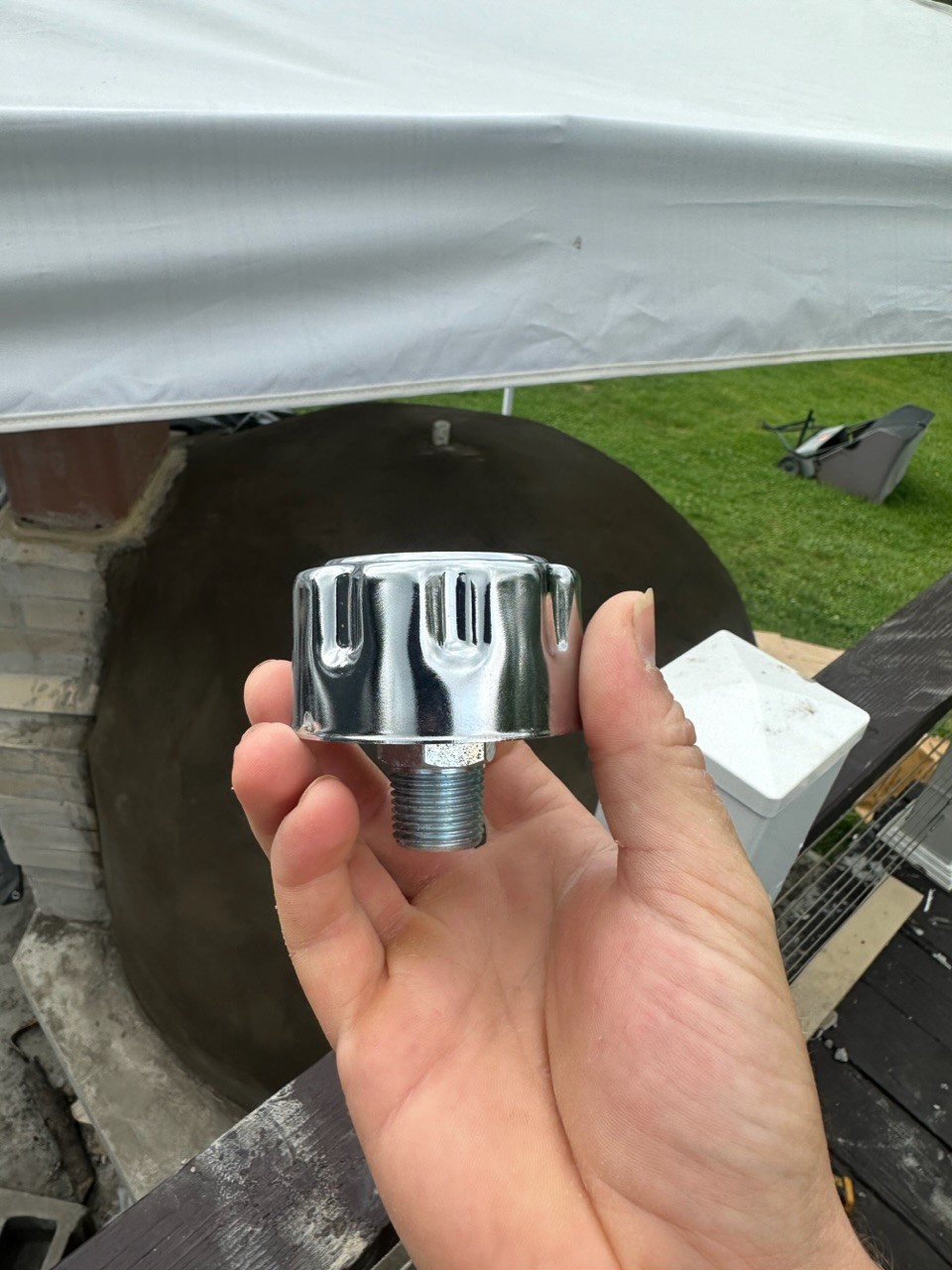

                            Idk if you’ll see the small white lbs at the top but I do have a vent when I go to do the tile I will cut it down to size
                            for the Vent itself I went through NAPA they have multiple breather vents ranging from 1/4 thread up to 1” I opted for their half inch threaded on the vent itself it’s about 1 inch think and 2 inch diameter stainless steel finish
                            so I’m happy with that should work great!

                              #89
                              More photos of the render

                                #90
                                Here are some photos of the vent again Napa for around 10-15 bucks?
                                1/2 inch NPT thread I got a female pvc coupler and a 1/2 pvc to 1/2 male npt thread bottom piece to Sit on the insulation and then I’ll Teflon tape of silicone seal the vent once it’s ready for final install after tile! For now I’ll just thread it on
