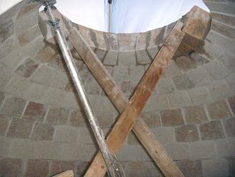

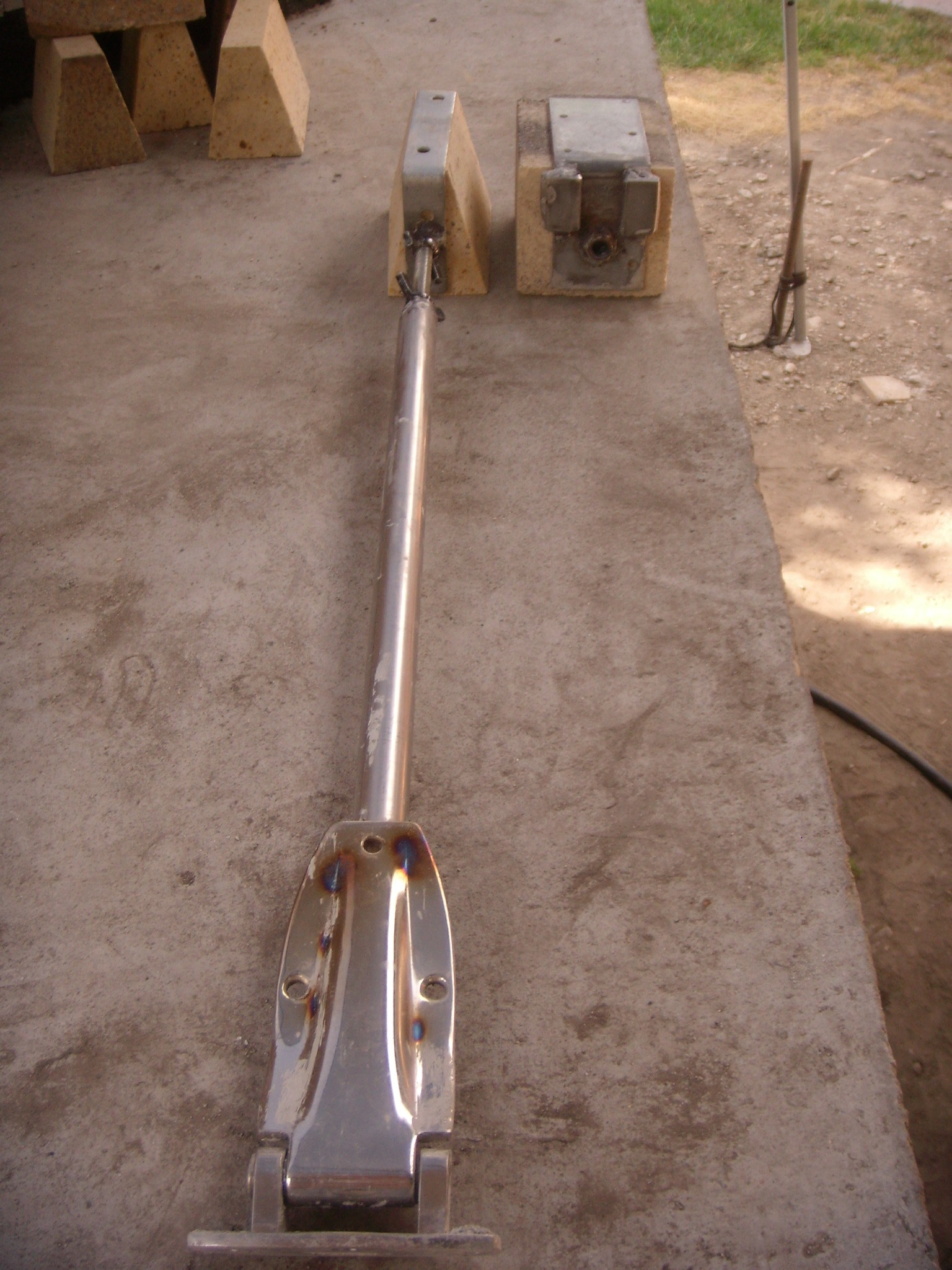

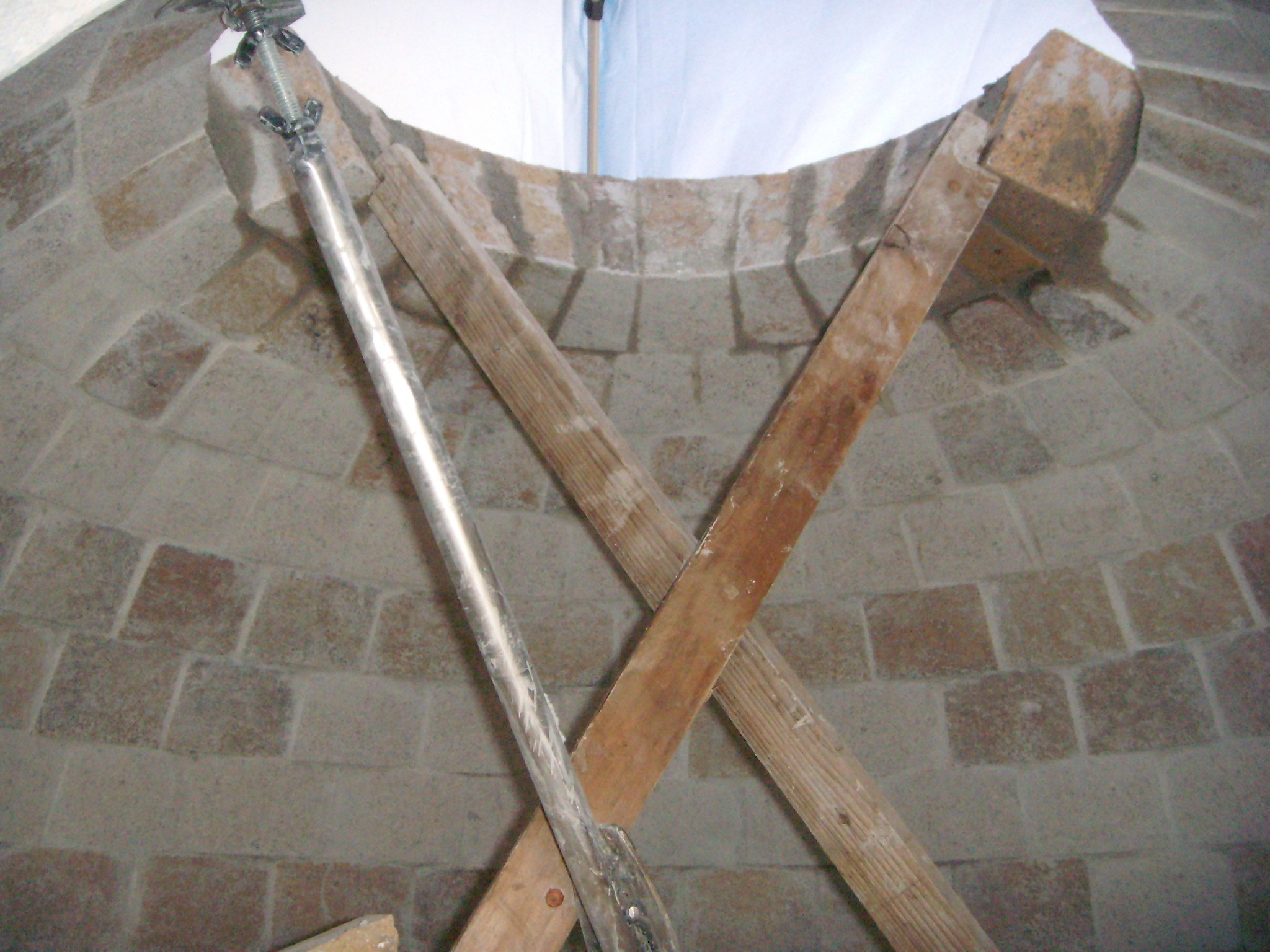

    Using a yoga ball or platform ( I tried the platform but quickly abandon it) you cannot see the inside joints or clean up excess until you remove the support then it is too late or hard to clean. I made a small L bracket for my IT until the last few courses the just used notch sticks to hold the bricks in place

        interesting point I didn’t think of that as far as joints are concerned on the inside I suppose I could always go back and wire brush the dried mortar off if I choose the platform but maybe I too will just think out my it tool as I get higher
        I bridge I shall cross once I get higher for now I’m onto the trickiest of cuts tie-ing my 4th and 5th row into my inner arch
