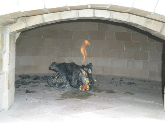

                I started the first small curing fire on Friday. Very small, just paper (ok, a little cardboard too). Went for 2-3 hours, on and off. I really didn't generate much heat. Not sure exactly where to measure the temps. The IR gun measured only 120-150 degrees F max at top of dome. The air temp inside would shoot up to 300 plus degrees when I lit the paper on fire, but the paper doesn't stay lit for too long, and it would immediately drop down. I have a thermocouple embedded in the floor brick. Measured 140 degrees F when I was done.
                Now it's cold and rainy for the next few days. Hope it doesn't snow.

                  Low and slow on the curing fires and you'll be fine. Duration of resisdual heat is important, too- with the thermocouple you'll be able to monitor that easily.
                  To me - and others may contridict - I think you are now ok unless you go over boiling point with your fire too quickly - I think it's the steam and pressure generated by it that is the big player with developing cracks.

                    As long as you don't go too hot too fast I think the exact temperature isn't all that important - as you've noticed its not the same everywhere in the oven anyway. I didn't have a thermometer at the time, so I followed the one bit of wood, two bits of wood method, which also worked out fine.
