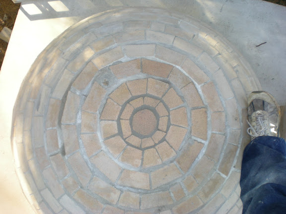

                OK, here it goes. Dutch, you inspired me! I added one more row before the keystone (although I was certainly not able to do it with just one brick)
                I did slice a brick long ways into 2.25 inch pieces. This worked out well. As you stated, the bevels were not difficult with these little pieces.
                Here's a shot before the keystone (and the cleanup)
                The final keystone worked out better in two pieces. Each was 2.25 inches thick (from a brick laying on its flat side) rather than trying to form one 4.5 inch long keystone.
                Inside:
                From the outside:
                It's not perfect, but I was very excited today.

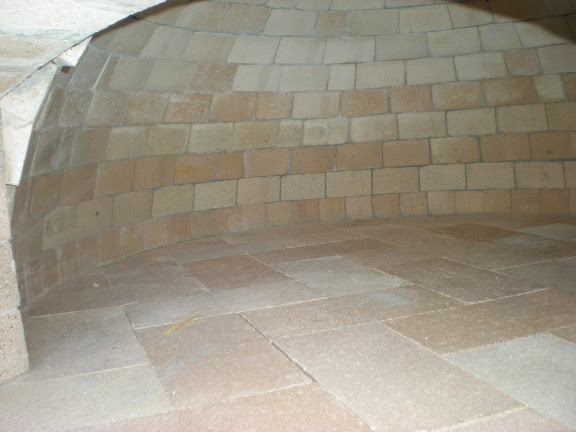

                  A few photos of the inside of the oven, after cleaning up. For the record, that was a real pain, getting in the oven, working upside down, etc. I'm a fairly young, thin guy and still found it tremendously challenging. I would suggest to all new builders, take the time to clean the brick as you go. It may be the last chance you have once that dome tightens up!
                      Mike, I have to differ here (and Buddy, you have done a fantastic job). I think the ticket is to not have any mortar on the inside at all. If there are small air gaps, I view that as a plus - it will aid in a faster heat up. Granted, it may accelerate the degradation of the brick, but we are talking years. Todd was chasing the perfect oven - where is he? If you have the saw and time - it can be done.
