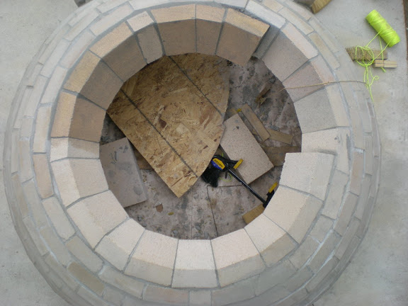

                              11th course done. I'm moving at a snails pace. I thought I would cruise once I cleared the arch, especially these upper courses, with fewer bricks and all. It seems to be taking me twice as long. All bricks have to be cut funny to get them aligned. Takes longer to set up before I can move to the next brick.
                              I hope to see the keystone soon!
