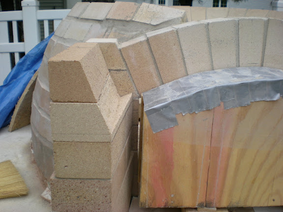

    You could cut a brick or two to fit that space now with close to that angle as it appears from your photo to be about that size...then on the following courses you would not have as much of an issue...but honestly the spaces would not be that big an issue and as Elizabeth said brick chips can do the trick

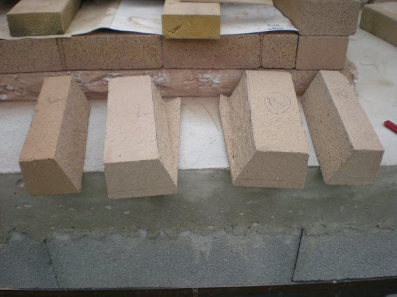

      Still without Heat-Stop, so I started planning the vent. I had put a tapered entry into the oven to improve visibility, access. It isn't much of an angle, but enough to cause a pain in the vent. The trick is to get the bricks of the outer arch to be straight (perpendicular to the front of the opening), yet positioned into arch supports that are at an angle. I cut a odd shaped groove in the arch supports to help with this. I think it will work.
      Here are the bricks cut to fit.
      Here is the left arch support in place

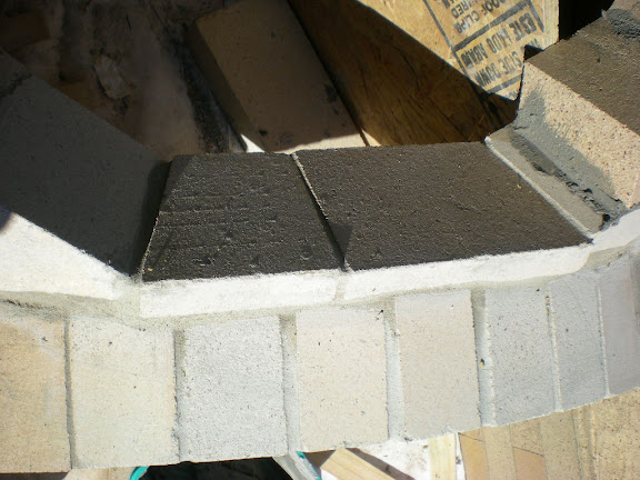

        Here is my tentative plan to bridge that gap. I tried to mimic Daren's "bridge". I worked this out in the afternoon, only later to read Dutch's advice. I think we were on the same track (great minds must think alike! )
        I just took a few brick splits and cut a V shaped notch in to "hang" on the back of the arch.
        Here is the first one in place.
        I think it should help get the next course on the right foot.

          Absolutely what I was thinking...well done...that should keep you going once you get your Heatstop

            Mike, you are a genius! Your OSG (odd-shaped-groove) for the top brick of the arch support brought it right back to perpendicular! I've spent hours thinking about that since I really want the wider opening in the front too but you've showed me in 1 picture how to do it. This forum rocks. And Mike, the dome is looking awesome.

              That's just about how I approached the issue. Seems to work - go for it.

                Hey, Thanks!! I'm certain the credit belongs to someone else on the forum. I am a great copier! Unfortunately, I can't remember where I saw half the ideas I use. I'll still take the genius title, though
                Les, I just re-read that area of your dome thread. I was wondering if I should put anything under that brick for support, but it looks as if you left as is. I agree, I considered wedging a chunk of brick under there, but don't think it would add much. I'm glad you discussed that in your thread. Now I can put it to rest in my own worries.

                              Here is a quick photo of how my transition "bridge" over the arch ended up. Sorry for the shadows in the photo. At least we had a moment of sunshine in MI!!
