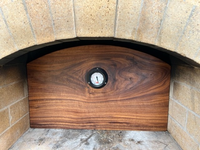

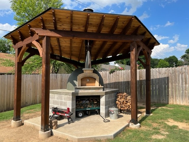

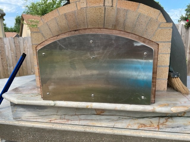

      Finally a roof. Door in progress, lacking handles at this point.

      • #63
        Great structure Duane. Really like the look. Since I had to do a corner build, I had envisioned something similar early on in my planning but my site just wouldn't support it.
        What type of wood did you use? Stained?
        • #64
          Stained cedar post and roof joist. The roof/ceiling is 2x6 tongue and groove cleared cedar. The door is walnut.

          • #65
            Looks fantastic Duane! Well done.
