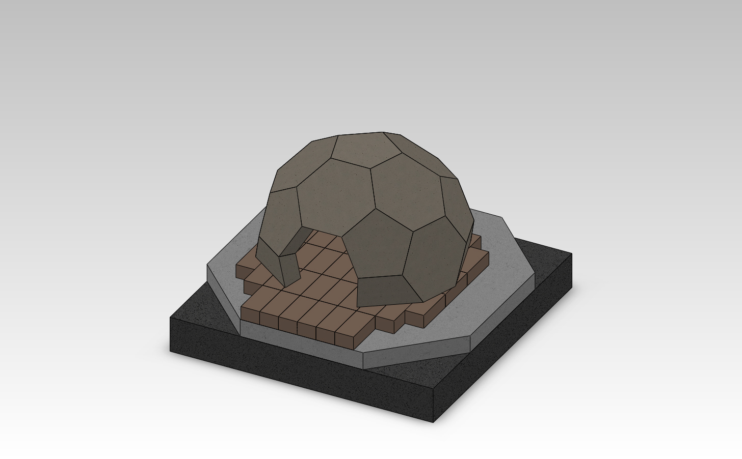

                            well now all the earthquakes appear to be settling down and with spring around the corner I have decided to carry on with my build.
                            I plan to build a geodome oven and use proper refactoring castible for the first ~30mm then use a pour mans mix to get to about 100mm thick brick. This hopefully will stop any spalling and be cheaper to build while still having strength and heat capacity. also I'm going to ditch the flu and go for a simple arch way. basically i will end up with a pentigon and hexagon tile.
                            Regards
                            Bart
                            http://www.fornobravo.com/forum/f2/o...-nz-14012.html

                                Re: Oven Build 900mm - NZ
                                As the original geodesic pompeii builder, I should point out that the point over the doorway is the weak point. I've had to re-mortar bricks there. If you're going with castable refractory, I'd use full thickness for those two elements, for strength, and as they will be exposed to hot flue gasses on both sides.
                                I would also reconsider the no-flue decision. Think about your eyebrows!
