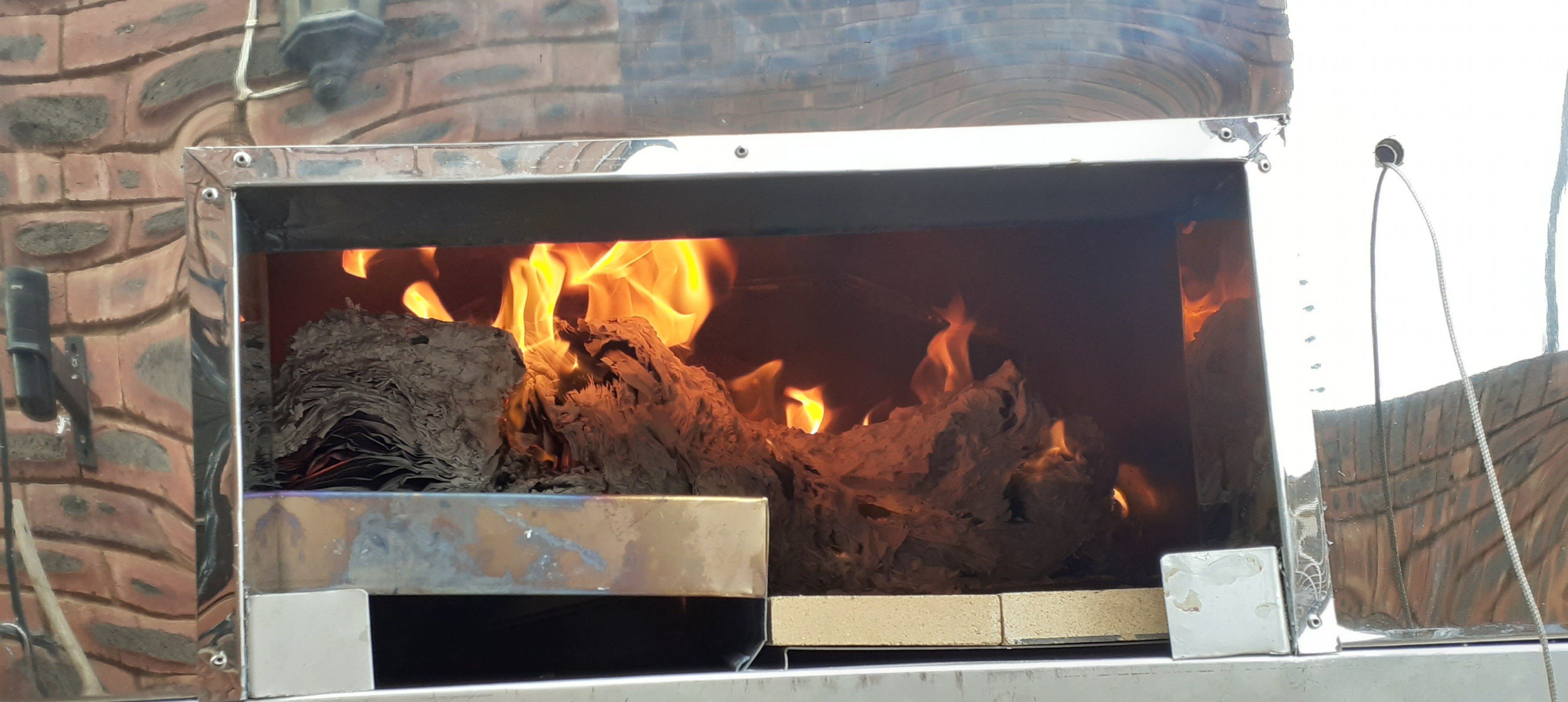

    I lit the oven now and loaded it with some old wood that was lying around the house which I was meaning to get rid of - what a perfect opportunity to create an inferno.
    I also had some old paperwork which I need to get rid of so I threw that in too. The oven is ultra hot - you can barely stand in front of the entrance and just trying to put your hand into the mouth of the oven runs the risk of getting burned. It's very very hot.
    I also put my baking steel onto half of the firebrick floor. I did a measurement of the temperature and the baking steel is reaching almost 700f - the firebrick is around 600f. Maybe the baking steel is my answer to solving the poor heating of the floor. Hopefully I can bake a pie shortly and see how it goes once the flame dies down a bit.

      I took some measurements and found the following
      Whilst the oven was very hot, the outside of the oven was around 170 to 180f.
      The underneath of the oven was actually cold to the touch - you could leave your hand there indefinitely and not discomfort whatsoever. Infact to say it was even warm would be an understatement. This leads me to believe that the firebrick isn't losing heat to the bottom of the oven.
      The steel got to around 700 to 750f and stabalized around there.
      The firebrick got to around 600F
      After the fire died down and the coals were almost out, the Steel measure around 450f and the firebrick around 350f
      Not sure if these measurements can help someone diagnose my problem but I'm so desperate to fix this problem since I spent a small fortune to build this oven - I would hate for the oven to be almost useless.
