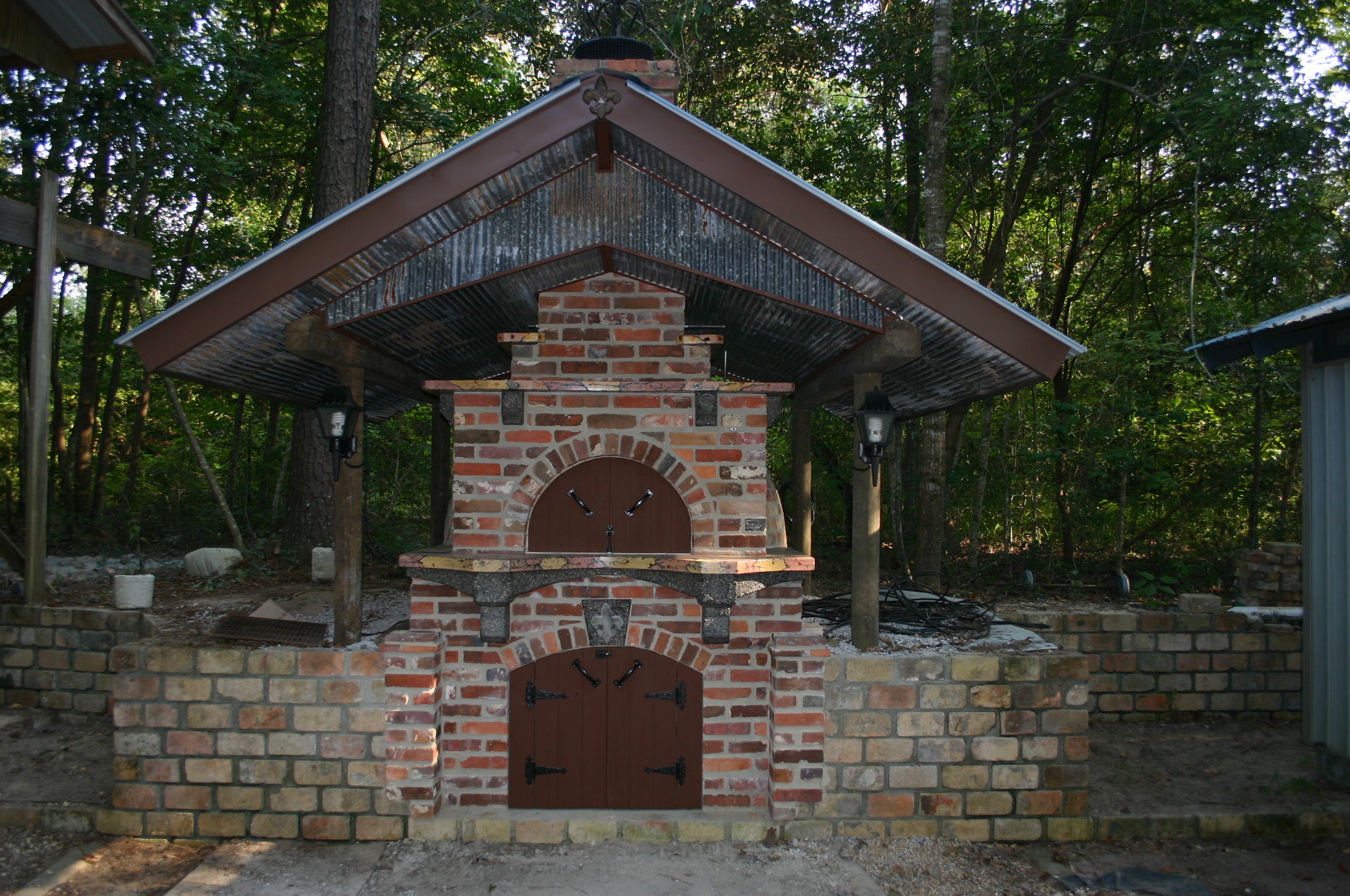

    My roof from my thread. Very easy to build, has worked out great.
    http://www.fornobravo.com/forum/6/32...tml#post161909
    Make sure you plan where your chimney will go through vs where the beams need to go -- I got lucky. Also plan how to flash around the chimney carefully -- doing this with the 'cheap' WWWWWW type corrugated metal would be hard, but the cheap roofing I used had flat areas that is easier to go through and make relatively water tight.

      Nice! I'm planning a peak, centered over the chimney, but that's the type of post and beam support I'd envisioned. I like the way you integrated the columns into the masonry. Are those 4x4 posts? They look like cedar. What'd you use to fasten through the corrugated into the beams. Very nice look! Thanks.

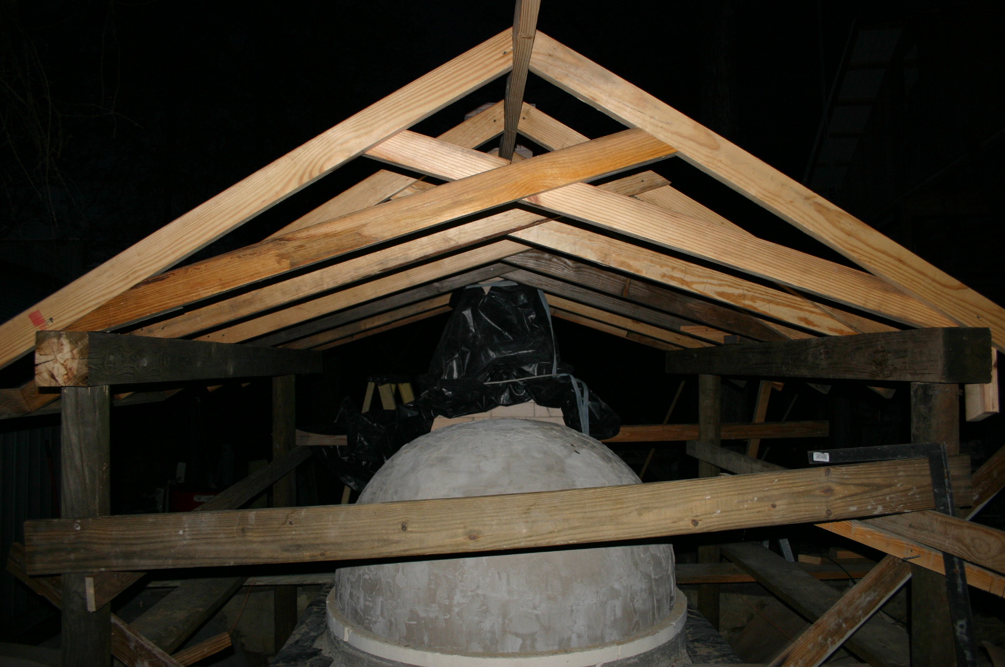

        How about a "stick built scissor truss"? I went with that design because it can be set low enough to protect the oven from rain, but still allow some headroom during the build. It also allows for a little more viewing room of the work that you have done!

        I included the second pic to hopefully show how the members "run by" one another. They are not cleated at the joints like trusses are normally constructed. Stick building the truss, allows you to incude a "ridge pole". The ridge pole allows for a longer projection on the gabled ends. That will give your ovens entry, (and you) more protection from the rain. The "stick built scissor truss" is also, real easy to design and build .

          That roof looks awesome, Gulf....I like what you did with metallic (galvanized) underneath.

                  No problem with the terminology. But, it may get more interesting, since the term ?king post? is mostly used for a true roof truss design. Then there is the stick building method with rafters and joists. The design that I used is a stick built scissor truss. A stick built scissor truss, is a little of both worlds. I will try and include terms from both.
                  I used 6? X 6? X 10? pressure treated pine for the beams. They are supported by 4? X 8? pressure treated poles. The beams are set at an 8? width (outside measurement). Also note, that the pressure treated material is ground contact rated. The beams cantilever over the poles 26? to the front of the oven, but only 4? to the back. Roughly, I have 3? of roof coverage in the front and 1? in the back. Had I of cut my ridge beam longer, I could have easily added one more run of 36 ? metal roofing and gained another foot in the front and a couple in the back.
                  I tied the 6? X 6? beams together on each end with temporary joists (chord beams) to keep them from spreading and to help in squaring the structure. In this, case 8 foot 2X4s that had not yet been cut for rafters. I did not use temporary king posts, but two of them, would have been easy to attach to the temporary joists. On a much longer span, that would have been the thing to do. I just ?eyeballed? the slope of the cut in the rafter?s ?birdsmouth? to toe nail them to the 6X6s. (I used 3? deck screws to do that). When both pairs of gable end rafters were in place, I slid the ridge board in place from underneath. The two pairs of gable end rafters hold the ridge board in place firmly until they can be fastened to it permanently. Then it was just fitting the lower rafters (chords) to run by on opposite sides of the upper rafters. There will be a 1 ?? gap between intersection of the lower rafters which need to be filled with blocking and secured to complete the bracing. A king post would work pretty well to do that. I skipped the king post and just filled in with cutoffs from my rafters. Doing that seemed to give more area to get about 5 screws in the intersection on each side.
                  The lower rafters on the gable trusses can only be run by on the back side of the upper rafters. The face side will have to be scribed and cut to fit to fill in and keep the gable truss flush.
                  My rafters are not a stock size. They were cut from 8? 2?X10? scaffold boards that I did not have another use for. I think that they ended being a little over 4 ?? after ripping them on the table saw. Standard 2X4s would have been just fine up to about a 10 foot span in my opinion. Greater spans would require 2X6s.
                  The rafters are set on 24? centers and the ridge beam I just a little over 10 feet from the ground.
                  The metal was salvaged, from an old shed on my dad?s place. I helped build that shed when I was very young. It will probably take a salvage dealer, Craig?s List or something similar in your area to find used corrugated metal. But, there are ways to artificially age the new stuff.
                  I did not intend for this post to get so long winded. For me, it seems a lot easier to build something than, to try and explain it

                        Your roof is epic gorgeous.....Wow.

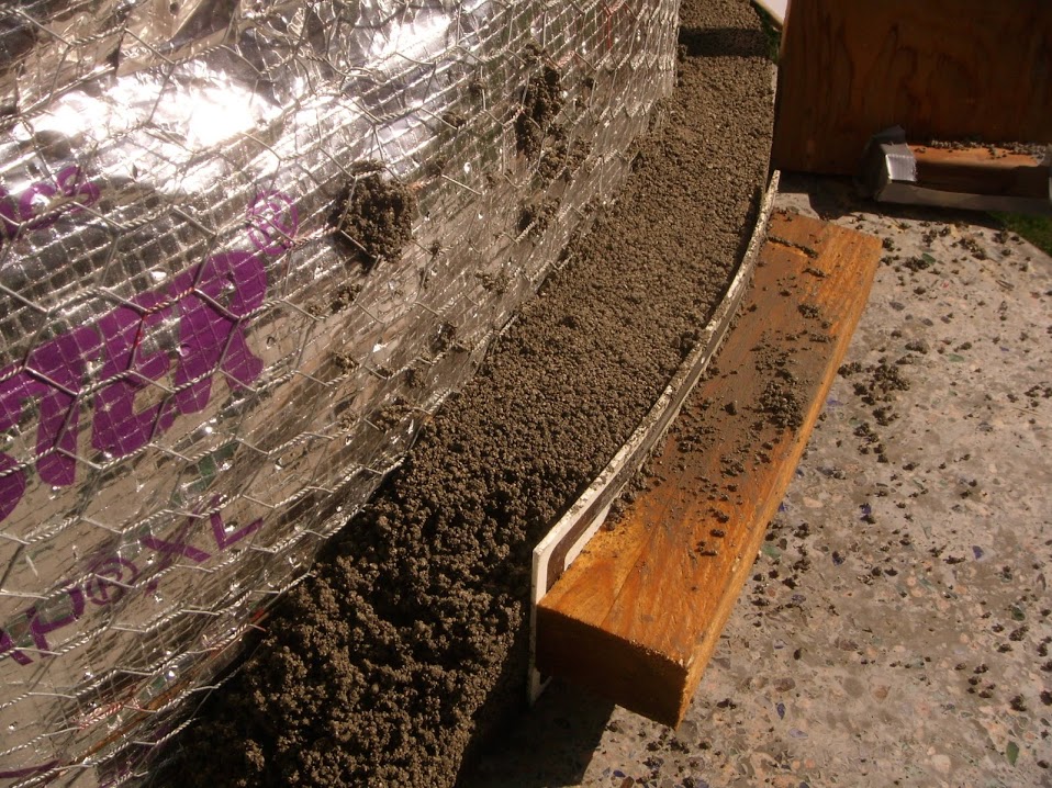

                              Darin,
                              Thanks very much for the compliment. My advice is to keep playing with the vcrete layer to get the oven shape as uniform as possible. The best way to have done that, would have been with one of two variations of a rounded trial.
                              Mine was fixed to a rotating template.
                              Russell (UtahBeehiver) I believe, used a rotating template along with a with curved trial, but with more of a freehand type of approach.

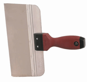

                              Since you are wanting to contour some already applied vcrete, I would buy or fabricate a tool like this. It is a 12" drywall taping knife. It is what I used to freehand some areas of my vcrete and exclusively for the stucco.
                              They are built with a slight curve. It would be great tool to help contour your vcrete. If your (already applied) vcrete is dry on the outside, use a paint brush to sweep off all loose material. A vaccum cleaner woud help. I used an air compressor to blow off the loose material.
                              Just before applying more vcrete to fill in those indentions, use a spritz bottle to lightly dampen the surface.
                              To completely answer your questions, I will have to update this post tommorow night on how to use the taping knife for stucco. But, this should keep you busy for at least one day. I only have a few minutes each night to post. 12 hour work days + the chores around the house .
