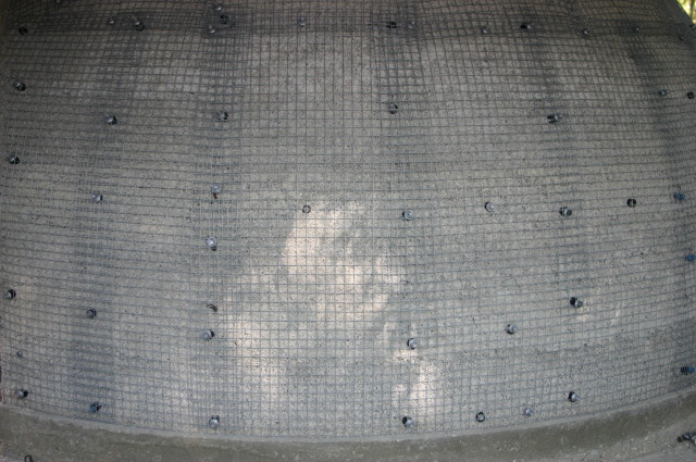

Once you have your vcrete dome shaped to your liking, it is time to prepare for the stucco. I like using 1/2" mesh wire for support.
Some don't.
If you think that this what you want, I will step you through how I applied the wire. But, for now, here is how I applied stucco. I am copying this from another post that I made.

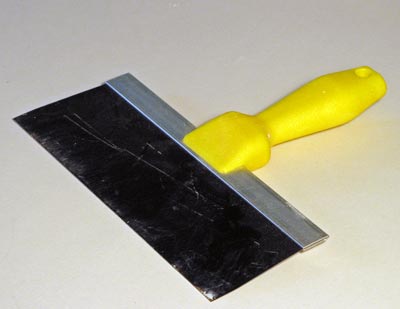

I used a 12" short handle sheetrock seam (taping knife) trowel.
It has a slight curve built in to it. It will take a little pratice to figure how much stucco to load on to the trowel. Forget the handle, grab it by the ends. Start at the bottom and apply in a vertical motion. It will apply about 3/8" to 1/4 " for about 16 to 18 inches verticaly. Go all the way around the dome overlapping the runs about a couple of inches. Now go back to where you started. If it has dried out, you will need to apply some more fortifier by brush. Overlap the bottom run by about 4". Each horizontal run gets shorter (and faster) as you go up the dome towards the apex.
