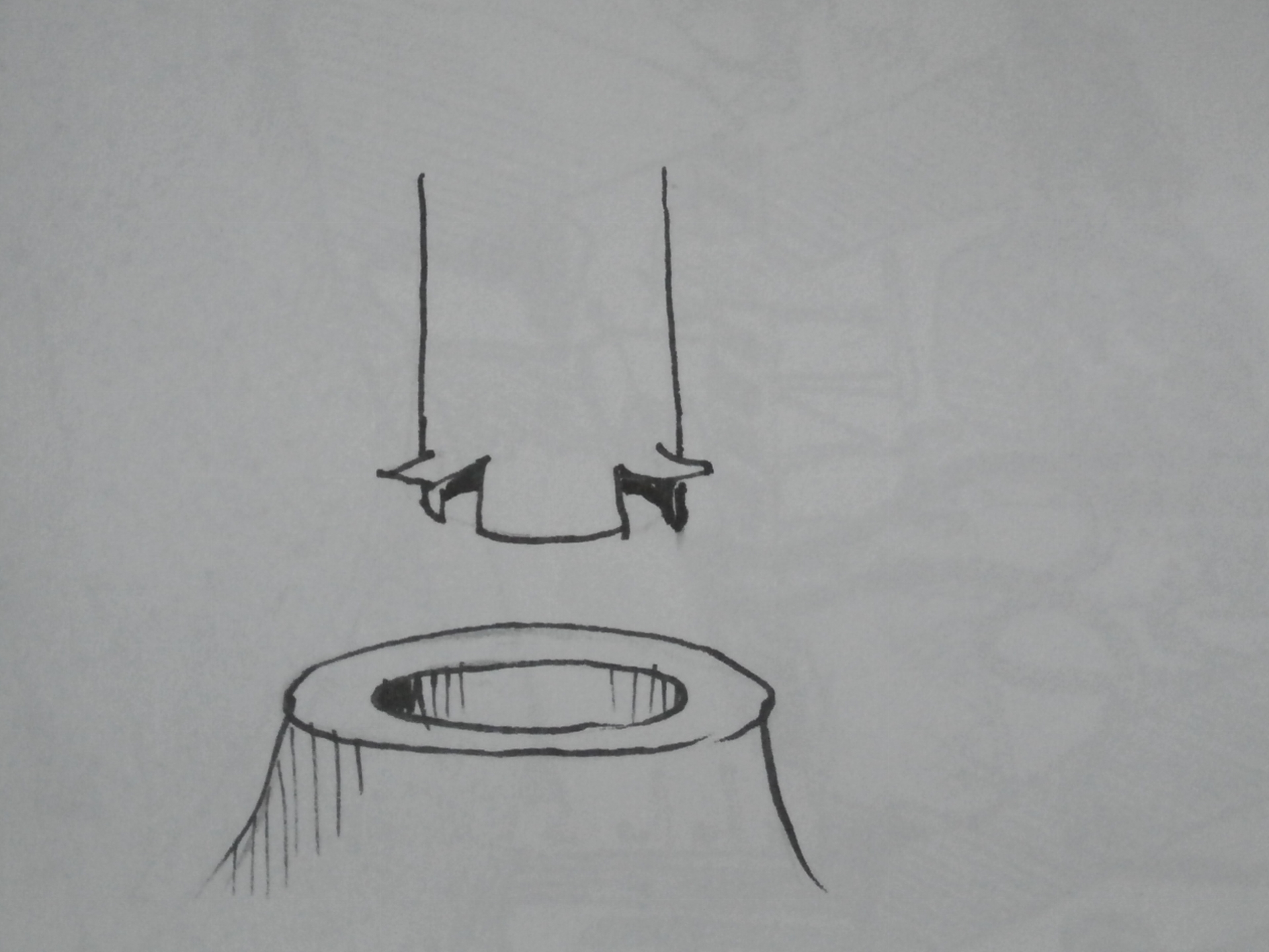

                  Does anyone knows how to install the chimney cap? As you can see in the photos, the cap has some kind of legs, but it doesn´t seems to fit anywhere. If the legs weren´t there, the internal diameter of the cap fits perfectly into the pipe, but before cutting them out I ask the community if anyone knows how to install this particular model.

                    Mine was threaded. Is Shasta the brand of pipe or the store you bought it?

                      If this is what you have it looks like it is twist fit too - see page 20

                          To answer JRPizza , I found before the pdf instruction that you attached, but it doesn´t say much, if you look to page 20, mine is like the drawing in the bottom left of the page, I know it says that it twists but I can assure you that is not, there must be some kind of mistake. Anyway, if I´m still missing something it doesn´t matter, I´ll find a way even if its not the intended way, it just needs to sit on top tight that it doesn´t blow off.

                              Sorry, I should have known it wasn't going to be as easy as looking at the installation instructions. I did however look at their cataloge and think I might know what the problem is. On page 12 of the link below it shows the "standard" chimney cap that installs with a twist, and "The Universal Chimney Cap" that per the catalog "slides into the existing chimney section and the legs are secured with screws on the exterior of the chimney pipe." From the picture it looks like you might have a universal - perhaps you could check with your vendor and see if you could swap it for the standard and avoid having to use screws. I don't know if I will ever need to remove my cap (maybe for cleaning) but it's nice to know I could if I wanted to (although it will probably be stuck with all the heat and cresote).
                              http://www.shastavent.com/assets/SV_...v1.40_2018.pdf

                                JRPizza thanks for the info, indeed it says that I should screw the cap on from the sides, that´s not very aesthetic, I would´t do that, so, I´ll do as you suggested, I will contact the vendor and ask him for a replacement if possible; if not, i´ll just buy a new one.
