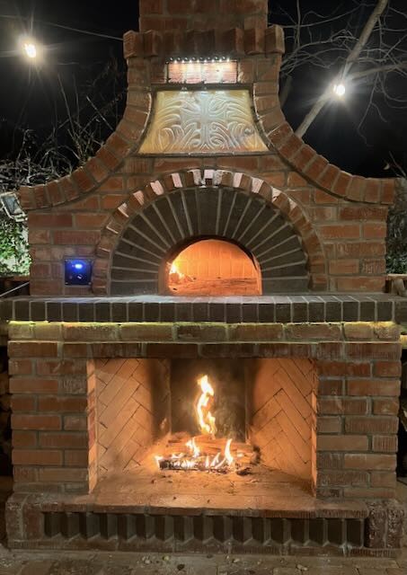

    Combination Rumsford fireplace and Pompei pizza oven project.

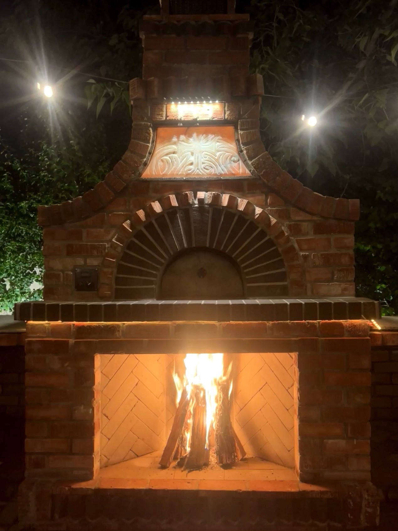

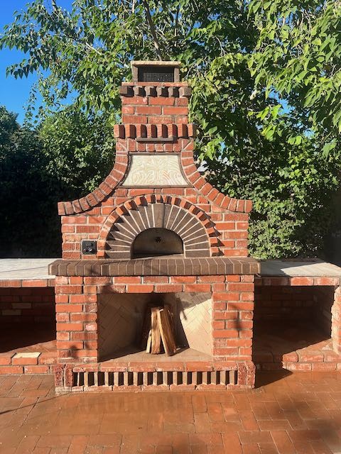

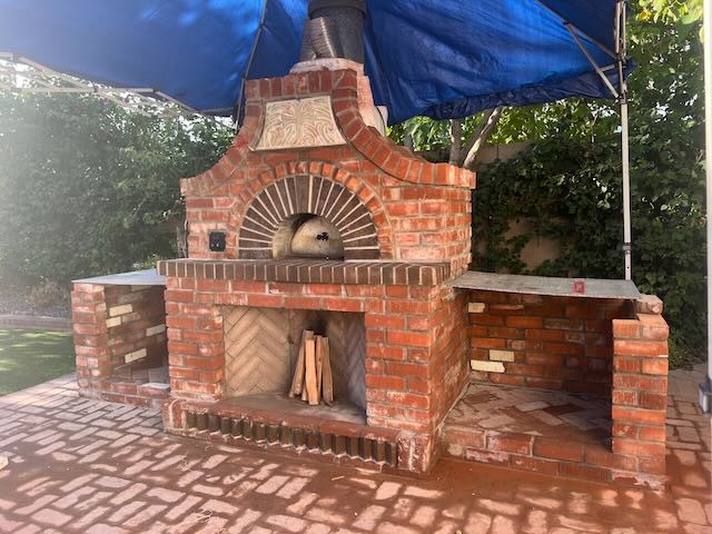

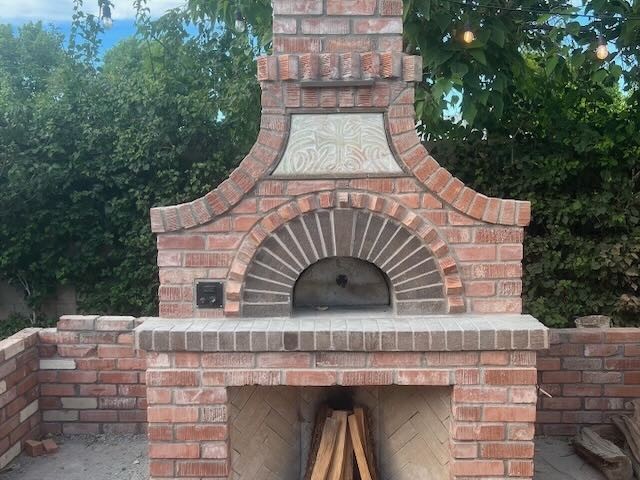

    We love a fireplace and a pizza oven and looked for ways to combine them in a small space. I hope this design inspires and blesses others who love Jesus and Pizza!

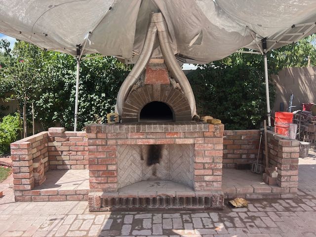

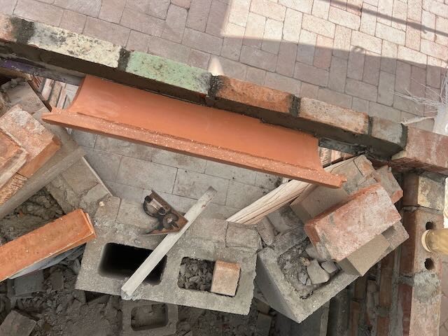

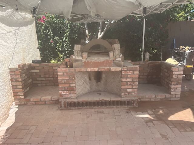

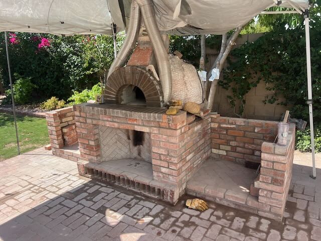

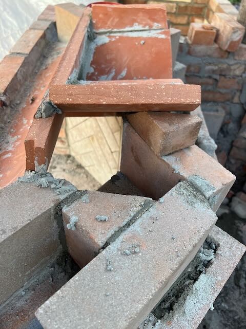

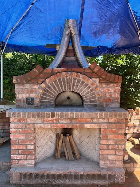

    The fireplace is a Rumsford style so that it could be shallow. The secret was splitting the flue around the entrance to the pizza oven by using stainless steel flex flue liner.
    The fireplace chimney is in front of the pizza oven chimney which is a squirreltail chimney. Both are completely separate
    The pizza oven is a Pompei style oval 32 x 38".

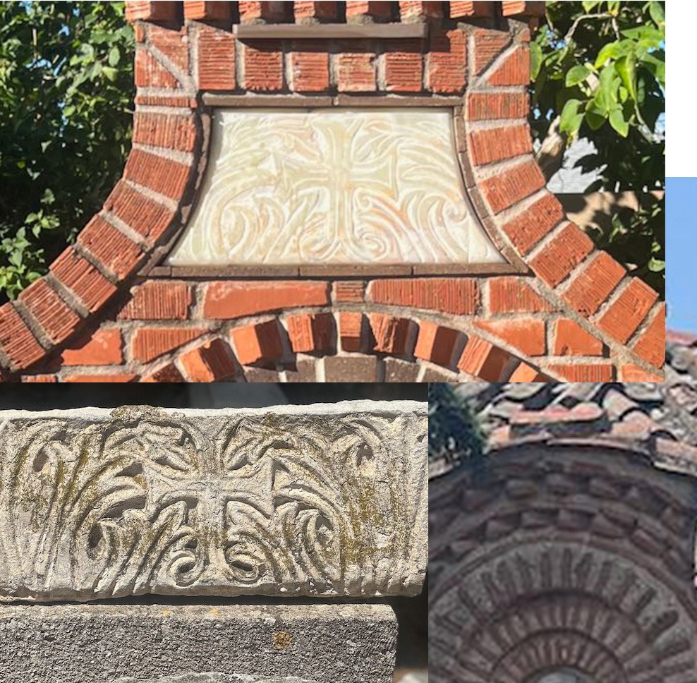

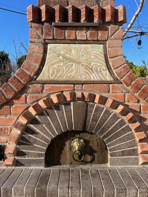

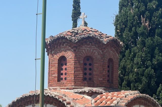

    The diagonal brick feature for the arch was inspired from a 3rd century church in Thessalonica, Greece. and the backlit, carved onyx from an artifact from Corinth.
Name:	Combined inspiration.jpg
    Thanks to everyone on this forum for your inspiration and help. If you want more build pictures or documentation, please let me know.

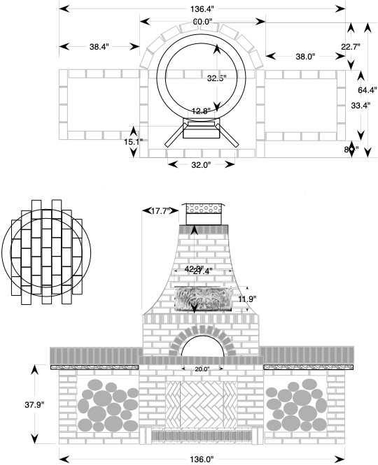

        As requested, here is the original CAD for dimensions.

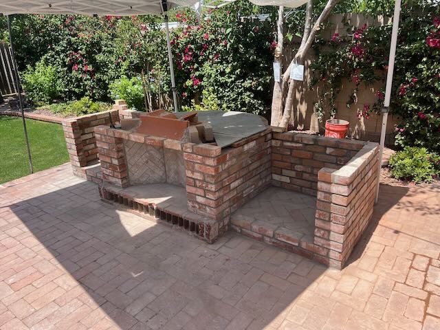

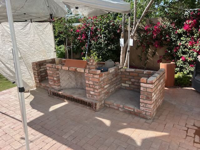

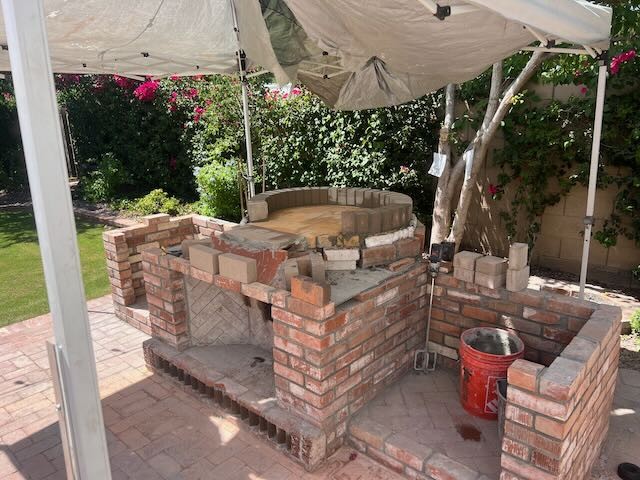

            Why a Rumsford Fireplace? I knew there wasn't much depth available since the smoke needed to exhaust around the throat of the oven. This design accomplished that beautifully with great functionality.
            • pacificfurn
              • 38

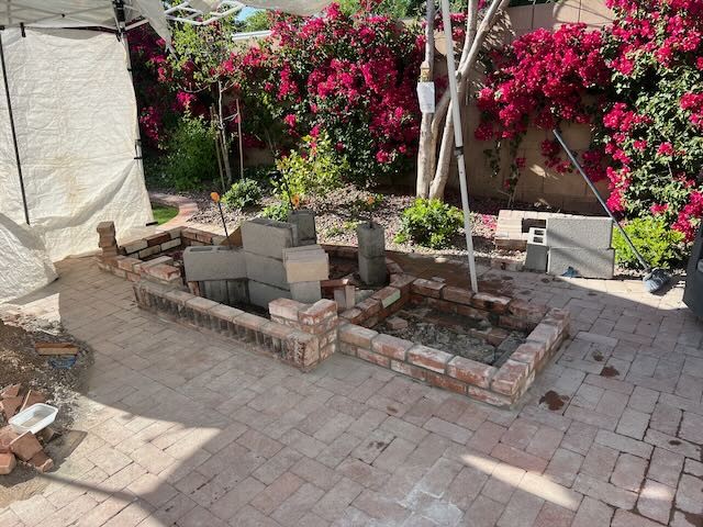

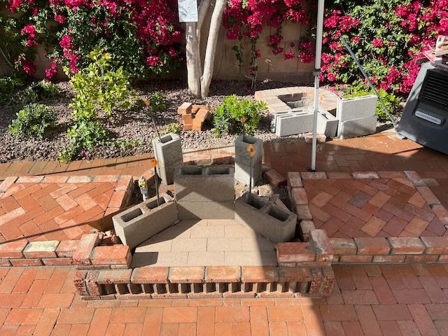

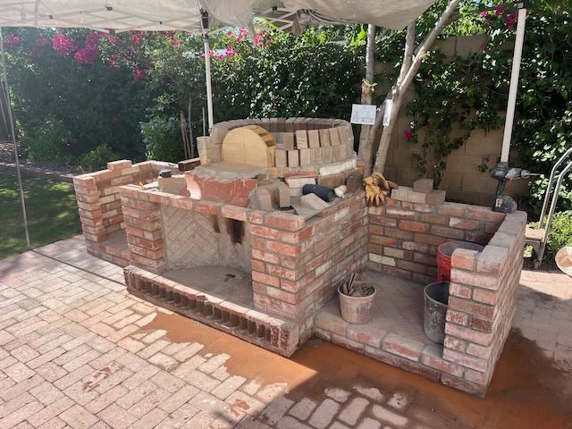

Name:	Rumsford fireplace shape.jpg
ID:	468052 Fireplace in the front, columns in the back Click image for larger version

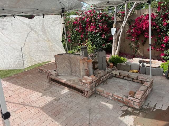

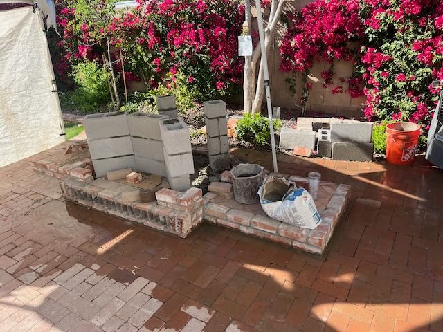

Name:	First layer.jpg
ID:	468053 Floor of firebox and floor of wood bins. Click image for larger version
Name:	Rumsford taking shape.jpg
ID:	468054 Full support and fireplace box Click image for larger version

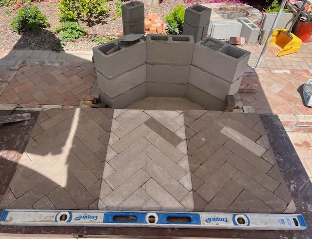

Name:	Layout for herringbone.jpg
ID:	468055 Herringbone layout Click image for larger version
ID:	468056 Herringbone installed

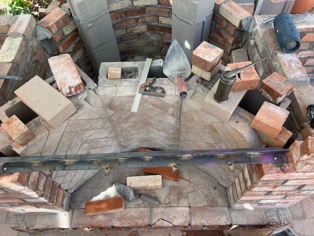

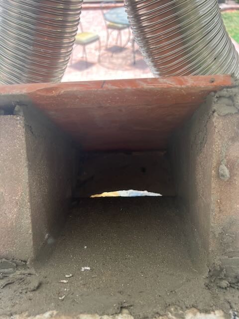

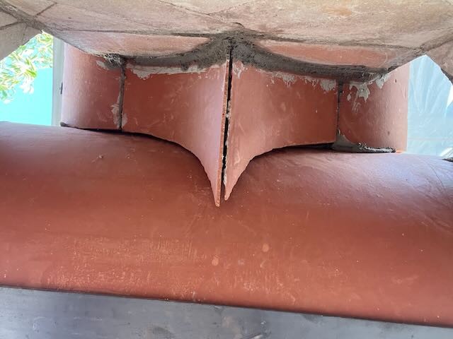

Name:	Flue inside.jpg
ID:	468061 Planning the Rumsfort Bernoulli flue Click image for larger version
Name:	rumsford Bernoulli flue.jpg
ID:	468062 Finally tall enough to get off of my knees! Click image for larger version

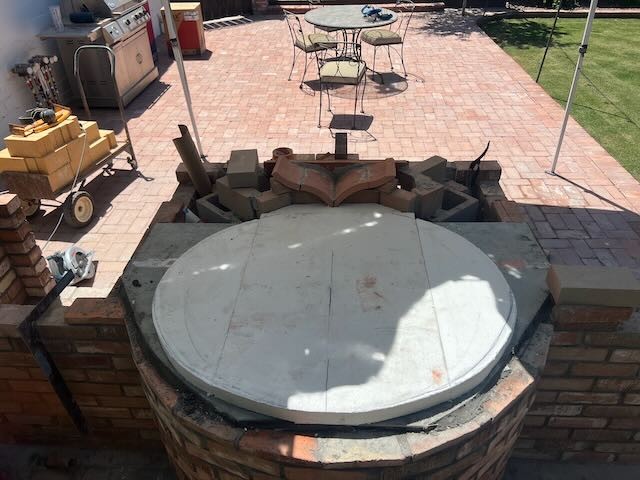

Name:	Oven foundation.jpg
ID:	468063 Steel, concrete board foundation Click image for larger version
Name:	Flue Splitter.jpg
ID:	468064 Inside view of the Rumsford flue with splitter. Click image for larger version
Name:	Diverting to side.jpg
ID:	468065 Looking down one side Click image for larger version
Name:	Oven floor insulation.jpg
ID:	468066 Insulation board on foundation

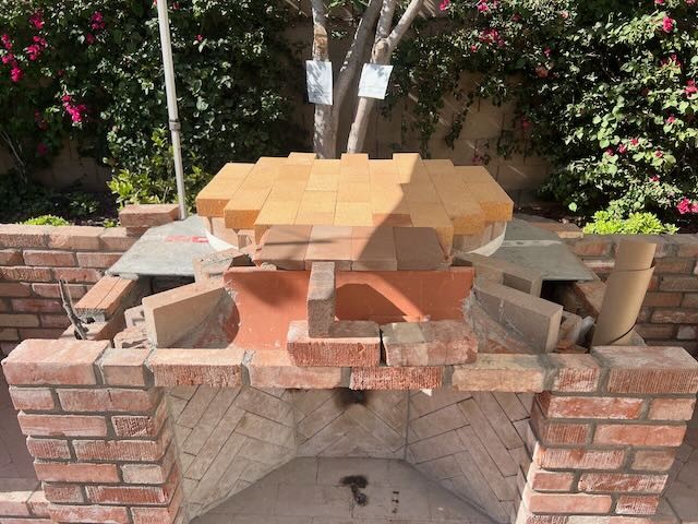

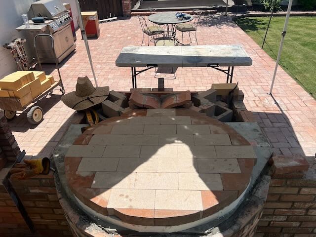

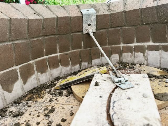

Name:	base of floor.jpg
ID:	468068 Firebrick Oven Floor Click image for larger version

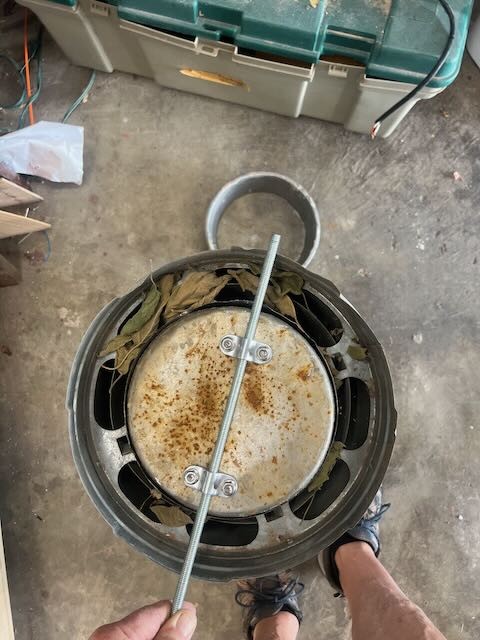

Name:	the amazing tool at work.jpg
ID:	468069 The Amazing Tool. For an oval oven, it slides along the curved slot.
Name:	Oven floor with transition.jpg
ID:	468076 Final firebrick floor layer with throat transition

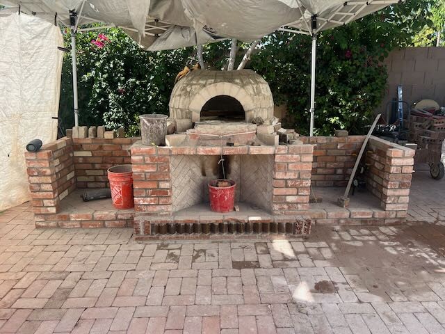

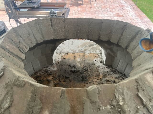

Name:	dome first course.jpg
ID:	468071 First Course
Name:	dome second course.jpg
ID:	468072 Second Course with arch

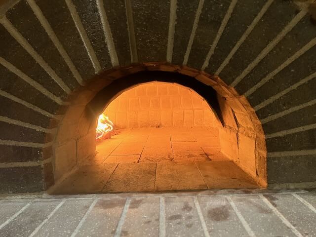

ID:	468078 Inside out
Name:	Peek a boo.jpg
ID:	468079 Peek a boo

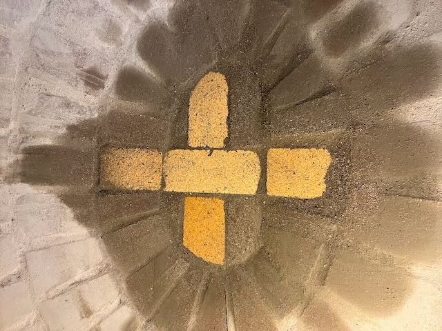

Name:	Near the top.jpg
ID:	468082 Near the top

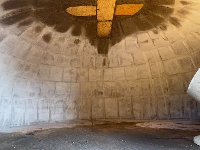

ID:	468084 Dome is Done
Name:	Final touch.jpg
ID:	468081 Crowning Touch

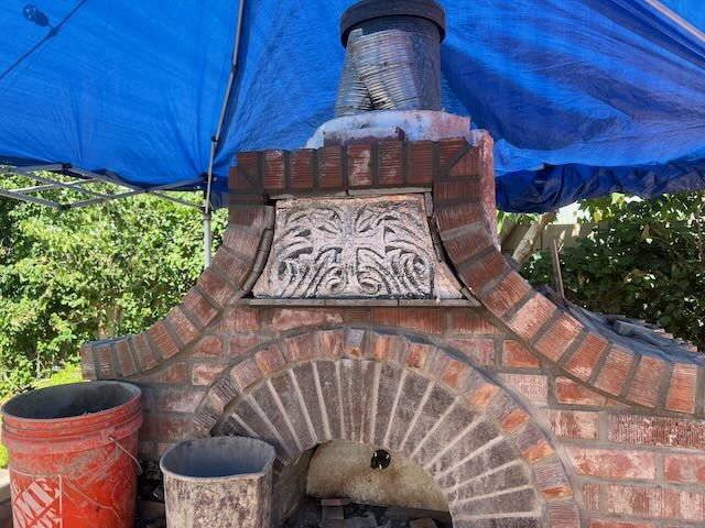

Name:	Cladding and SS chimney.jpg
ID:	468083 Oven Arch with Stainless fireplace flues
                    • pacificfurn
                      • 38

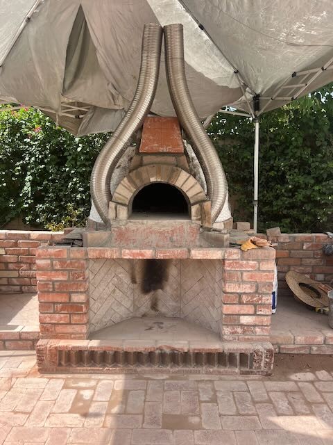

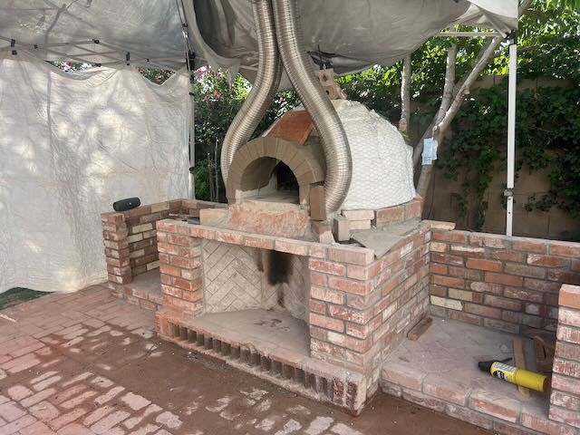

Name:	Oven squirlltail.jpg
ID:	468086 Inside the squireltail for the oven flue
Name:	finished inside.jpg
ID:	468088 How it comes around and together
ID:	468090 Arch face and hearth. Insulation installed.
ID:	468089 Controls installed, counter arch begins.
Name:	Full scale.jpg
ID:	468093 Finished front.

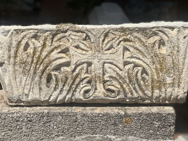

                        Greek Church of Saint Pavlos in Thessaloniki, Greece
Name:	Greek Church of Saint Pavlos in Thessaloniki, Greece.jpg
                        Stone carving at The Archaeological Museum of Ancient Corinth
Name:	Corinth museum.jpg
                        Template in place
Name:	Onyx Inset.jpg
Name:	Corinthian Carved Onyx.jpg
ID:	468099 Details of Greek inspiration
                        • pacificfurn
                          • 38
Name:	Front Details.jpg
ID:	468107 ready for finishing touches

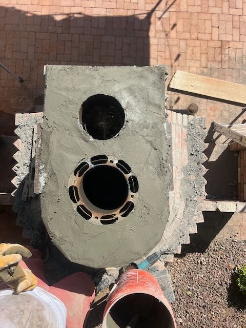

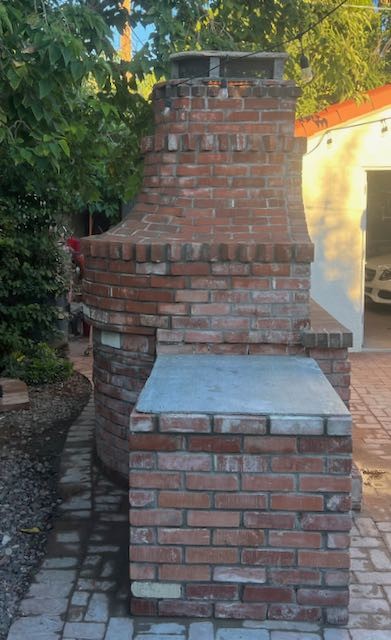

Name:	Top of chimney  Both Flues.jpg
ID:	468105 Double chimney. The front hole is for the Rumsford flue. The back hole is the pizza oven flue

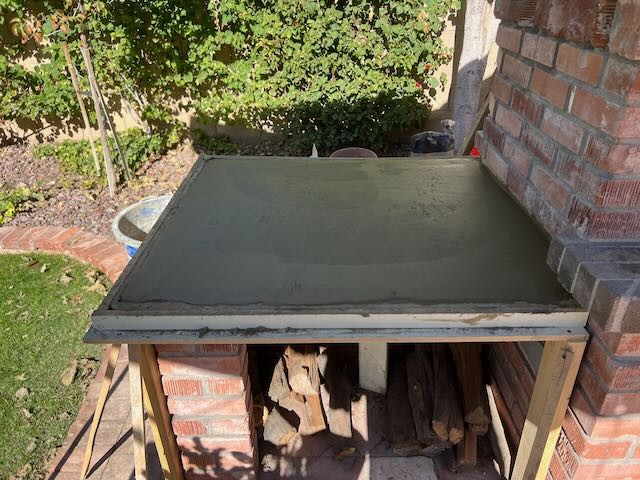

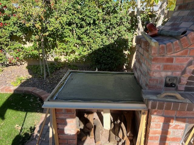

Name:	Concrete counter forms.jpg
ID:	468104 Concrete counter forms in place

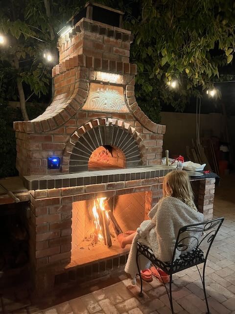

ID:	468110​All lit up! Both the oven and the fireplace burning. LED downlights and backlit onyx
