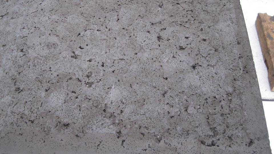

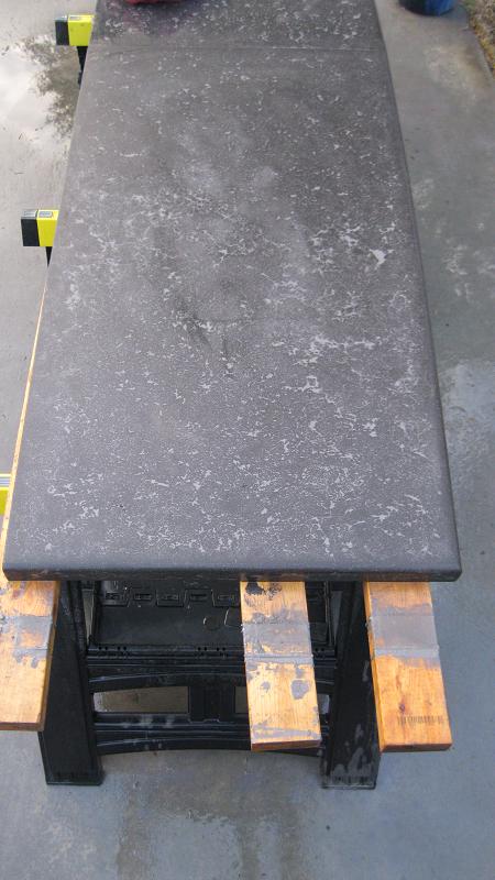

                      This was my second attempt (first was a small test slab 26"x30")and first paying job doing this kind of concrete. I got interested in it because of the design possibility's and how you can make concrete look similar to stone with this method. This was for a fireplace hearth. it was 8'-6 total length and 26" at the center.
                      Here are some shots of the slabs after they were unmolded.

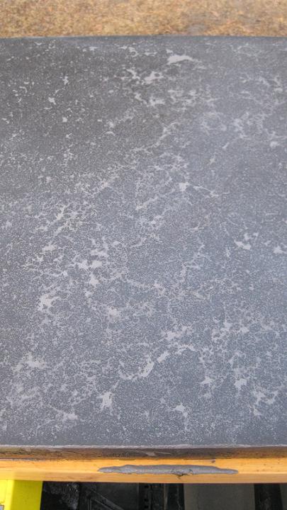

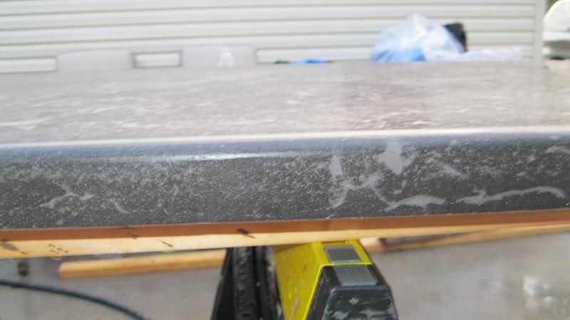

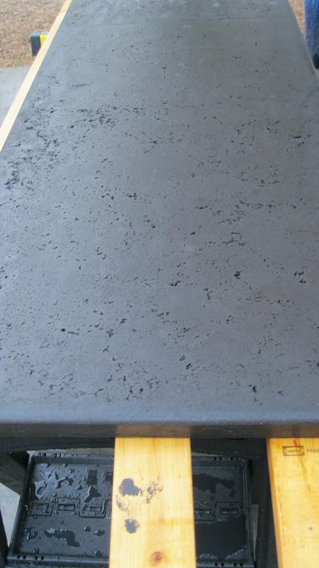

                        The color is charcoal and the veining is pewter. I created the 1/2" with a wet profiler that is typically used in stone counter fabrication...I use it for pool coping or other custom things. I am inexperienced with adding profiles to moulds, plus.. I knew I could get a nice clean edge with the profiler.
                        Some shots after final polishing.

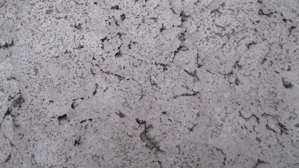

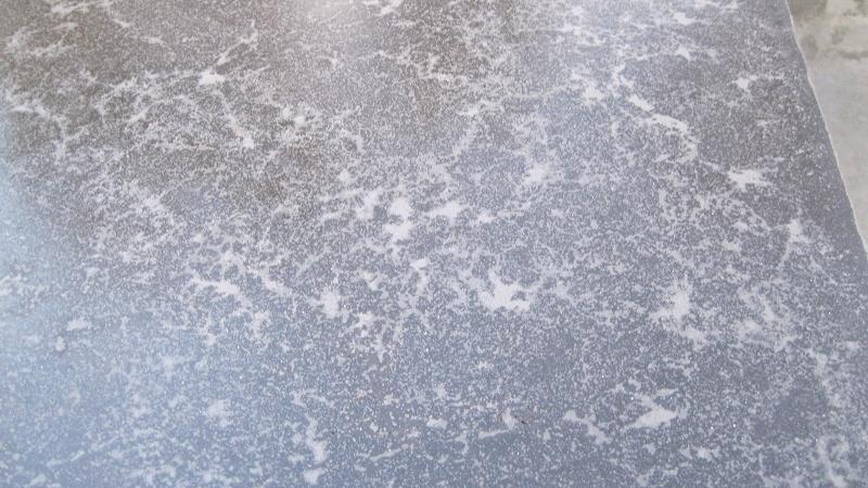

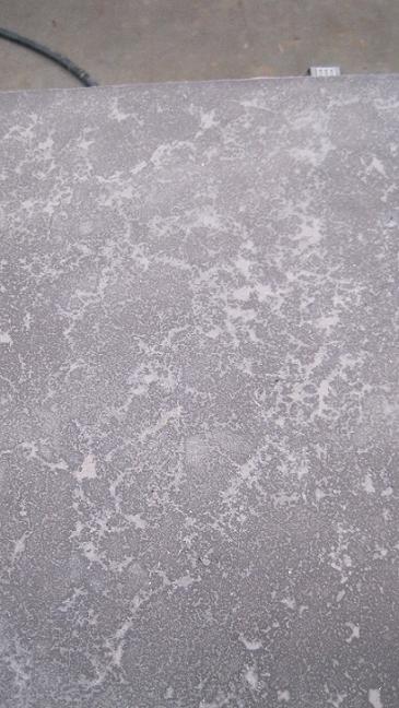

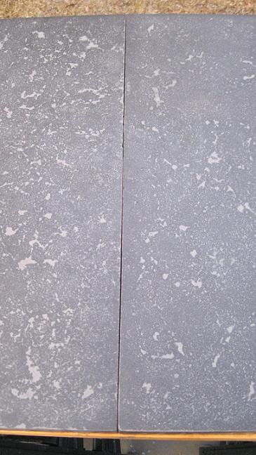

                          Some close ups of the veining.

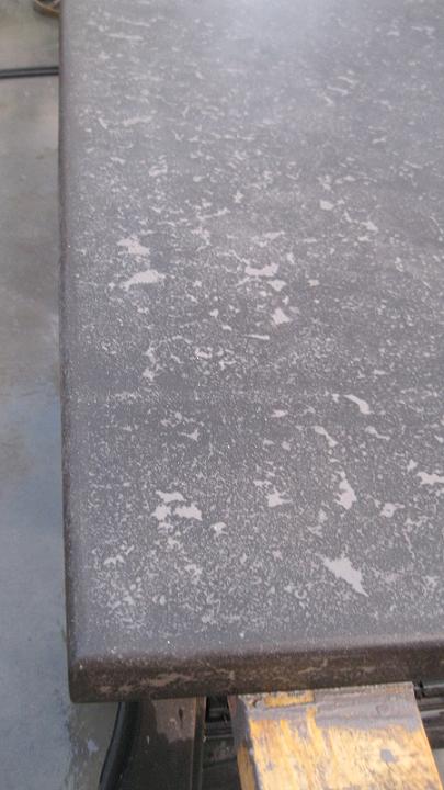

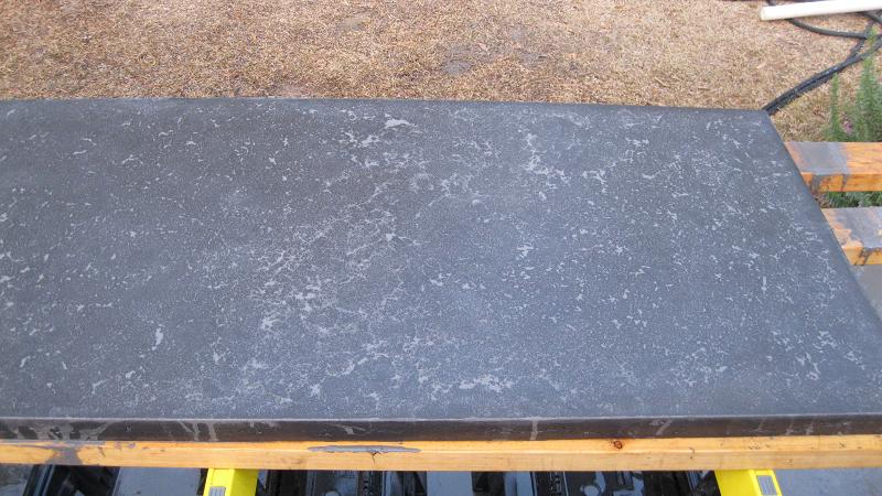

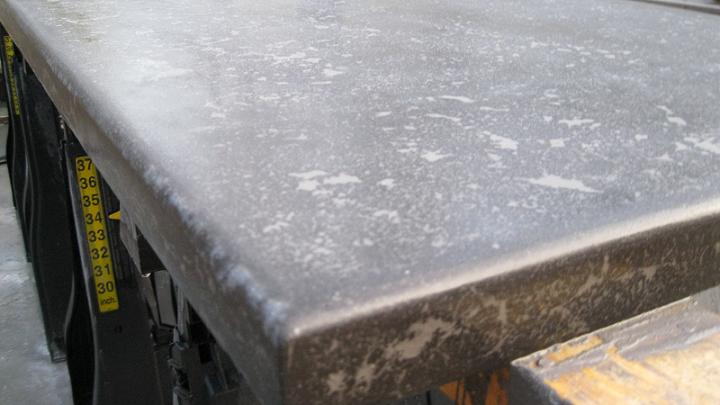

                              Close up of the profiled edge and a some of the finished product.
