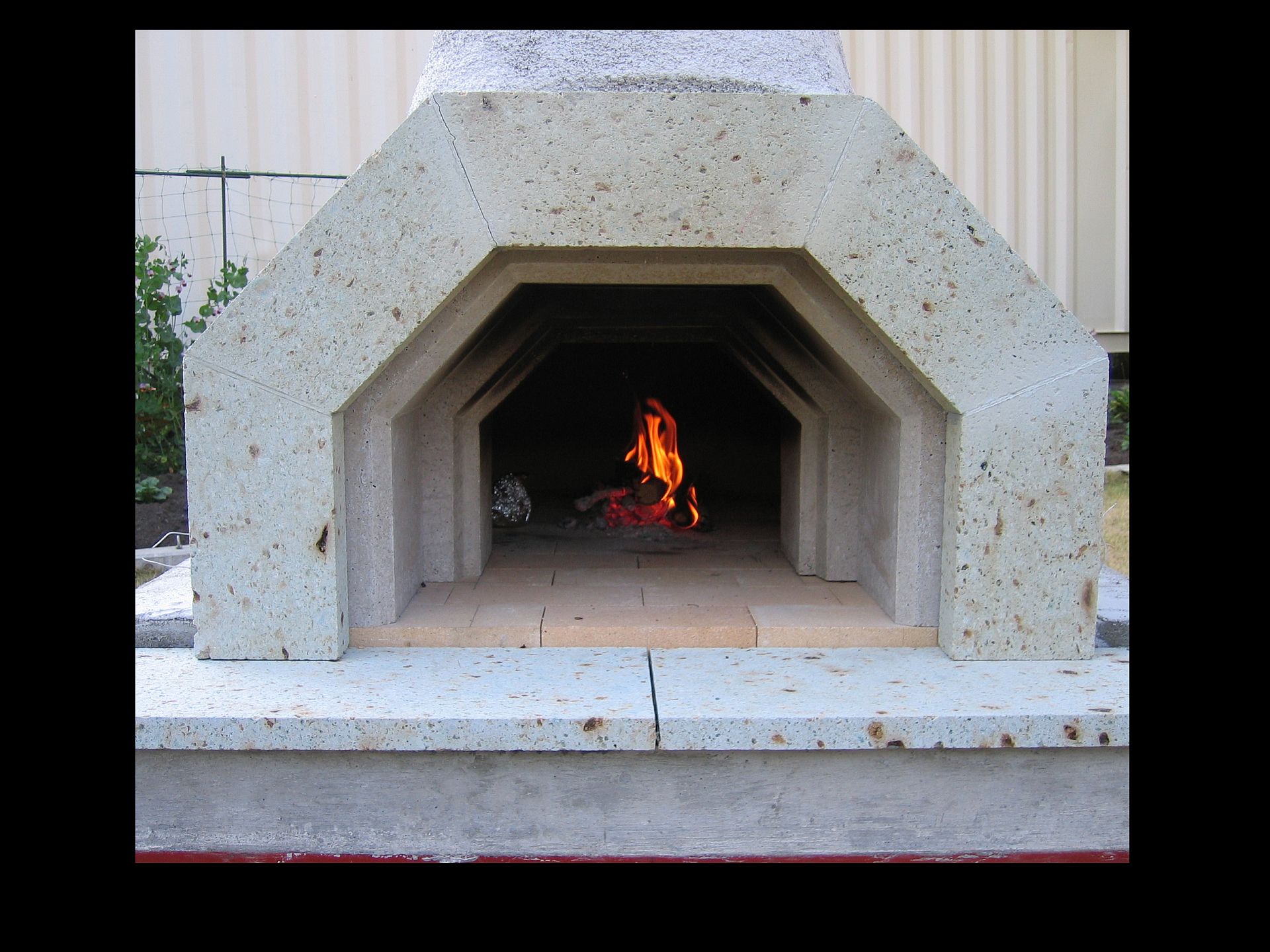

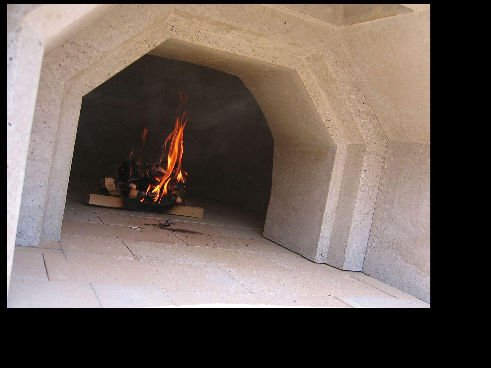

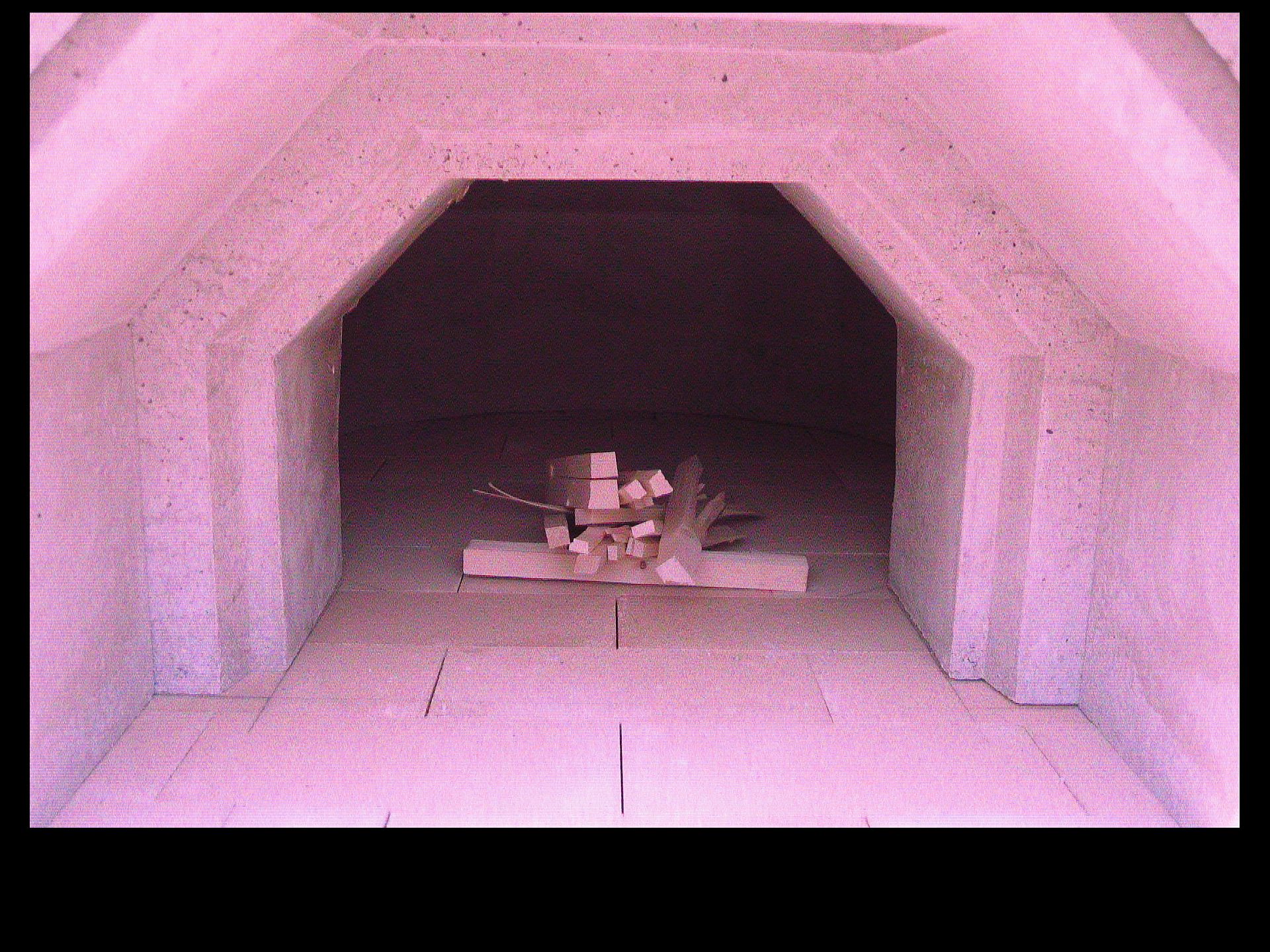

              I took a day off today--really was supposed to work, but the job will not be finished--with a Sunday workday. (National Holiday - Children's Day)!
              Since I was playing hookie, had to make the day productive--up at 4AM to unload the van and drive to the mountains to pick up spring water for drinking, got about 80 gallons.
              Back by 7AM, early Skype to USA, early mooching of the forklift from my neighbor and was able to jockie the oven outdoors onto the lawn. By USA standards, postage size plot of grass!
              Had some cut offs from structural beams so blocked up the oven a little and just set it down on the grass. It is elevated about a foot! Good enough to do a curing test burn.
              I was surprised, the oven drafted pretty well! Only time smoke billows out of the door opening is at start up and when the active flame changes to smoldering. Otherwise, the smoke finds its' way up the chimney and so far, no staining on the stone around the oven opening.
              Started with a very small fire, but kept it burning most of the day--adding thumb diameter size pieces of oak and gradually got up to some 1 1/2" pieces right before dark.
              Got a lot of cracks in the pericrete and render. Actually looks like a "google map" that plots the location of techtonic plates round the world! But no cracks to the castable refractory! I guess the water has to get out--shrink, expand--whatever it does, but so what! When I finally get all the water out, it should fire great and then I can do multiple render coats over the outside and add wire mesh to prevent future deep cracks!
              Think today was a "good day", glad to be busy with work--makes off time just more precious!
              Attaching some photos: Ended up putting a potato wrapped in aluminum foil to see if it would bake, Probably hot enough--but did not keep it in long enough.

              As you can see, the insulated chimney was also performing great.. Just slightly warm to the touch--it is also removable for transport via forklift.
              Tomorrow is supposed to be clear as well, so in the morning--I'll remove the chimney and cover with heavy tarp--keep it dry until the next time I get some time off to burn it again!

                That is a beautiful looking outer arch.
                Chip
                Chip
                • Re: Structural Slab for new WFO
                  Mikku,
                  Looks like a temple entrance to your oven, the stone, can't remember the name, really looks nice. Great job on a cast oven.
