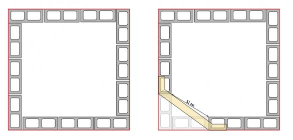

    Also, Also, theres more, I have looked at all the corner builds and I cant see one example of how to breach the gap between the two front sides. Maybe I saw photos of one when it was completed, BUT HOW DID YOU DO IT!!
    I will try to be more clear. On a normal slab you build the walls square or oblong and have access to all 4 sides, and put angle iron at the front to bridge the gap above the wood hole or whatever you may use the space under the hearth for.
    On my intended corner oven,I will be trying to bridge this gap, with angle iron at a diagonal angle and somehow the blocks will have to be cut to suit that angle, but not being blessed with such skills of inteligence, I cant fathom out how this can be done.
    Has any corner builder experienced this problem, is the gap not bridged in this normal fashion, will I have to go back to the drawing board? Will I be forever pizzaless?

    The plans above are drawn to scale to your block dimensions, ie 40cml x 15cmw. Rather than dry stack them, I have allowed a mortar joint that will bring your blocks as shown to your base dimension of 140 x 140cm. By removing the 2 corner blocks you will have a 51cm opening and getting some 75mm angle cut and welded to shape, you have all the support that you could need. If you need more room on the top for your preferred oven size, then you can cantellever it over the block edges.

      You can do a concrete arch lintel that is a monolithic pour. I just takes a little creative wood forming. There a few more pictures in my Picassa thread.

        I've placed a 100cm inside dimeter oven on this base with plenty of room for your wool insulation without having to cantellever the top
Name:	Screen shot 2013-04-02 at 9.14.29 AM.jpg
        The only other thing you will need to do is to build your entrance incorporating your transition beneath your chimney/flue.

          Many thanks Neill for the illustrations that was brilliant of you and I now know at a push I could get a 100 cm internal, although i will be looking at a little bit smaller.

          It was my intention to dry stack and fill the holes with concrete, can i still do this and perhaps mortar between the gaps.Or were you saying I had to mortar between and underneath each row.
          Is the angle iron on the 3rd row or the top. I take it I will still have to cut the blocks to shape?

              I've redone the oven at 81.3cm diameter and simply shown it's size on your footing 140 x 140cm.Also drawn the blocks stacked but you will need to consider your ideal working height!
              I am 5'10" high and my oven floor is just right to see all the hearth without standing on tip toes nor stooping, so the top of your firebricks needs to be just right for YOU!
              The angle iron sits in the top of the 3rd row supporting the concrete layer.
              You can dry stack them but the scale diagram allows 1cm mortar joints. I see no reason why not to mortar your blocks in place AND fill them with concrete if desired. It all depends on your working height as you will need at least 10cm of reinforced concrete top but your insulation layer can be adjusted to suit AND a thin insulation board can also be added to increase the amount of insulation which is recommended, you can't have too much insulation!!!!!!

                  Why not look at cutting your blocks in halves with a small diamond saw. If you cut the in halves, both pieces are useable and will raise the floor to close to your required height.
                  I would also put reinforcing rods down your corner blocks so that your top concrete can be locked into position rather than just sitting on top.
                  Don't settle for close enough, you will regret it for years to come, it doesn't take much effort to get it perfect.
