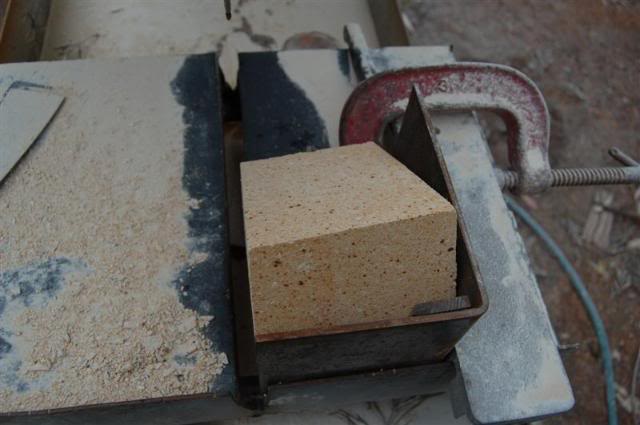

                  Hendo's approach - the brick is shimmed at the back @ the same angle of the dome course, and from the side @ 5 or so degrees, giving the right compound cut

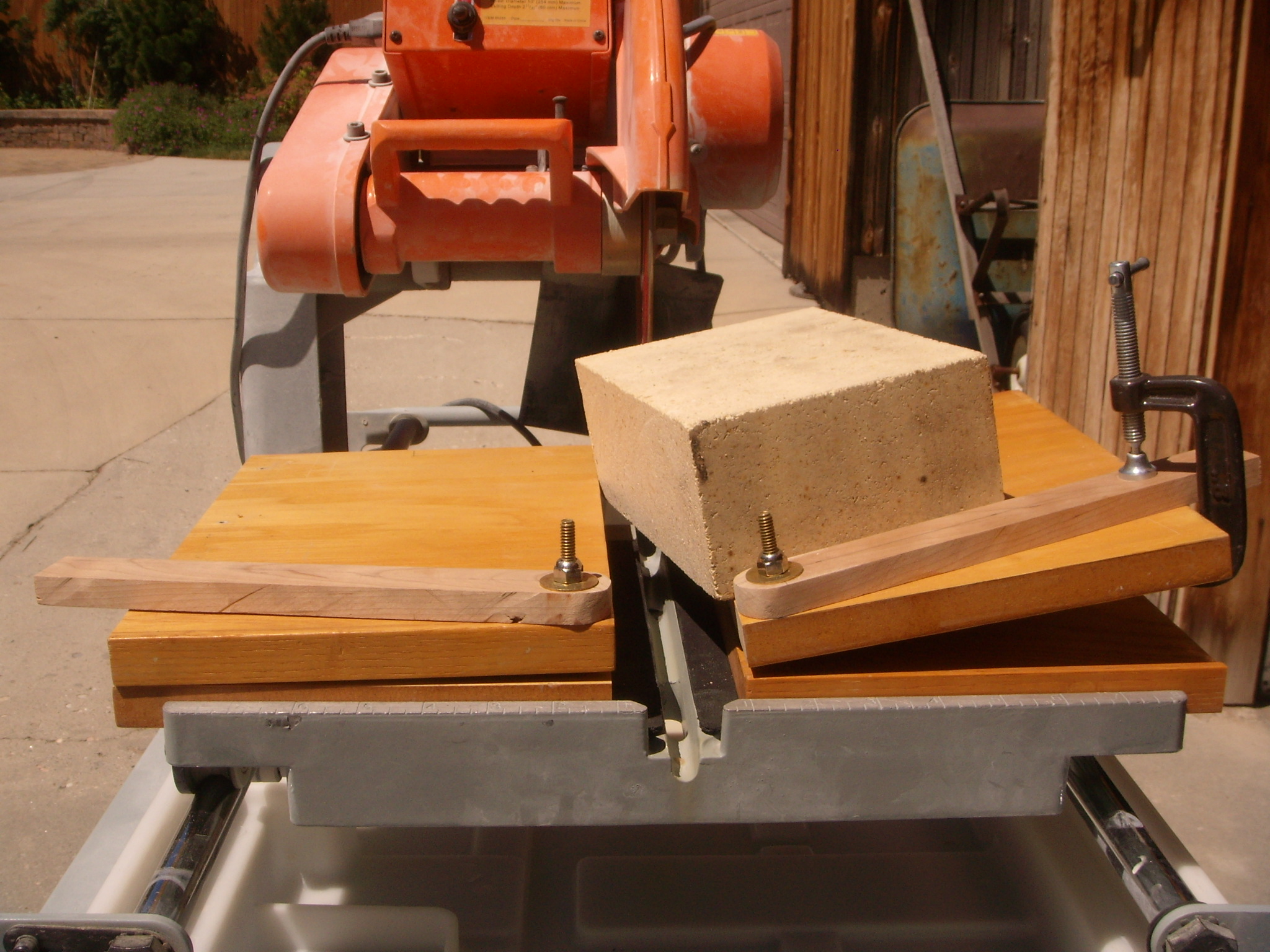

                  Russell's jig tilts the brick from the side, not from the back

                  Seems to me that both approaches can give the same final result, but the settings for the tilt will be different and I was thinking of Hendo's approach when I buillt my spreadsheet. You must be applying 12 degrees to the side tilt using the Beehive Jig and that is WAY too steep.
