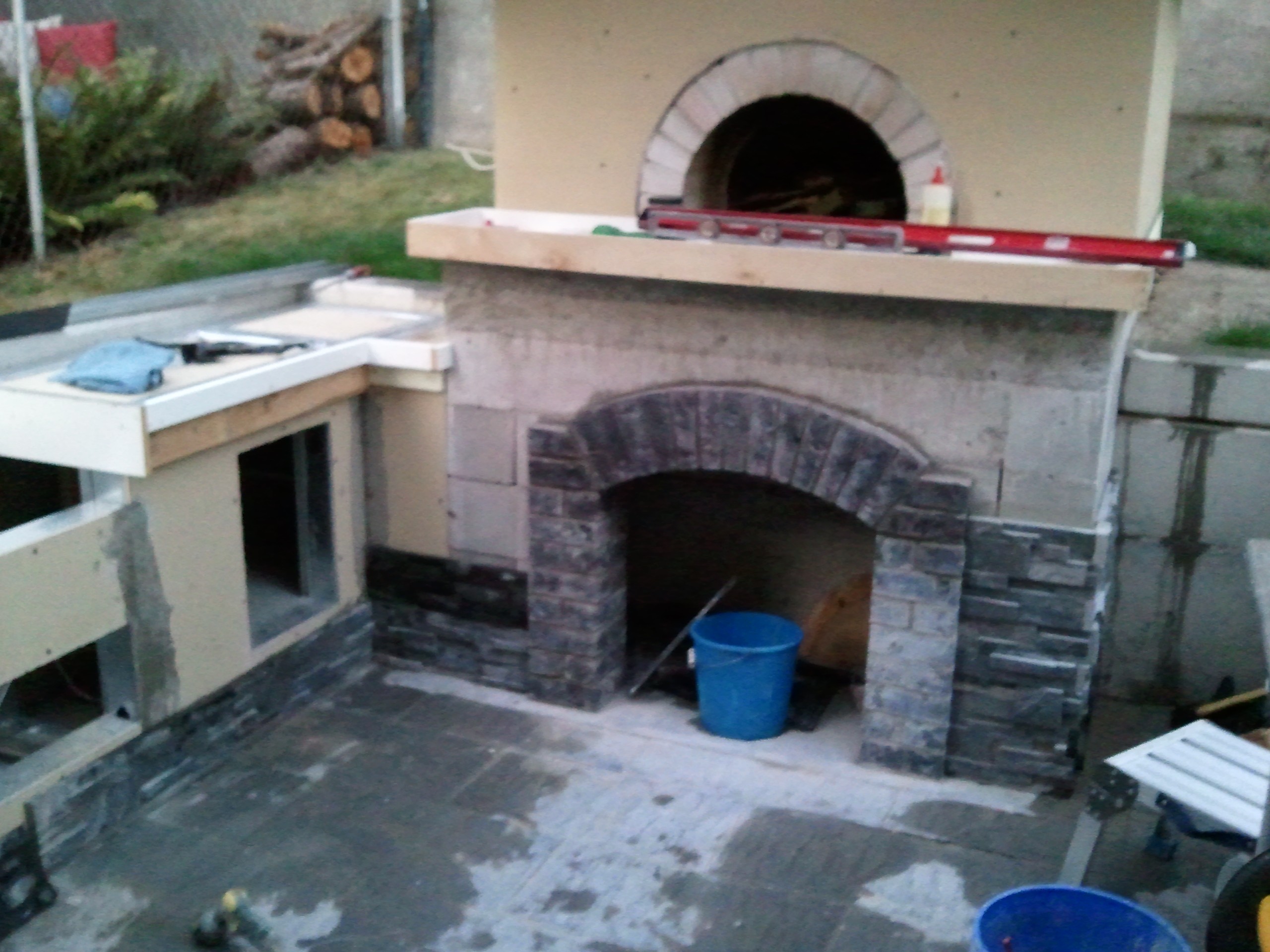

I know it's a bit late in the forum but instead of mortar I see wedges in between some of the dome bricks. Was just wondering if this was to keep the angle or use less mortar...or both. Thanks and looking great
.......I think by finishing the insulation it lessens thermal stresses and chimney adds weight to compress the arch. I think my very small crack on my arch would have been much greater if I had not taken this route
. My arch crack is barely noticeable at this point, and has pretty much fill with soot, making it hard for even me to see. This is just my opinion and conclusion of the many great theories found here on the forum.

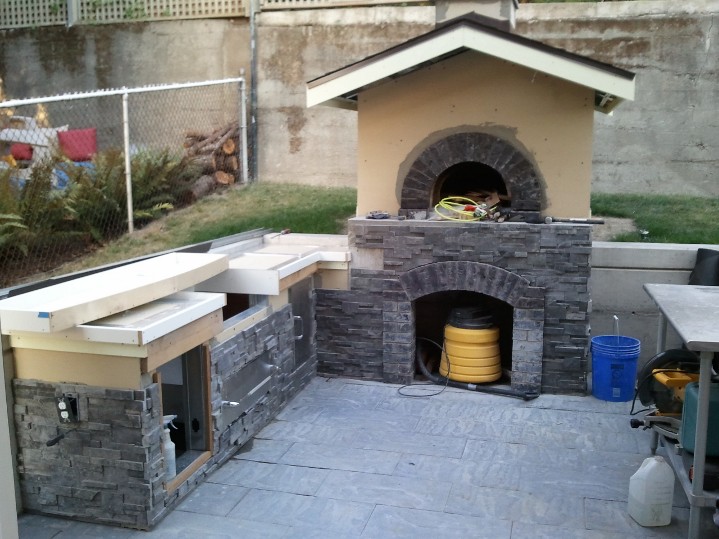

I think I'll probably start insulating this week then before I get much further in. Called a place to get the steel studs other than HD or Lowes so I think I'll take a few days off get a shell going and throw on that insulation.
