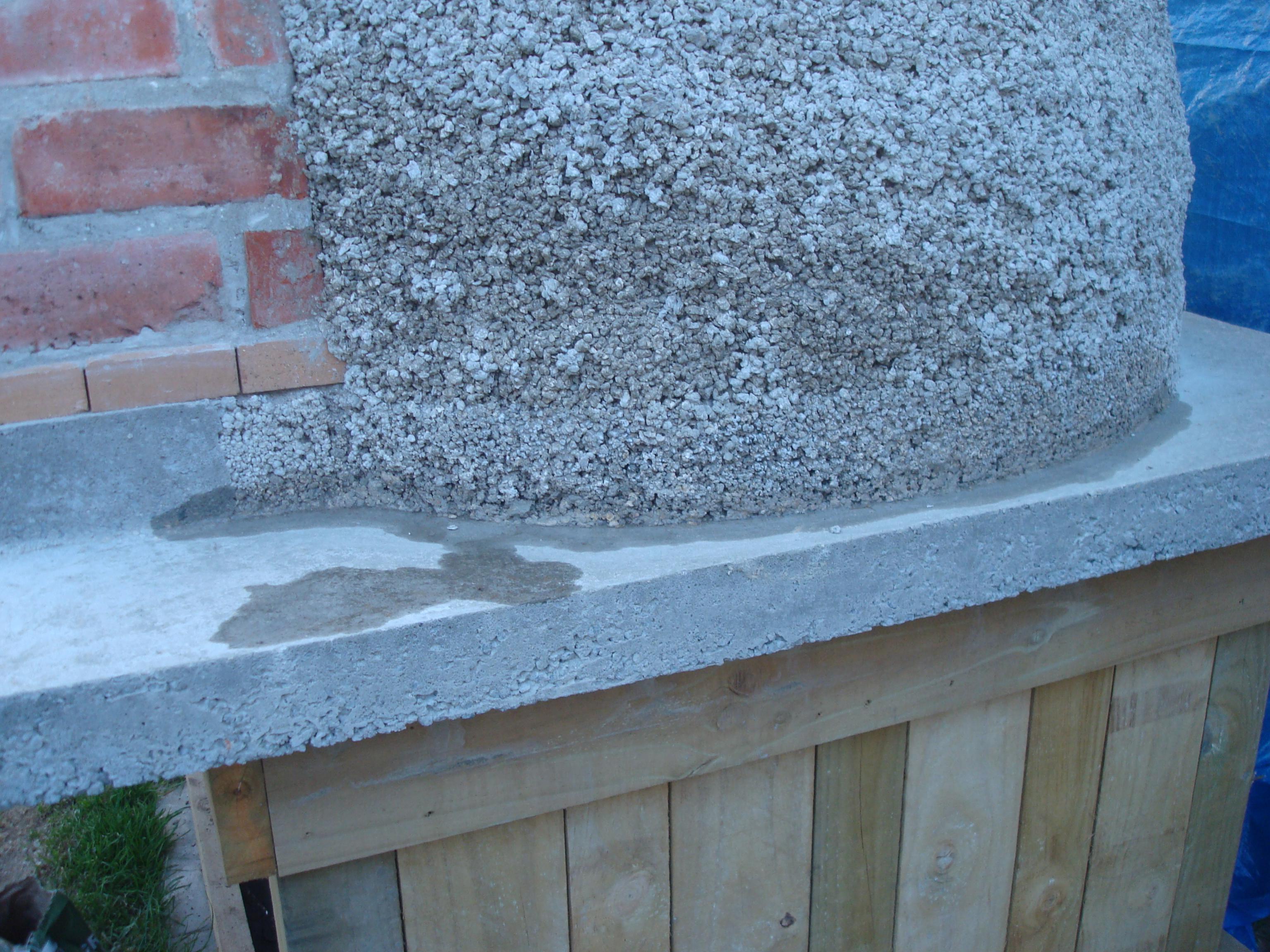

I see what you mean. Those firebrick tiles are sitting on a layer of pavers ... No room for a mortar bed is there.
You might have to lift the tile and use the angle grinder to cut a space in the paver layer for a mortar bed. Recon it would only need to 2 to 3 ins wide though.
You might also be able to trap those firebrick tiles in with some tile on the front face of the slab. This would be dependent on what you want finish the edge of your slab with I suppose.
I hope something here helps
