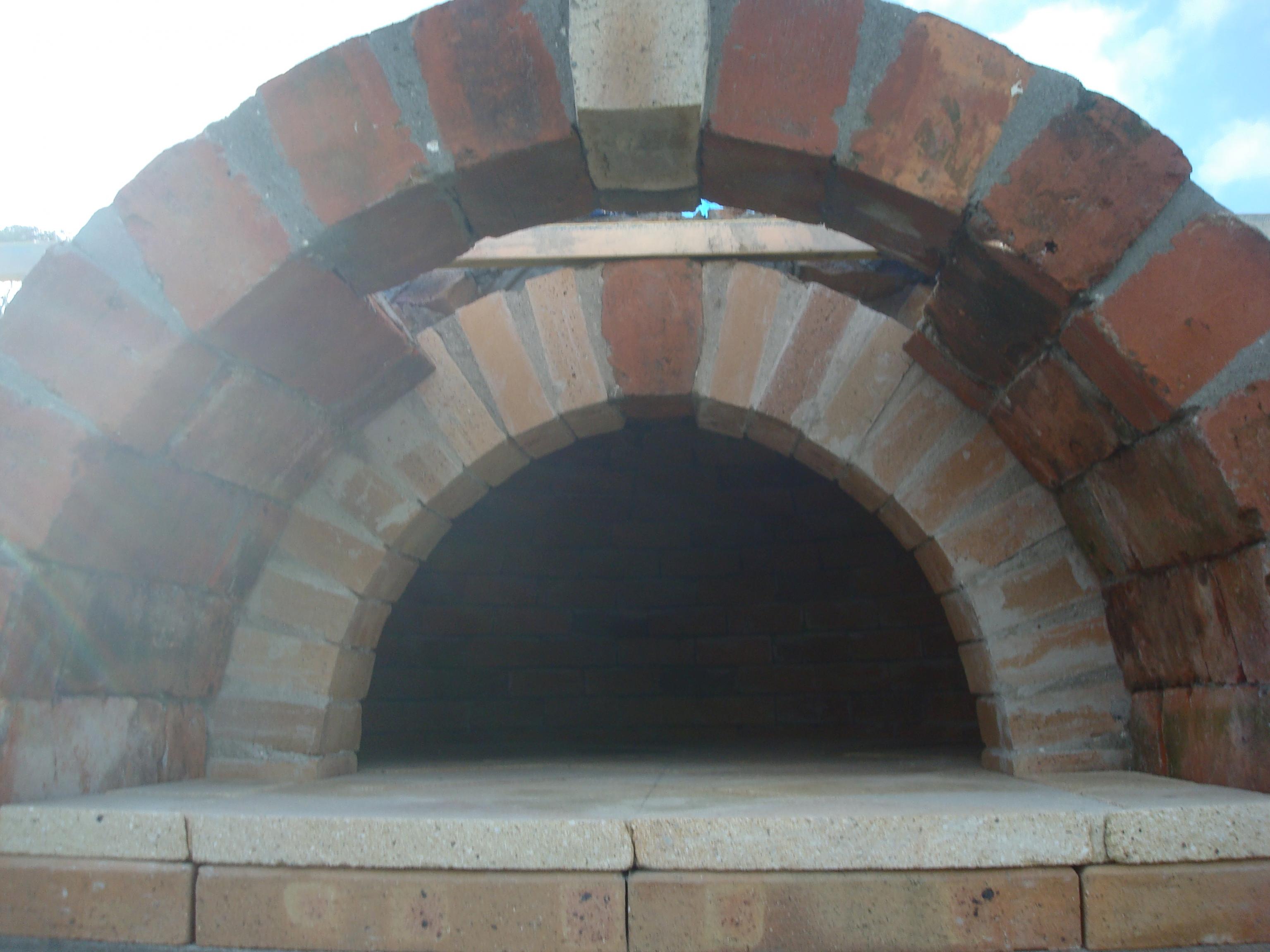

    Gudday Bevan

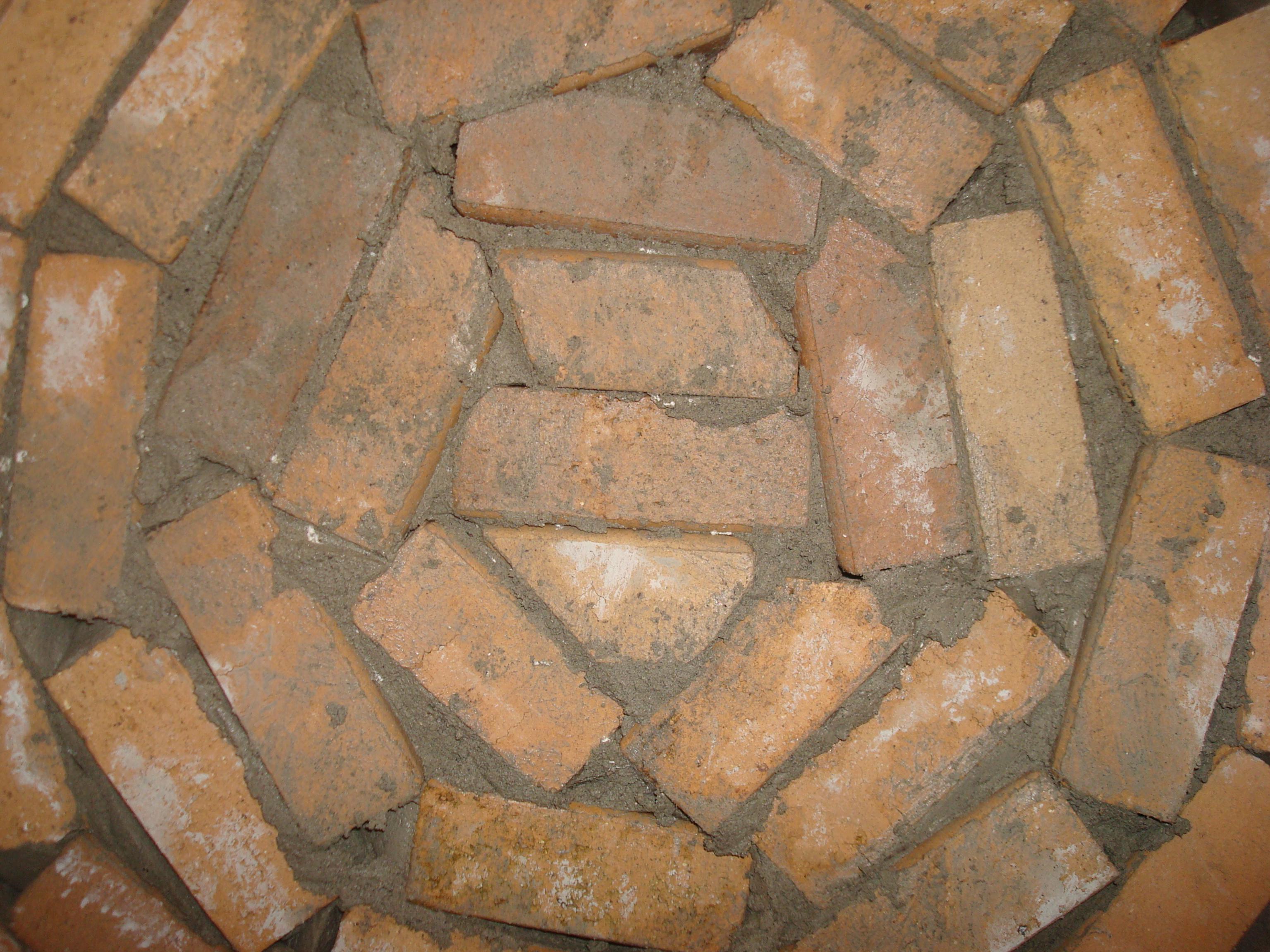

    Looking great! I'm particular taken by the pics of the oven inside. Because of the thinness of the pavers hardly any great gapes. Not like you would expect with full thickness brick! I've seen a paver/bulster built oven and I know the gapes at the top would have larger ones but its not important. If you had to tap your last keystone's in with a mallet they should be tight enough.
    Sorry to hear that the blow up ball was a pain to use , I'm now of the opinion that it would only be of use in say the last 2? Rows. What do you recon?
    Good idea to use those bricks to force the sides up by the way.
    I noticed 2 bricks hanging around in a few pics is it those, or are you planing to use your antique bricks as a feature on the entrance?

      Yeah, I think I switched to the exercise ball too soon and should have suffered with the IT another couple of courses. It's because I am impatient in case you haven't noticed lol. It would have been fine for the last couple of courses. Also the ball size makes a difference too. I went with a 75cm ball. Someone else I read about used a couple of different sizes to get the job done.
      I think they pavers do make it look better than it might have looked using full sized bricks (because of my chosen building method with limited cuts).
      My plan is to use the red bricks for the front arch. If they don't work for some reason, it would be no biggie to re-do it with pavers or better bricks down the line. I just like the look of them.

        I did get some large gaps at the top of the dome. I am pretty embarrassed to post a photo and I wasn't going to, but it's not fair to only tell half the story . Should work ok though.

          The top bricks are are .... Nice and workmanlike!!!!

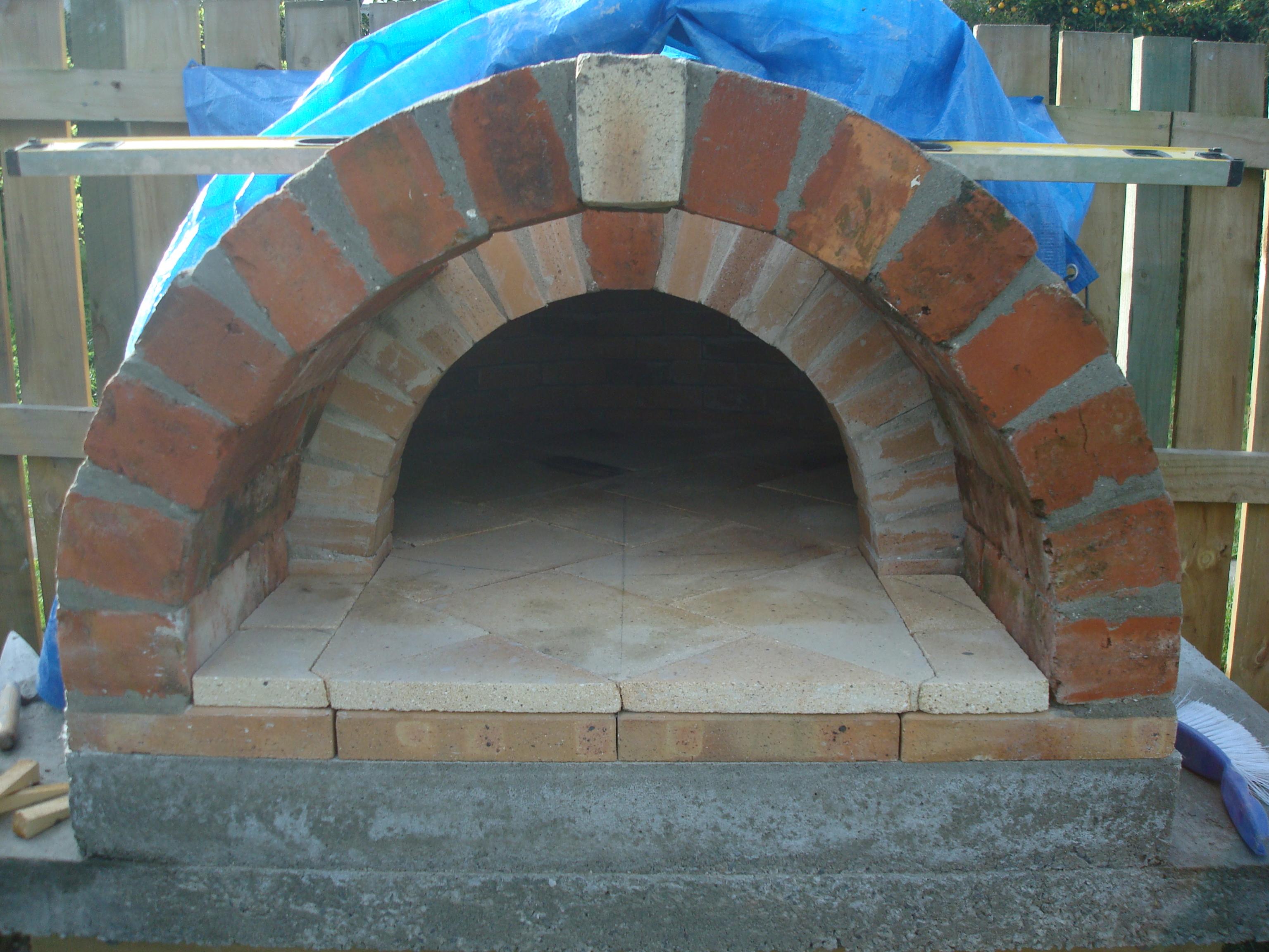

                  #128
                  Re: Budget Build 36"

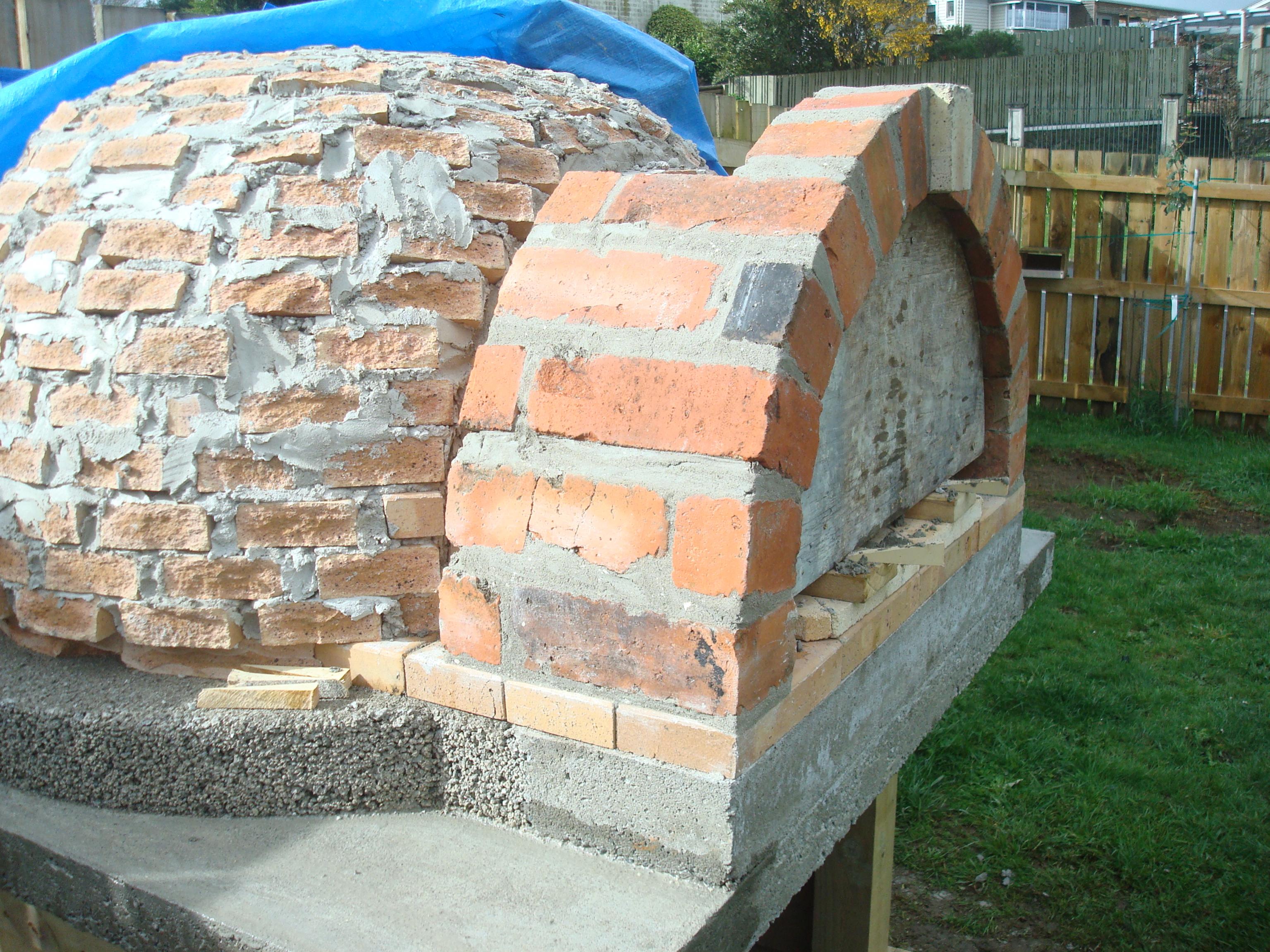

                  I managed to get the outer arch today. I was hoping to get the chimney done also but I am a bit challenged by the vent transition. I am pretty limited with my cuts by my grinder. I really need a lip incorporated into the base so the flues have something to rest on. Then I can build up the brick chimney around them. So I will try and hatch a plan tonight.
                  Here are some photos from today, again, pretty rough but hopefully functional. I do like the look of the old bricks but the irregularity of them was a bit of a PITA.
                  Cheers,
                  Bevan
                    #129
                    Gudday Bevan
                    I have looked at your pics a coupla times now. Nothing earth shattering comes to mind but you'll have to do some fancy cutting with an angle grinder.
                    As far as I can see might be best to use the entrance arch to rest the rear of you chimney on , its an arch buttressed by your dome, why not.
                    As for leaking heat forget that its not important the hot gases exiting the chimney will heat it and it will not suck the heat from your oven as it is already hot.
                    By the way I do like the look of your entrance with the antique brick and the shape is true to your original look that you wanted to achieve
                    Regards Dave

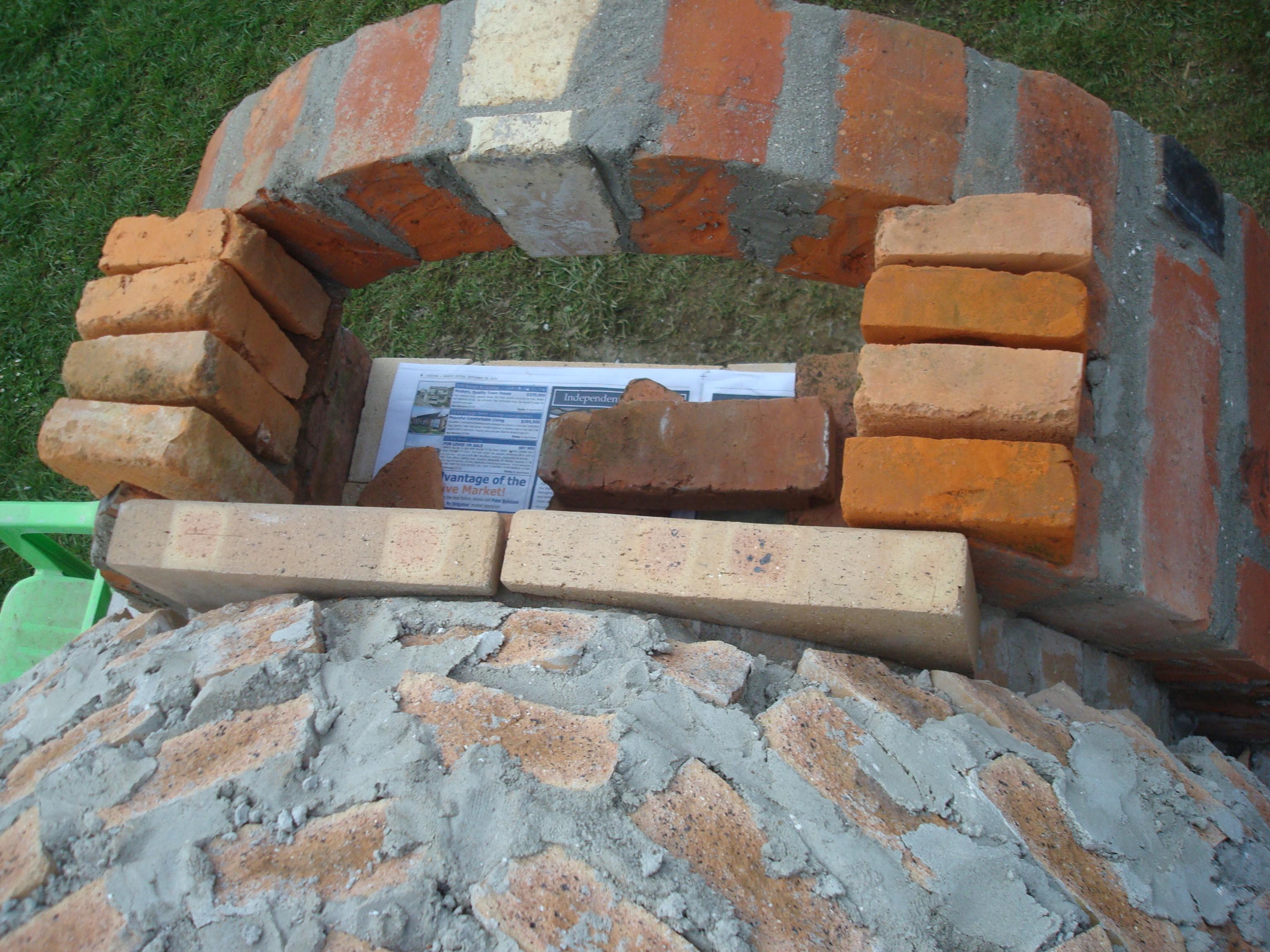

                      #130

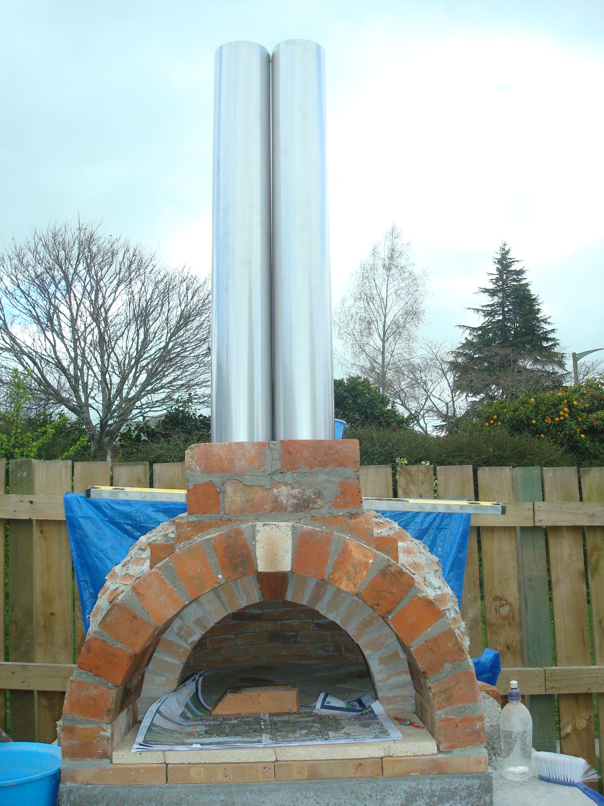

                      Just a quick update to show what I mocked up this morning. Basically the half bricks didn't have the solid foundation for the flues that I wanted. I popped in the flues for a trial fit and a gust of wind knocked them down and part of the chimney. Granted the mortar hadn't been on long, and was possibly too dry also.
                      So I took all the chimney brick apart and will try using full bricks this time. I was worried that the look of the full brick chimney would be too large and out of proportion, but after seeing those twin flues, I think a bigger chimney would look fine.
                      I have abandoned the idea on the 45 degree cut on the top of the flues as it is to difficult for me to do. I don't want to mess them up trying to get too fancy. And besides, it just took me over 30 mins to drill 4 holes in the stainless to rivet the flues together.
                      I was planning on taking the chimney brick another 2 courses, just wanted to make sure the flues fit first!
                      Cheers,
                      Bevan

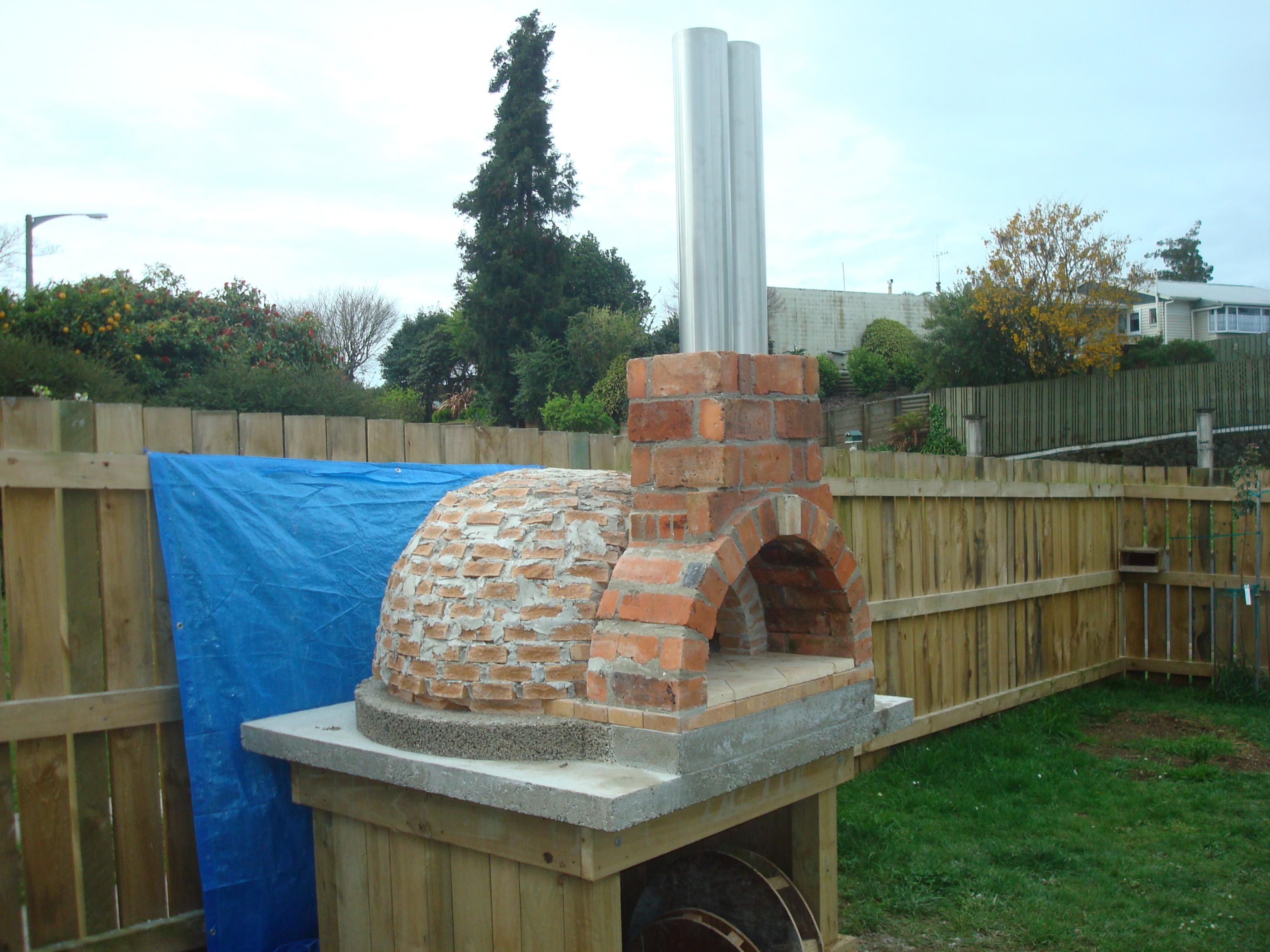

                        #131

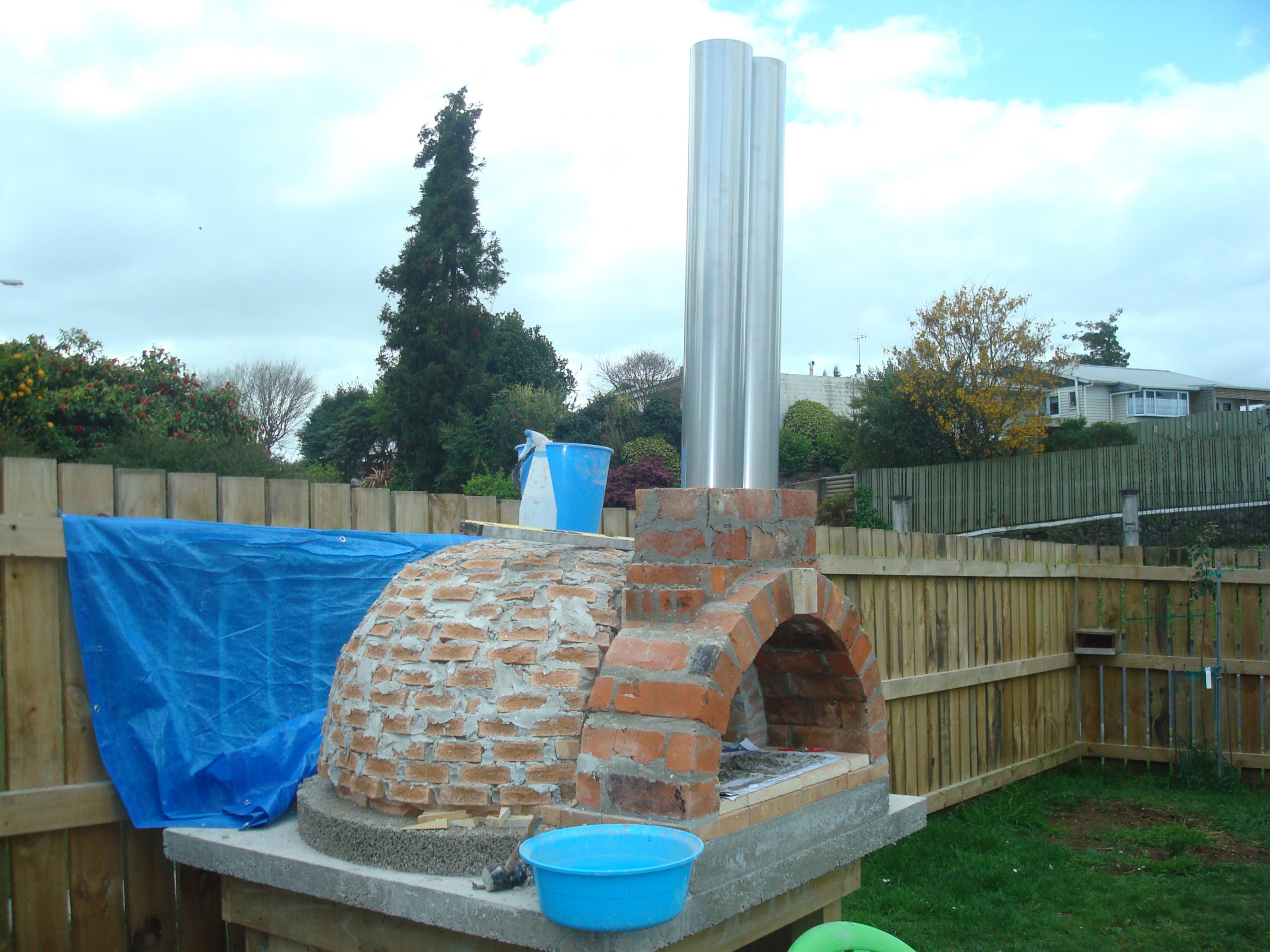

                        Just an update to show chimney rebuild
                        Bevan

                          Nice work. Are they the chimneys of other WFO's over the fence too?
