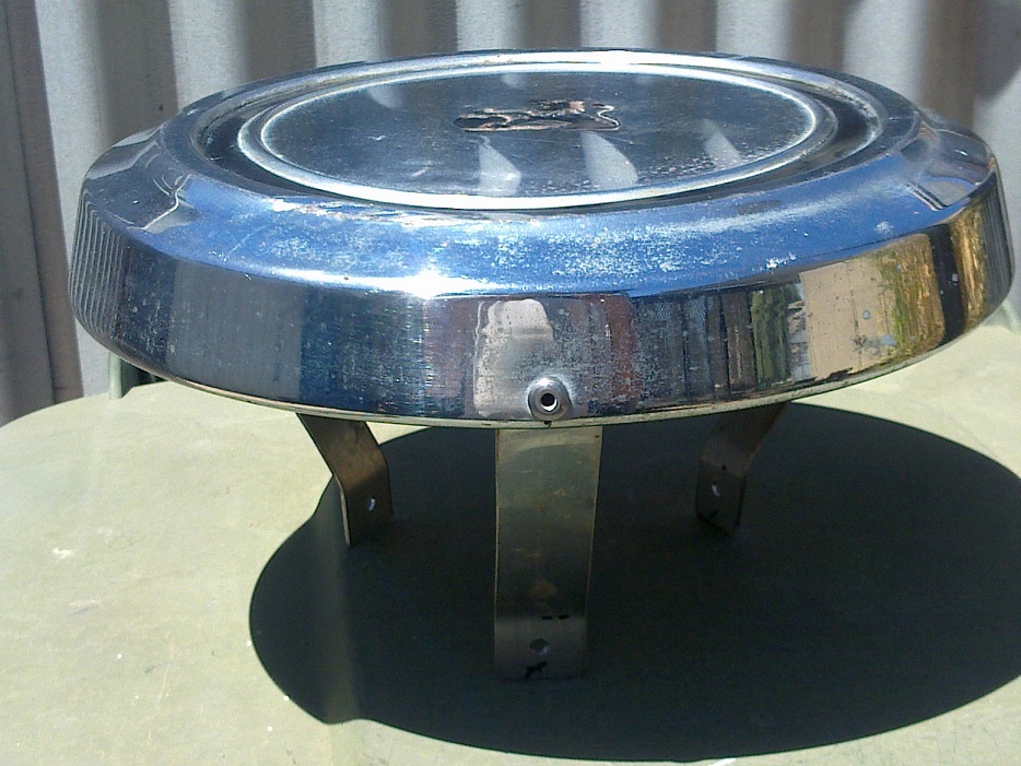

Gudday
Thought you'd like that . You could configure the side by side if you like like that with flat tops as well I suppose.
Rain excluders can be pretty fancy ( and expensive) but you can use a clay pot plant base and just slip it over the top there usually heavy enough not to blow off. If fact that could be a temporary measure till you find what you want.
I'll have a look to see if I can find a pic of another I have seen. It's like the rain cap on a vertical truck exhurst excepts it has a chain to lift and hold it up looks pretty cool and i recon easy to make as well.Measure twice
