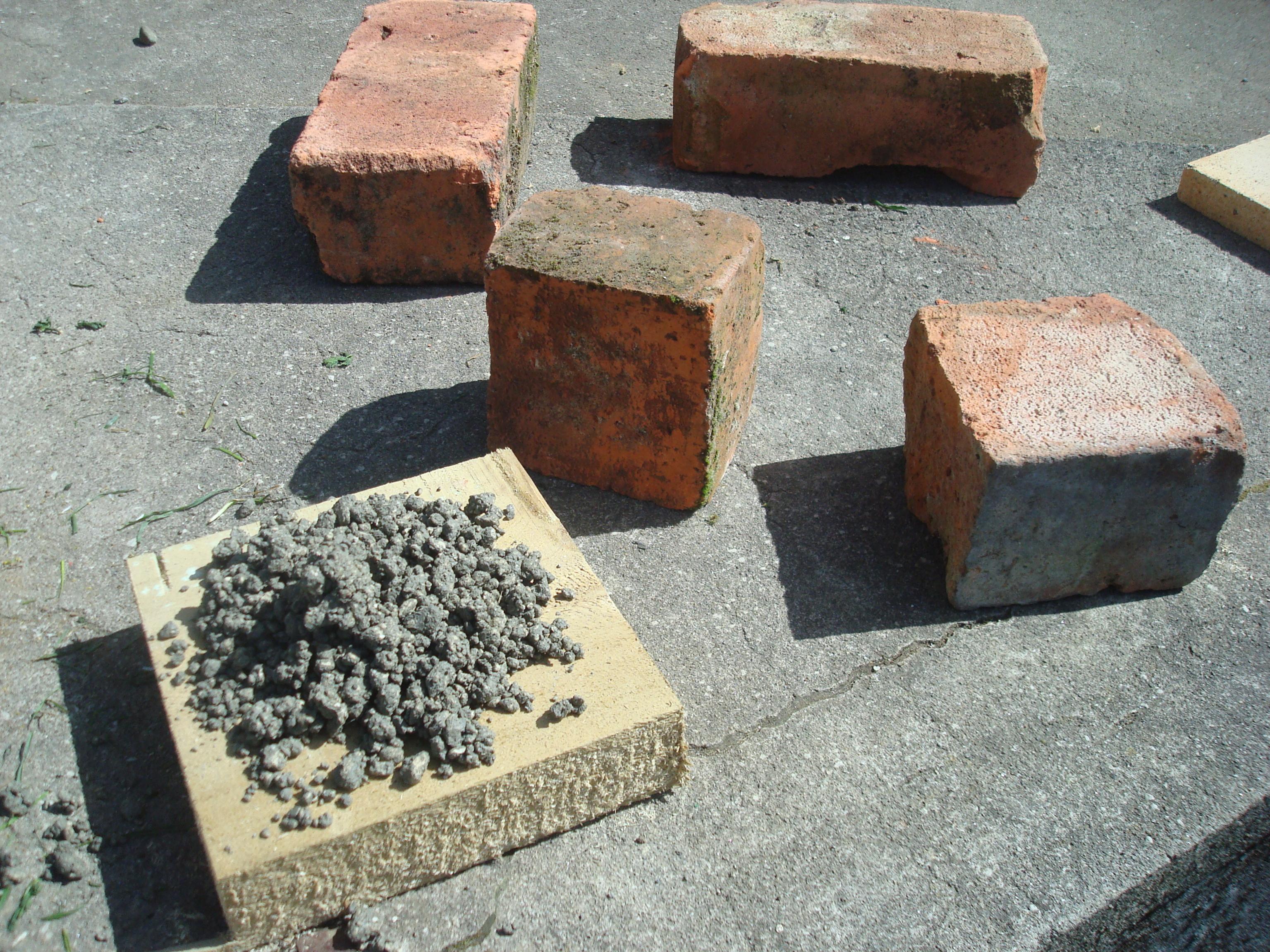

          I mixed up a 10 to 1 pumice/cement mix this morning to see if that will be enough to hold together for the floor insulation. I was able to pop it out of the cup I used for a mold after about 20mins.
          It is not baking in the sun and after a day or so I will put a brick on top and see if it holds.
          Photos for those interested:

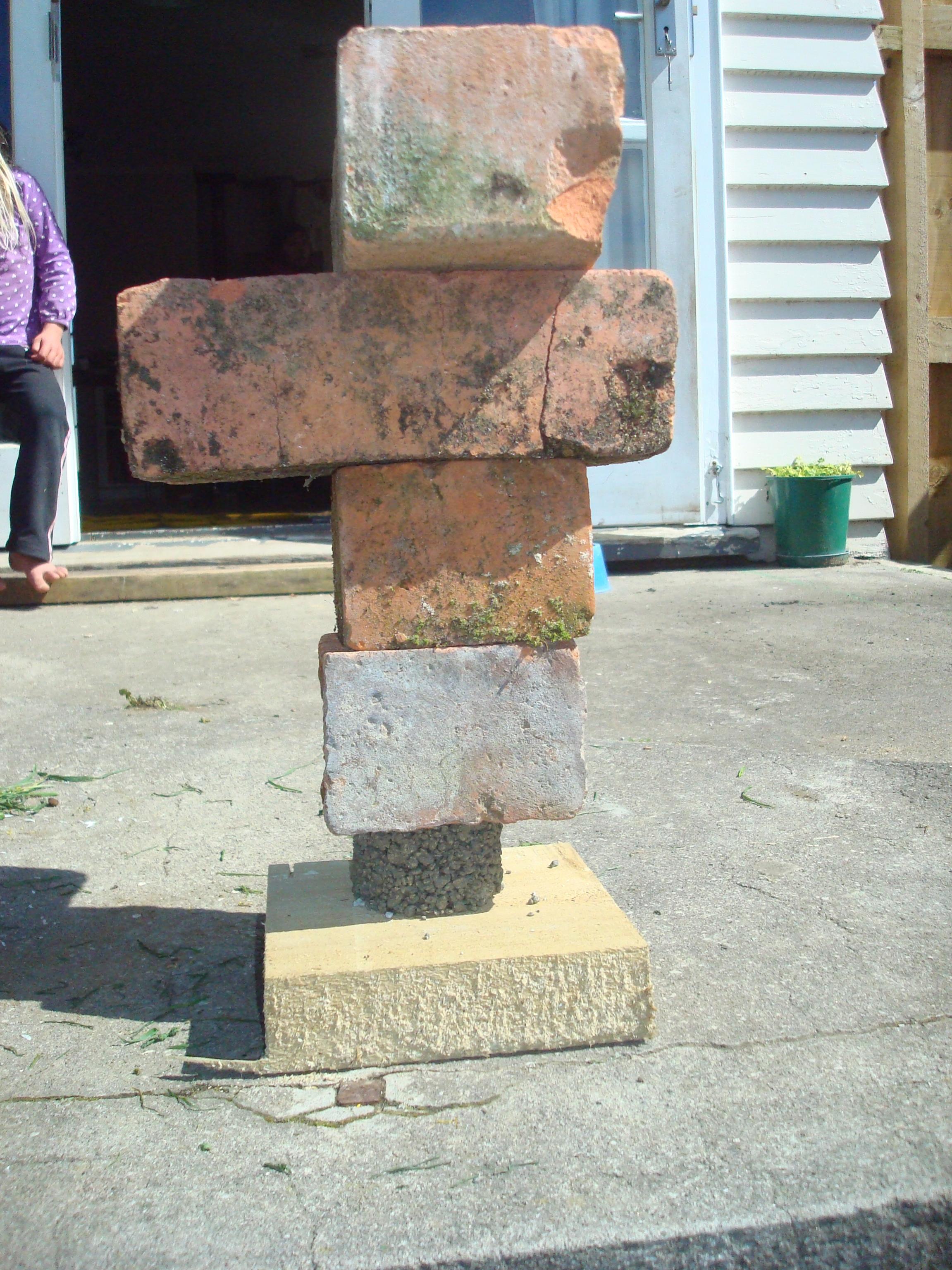

            Ok, results are in. I tested the insulation compression with bricks.
            This test was done 90 minutes after mixing.
            The puck of insulation was about 3" wide by 2" high.
            The puck held 3 full bricks for about 2 minutes before it collapsed. the last brick was too much I guess.

            SO based of the very short time period I allowed, do you think the 10/1 ratio is sufficient?
            Thanks,
            Bevan
            • #51
              Re: Budget Build 36"
              It only failed because it wasnt contained, if it is contained in a structure then it wont fail.

                      With vermicrete the usual mix is 5:1 to make it strong enough. I would assume that you would need the same ratio with pumice. 10:1 vermicrete is fine for insulation over the dome but not enough strength for under the supporting slab IMO, unless you have structural concrete containing the sides.

                        I would also up the chocalate to rice bubble ratio to 1:5 and be patient and let it set. A row of bricks on the slab will give you a containment edge but again let the concrete slab time to cure give it a week.

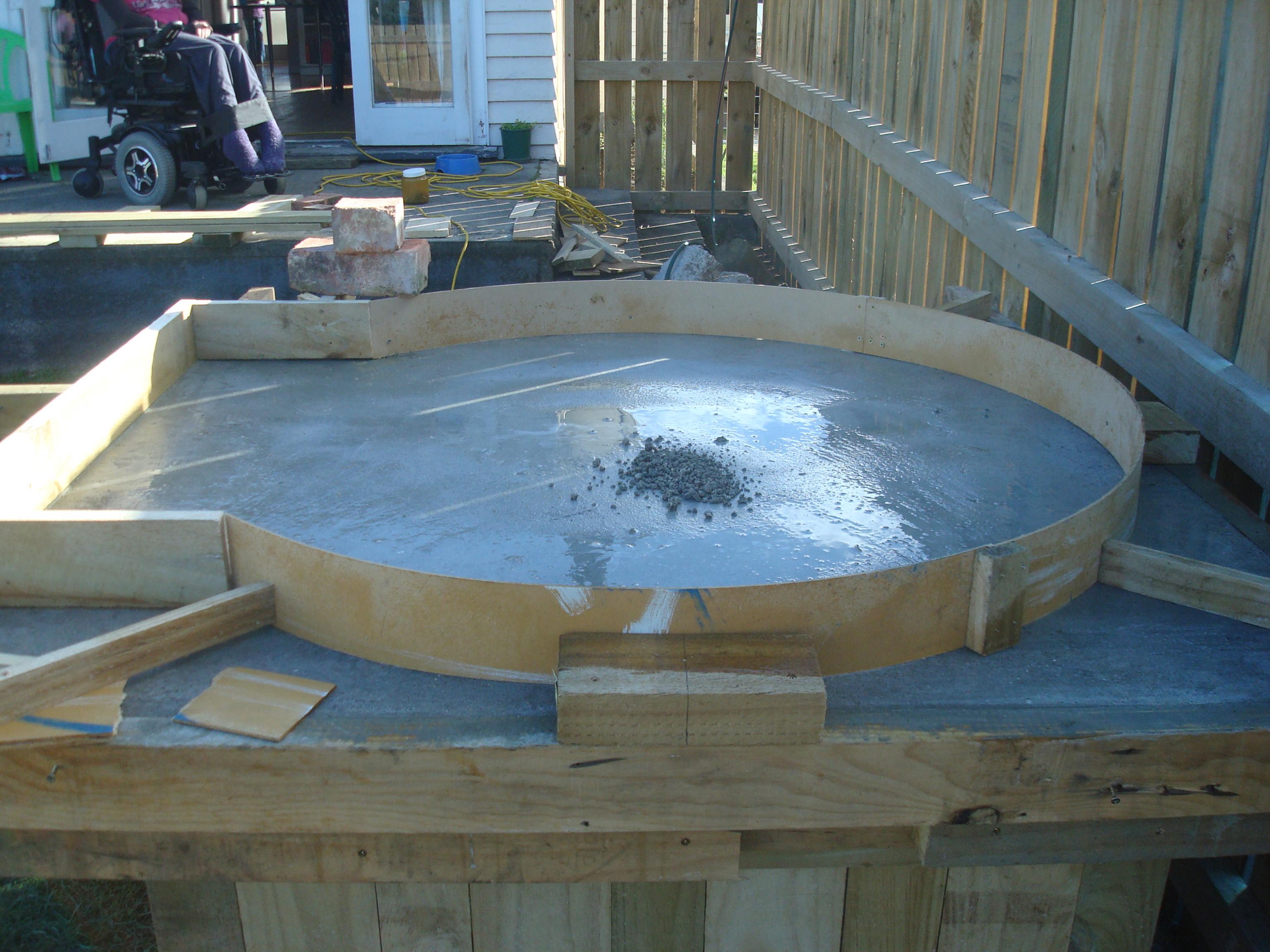

                          I have the form done this afternoon and was going to do the insulation layer tomorrow and let it cure for a week with the concrete. Is that a good plan or do I need to leave the slab alone for a week before insulating?
                          Thanks,
                          Bevan

                            Sorry Bevan went to default settings there, I would always leave concrete a week to cure before doing anything..,but. Thinking about it you got the form in place and its not a heavy layer, why not!!!
