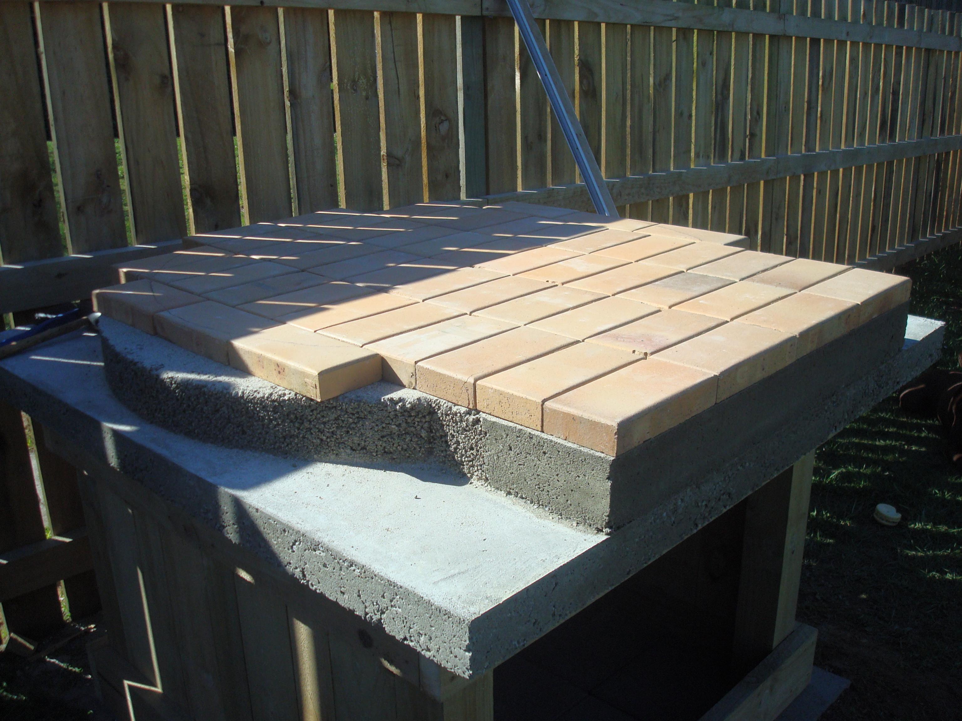

I got the insulation layer all leveled out with sand and then layed the pavers.
Then I put the fire tiles on top to try and work out which pattern to go for and also if I should put the dome on the pavers or the fire tiles.
I think I should probably use sand/fire clay to set the fire tiles onto the pavers.
Cheers

I used clay pavers underneath my fire tiles too, my tiles are 40mm thick.
The only problem I have is that a few of the fire tiles have cracked because I chuck huge logs into the oven.
They will still perform the same, next time I would use thicker tiles.

If you have ever tried to replace a single paver in a driveway its bloody hard to get it in. You got to either remove a lot of pavers and relay right to an edge, or trim a mm of the sides so you'll always have a loose paver
The adjustment that you see on most ITs is to gradually make up for the inch or two that the pivot point is above the hearth surface.
So placing on a ply piece is a good way to go and you have the added advantage that it all protect your hearth from the inevitable drips of mortar. Cut it into section small enough to fit through the entrance and screw together with battens
