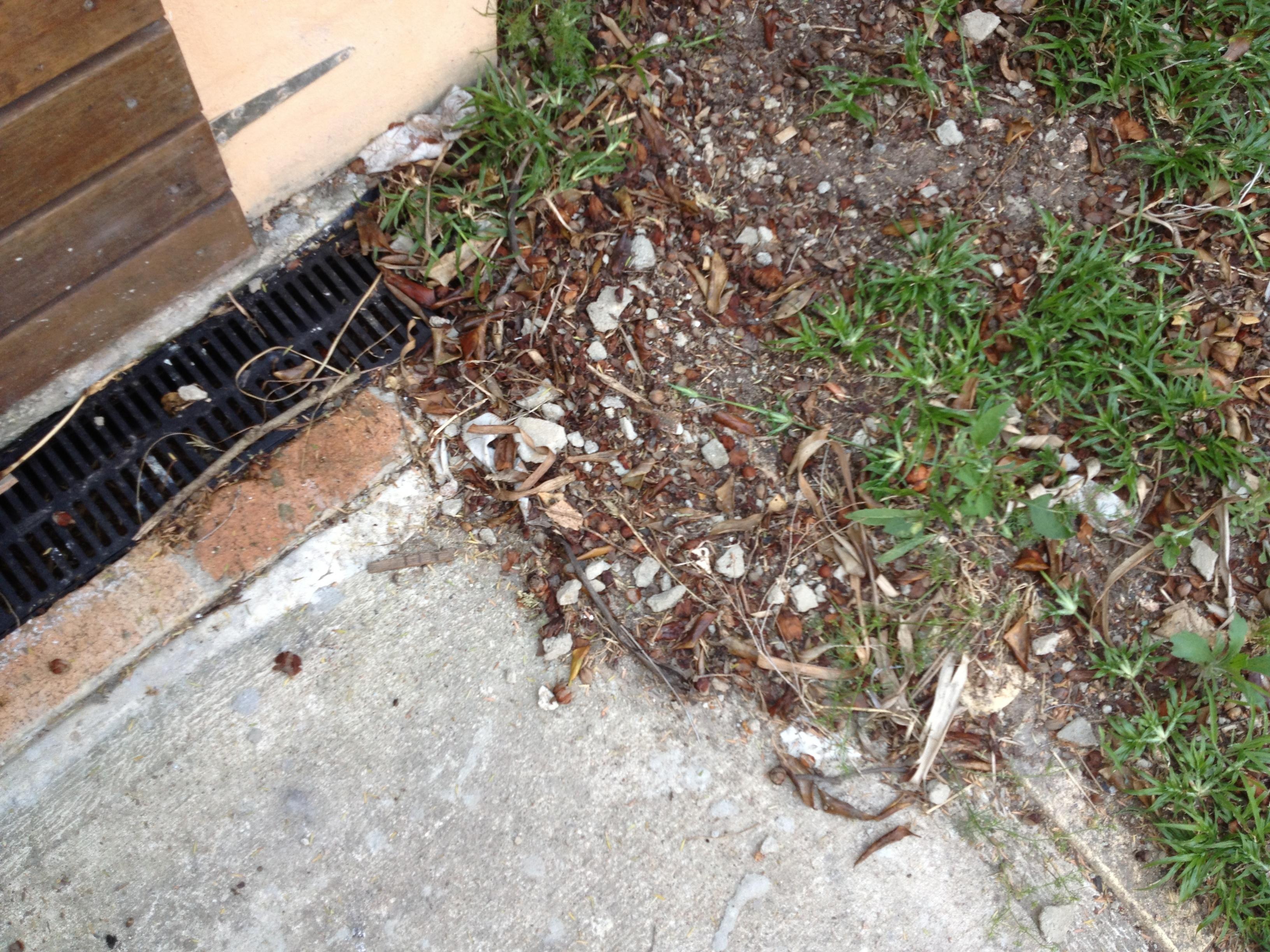

                Gudday
                Looking at the pic of the stand with the cement mixer in the foreground.
                You slab is about the same height as the surrounding ground. It also appears from the pic the oven is on the low side of the yard. If we have a good storm or a big rain day like last Australia's day the stand could fill with water.
                You might add a extra layer of builders plastic on the top slab under the insulation layer for piece of mind.
                I thought mine was high enough till it got flooded last Australia Day, and trust me a wet oven and stand takes forever to dry.
                Spoon drain after last nights storm
