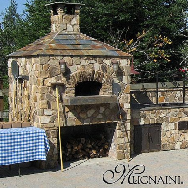

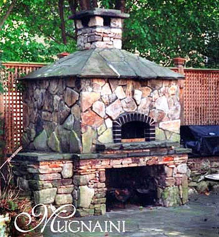

                This is why I stick with HVACR for a living (hence the user name). He said he could build the roof out of anything I wanted. Something about stepping in the block? I don't know here is a pic of what I'm looking for

                  Re: Enclosure
                  Ok, got it. That's called a hip roof and what he's talking about is corbling the block. I'm not sure why he would do that when the roof could be framed, sheathed and shingled with anything.

                    Re: Enclosure
                    Then will frame it thank you!
