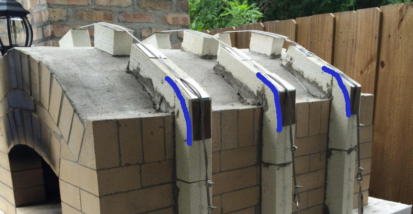

        • Making some progress, my buttressing drama is now over! Thanks to Mr Chip! I have the perfect solution, which will not ad any mass to my WFO and it is not going anywhere. See images below. Thanks for this chip, I owe you one... :-)
          Best Regards...
          Gugahulk!

            Looks great,
            The only thing i would have done a little differently is to round off the corners where the cable goes from the wall to the ceiling, This would distribute the load a little better and not be such a point load on the brick.,
            it looks like the stainless worked out fine, and it appears that you have done several curing fires. Has anything been cooked during the curing fires?

              Thanks Chip, I wish I had more time but it does not stop raining here. rain every single day. I have done a feel fires but it still feels moisture inside. I did get a hairline crack on the front of the oven but I should be find. I am still making little fires. The oven stinks like wood burned fire. Is that normal? Everytime I put a little fire my hole clothes stinks and so does my hand.... LOL Could I have been burnning the wrong kind of wood? Is my wood not seasoned enough? Also since I am making only little, little fires my dome is completly black on top and all sides. Once I fire it up for real will it all clear even though it being accumulated from all my little fires? I am starting to work on the chimney and front of the oven. Any advice?
              And no cooking yet. I feel like my food will not taste so good as the smoke is tremendous coming out of the oven. And overwhelming smell of burn wood.
