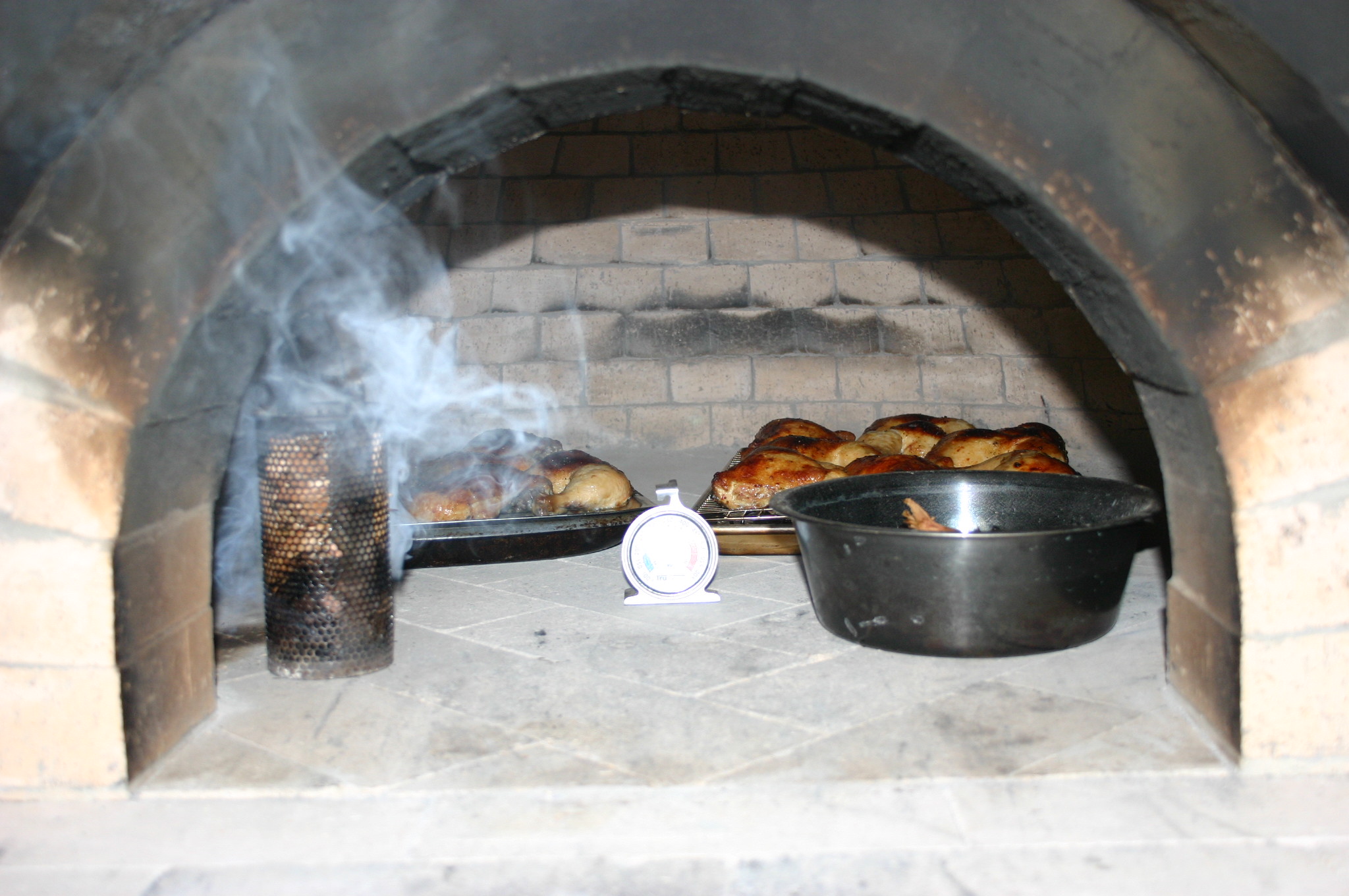

    Delicious looking ribs, GHulk. Great! smoke ring. They do look moist and tender. Spares were $1.98 a pound this weekend, so there was no baby backs for the Fourth this year.
    I've played with the oven for smoking a little for adding some smoke flavor. Using the oven's residual heat for the temp and using some smoldering chips. This is an old pic of some cherry chips in a ss basket. In the ss doggie bowl is lump charcoal with onion peels.
    I have to leave the door backed off to keep the smoke moving. I've had a little better results smoking in the entry, but I haven't got any pics of that. I've played with using the left over lump from heating the oven and larger preheated chunks with mixed results.
    My best results for the oven with ribs, briskets, and roasts has been to use the oven for finishing. Not for smoking. Saturdays ribs were smoked on my offset grill at 220 to 225F for 3.5 hours. I then wrapped and placed them in the WFO at about 300F for a little over an hour while I cooked the chicken on the Webers. The spares turned out pretty darn good .
