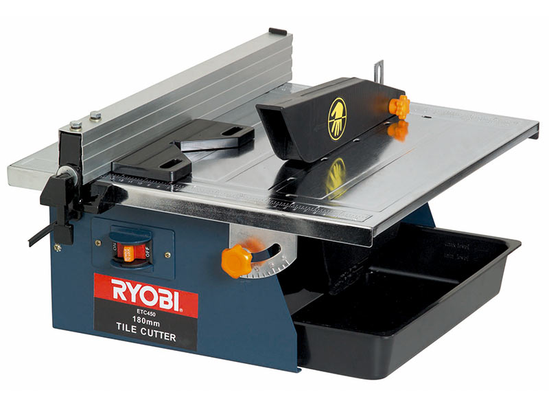

                        Hi Tommmo,
                        Just noticed your comment from a year ago or so. This is the Tile Saw I used.
                        Your build is looking good!!
                        Cheers,
                        Matt Click image for larger version
