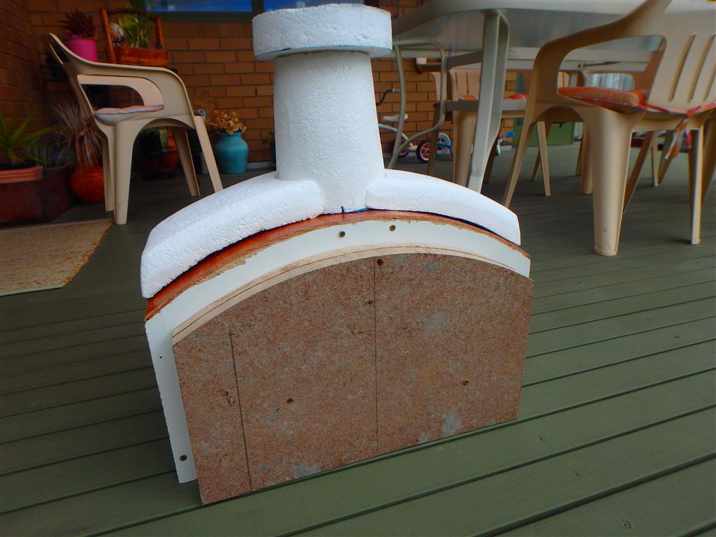

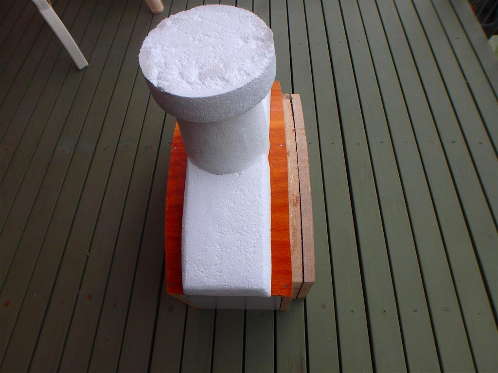

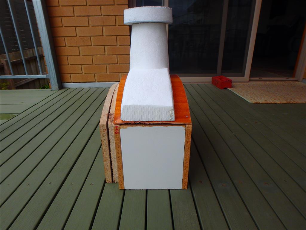

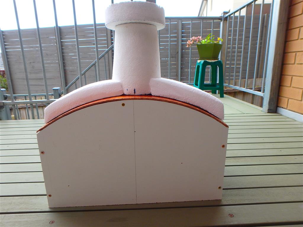

                          Hi David, following your advise I undertook to build the flue galley in polystyrene - photos attached including front and door opening timber formwork. I have made the venting recess 40mm high as opposed to 30 in my design. I intend on using a threaded rod to hold the tapered cylindrical recess to aid removal following cast and removal of front arch. The venting recess pieces I can hold but I am having trouble deciding how to remove following the casting - any ideas?
                          I understand from your previous post 40mm thick castable is quite strong. Is it possible to decrease to say 30mm around the flue gallery/venting recess? Currently I have 50mm vertical at the door and 40mm around the flue gallery and venting recess. I would appreciate your thoughts.
                            #28
                            Without an outside mould I'd be worrying about trowelling against that mould near the top section without it slumping off. As suggested previously it would be far easier to cast the flue gallery separately. You could lay it on its side with a sand mould for the bottom half. 30 mm is ok, mine is thinner than that, but as you observed I have added buttressing where it needed some more strength.

                              Thanks David. I had anticipated casting issues with vertical/near vertical faces hence I propose some outside formwork. Also I am planning formwork at the front entrance so in effect it will be like casting a concrete structure with formwork surrounding it for the majority of faces. An open plastic bucket is the outside formwork for the flue gallery in combination with the internal polystyrene. I would prefer to cast the whole oven in situ at once. What are your thoughts. Please refer to attached for explanation.
                                #30
                                That looks like a workable solution, but it may be a bit tricky loading in the mix between the bucket and the inside polystyrene mould. Use a stick to work the mix into the space a little at a time. I've PM'd you my solution
