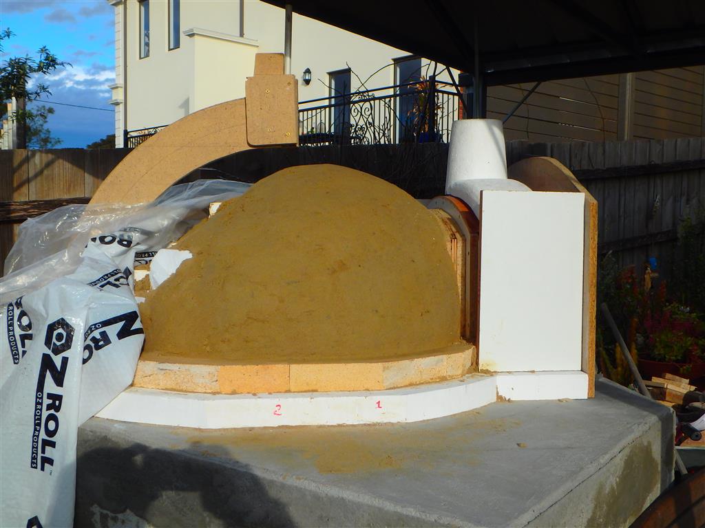

            My drawings indicate "refractory pavers" they are in fact refractory tiles 305x305x50mm.
            Yesterday I started to shape the dome with polystyrene blocks for bulk volume and wet sand combination adjacent to front entrance formwork. The done has been covered with plastic sheeting to prevent the sand drying out overnight. Today is very windy and I decided to postpone works to prevent sand drying too quickly.
            The questions I have are:
            1.How wet should the sand be during application and is it best to maintain it wet/moist until the dome is cast? I intend to use wet paper on top of the sand prior to casting.
            2.Is a temperature gauge with a 300mm probe best to be installed during casting or is it best to drill a hole into the dome and fit the gauge during the render or pericrete layer after casting in order to avoid any possible damage during works.
            3.Where is the best location for the gauge in view of protruding probe restriction to dome internal area?
            Attached are progress photos.

              #36
              Hi David, this is the almost complete "sandcastle" and general formwork. Possible pour during weekend.
              Any advise on maintenance of the sand surface until then and any other comments?
                #37
                Cover it up so the surface doesn't dry too much.
                Try a spray bottle and water. Cover the surface with strips of wet newspaper trying to avoid any folds, before applying the mix.
