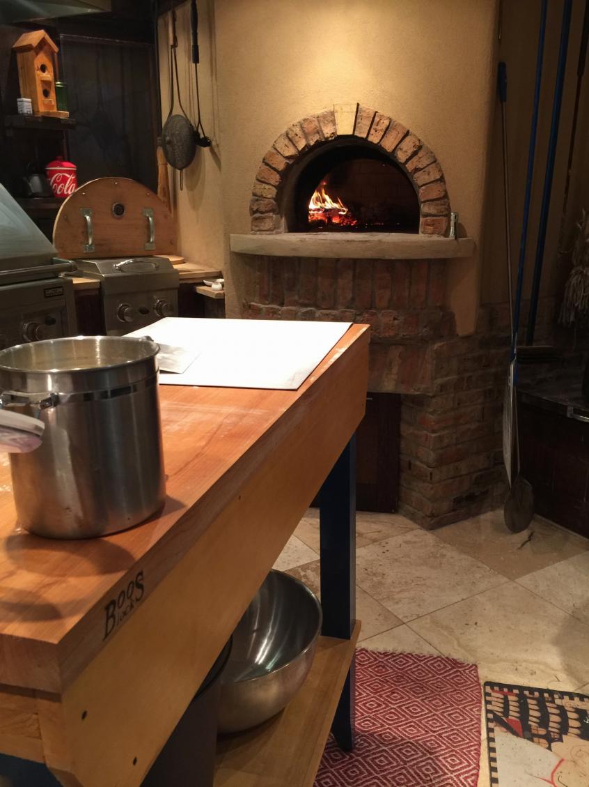

                    here is another take. Click image for larger version
                    Texman Kitchen
                    • #11
                      Good to see you online Texman
                      My build progress
                      My WFO Journal on Facebook
                      • #12
                        Been awhile DJ. Glad to see the familiar names out there. Must be a thousand more ovens out there by now. I don't suppose someone figured out how to make them build themselves yet, have they? I saw Gulf is still active, but i havn't had much time to poke around yet. Congrats on the Il Pizzaiolo!
                        Texman Kitchen
                        • #13
                          +2 on "Good to see you online Texman" . I'm glad to see that you are still enjoying the fruits of your labor. The oven looks great and the pie looks delicious.
                          Russell UtahBeehiver is also very active, There are several others that you will remember. It would be great if you would visit more often. There are folks joining every day that could use some advise or just a little look at what you cook in the oven.
