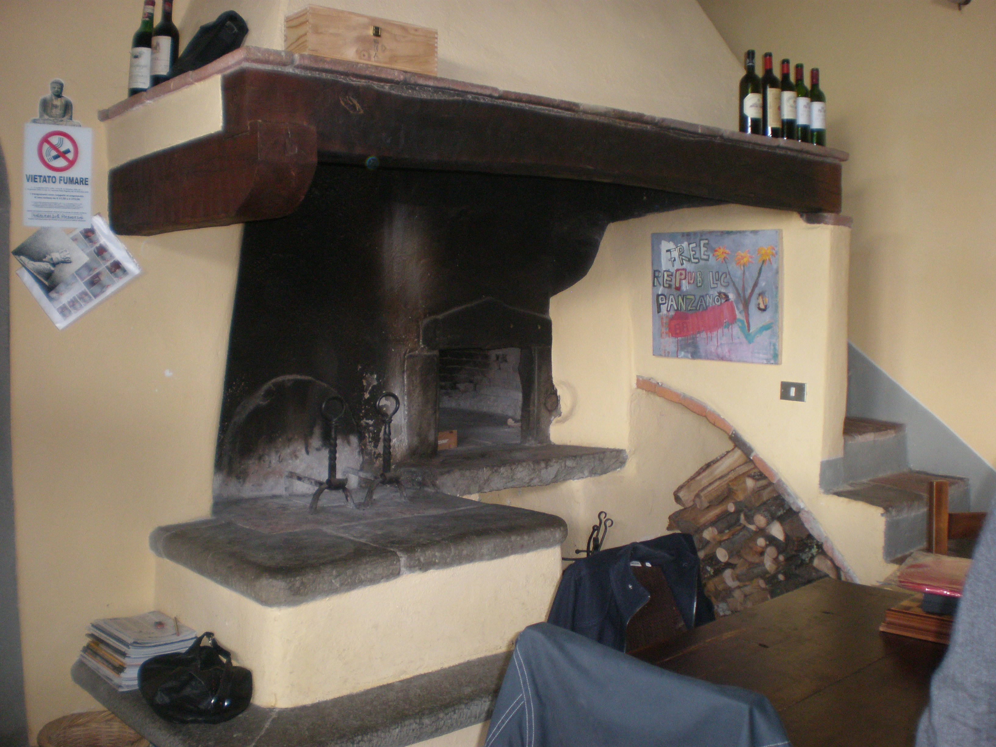

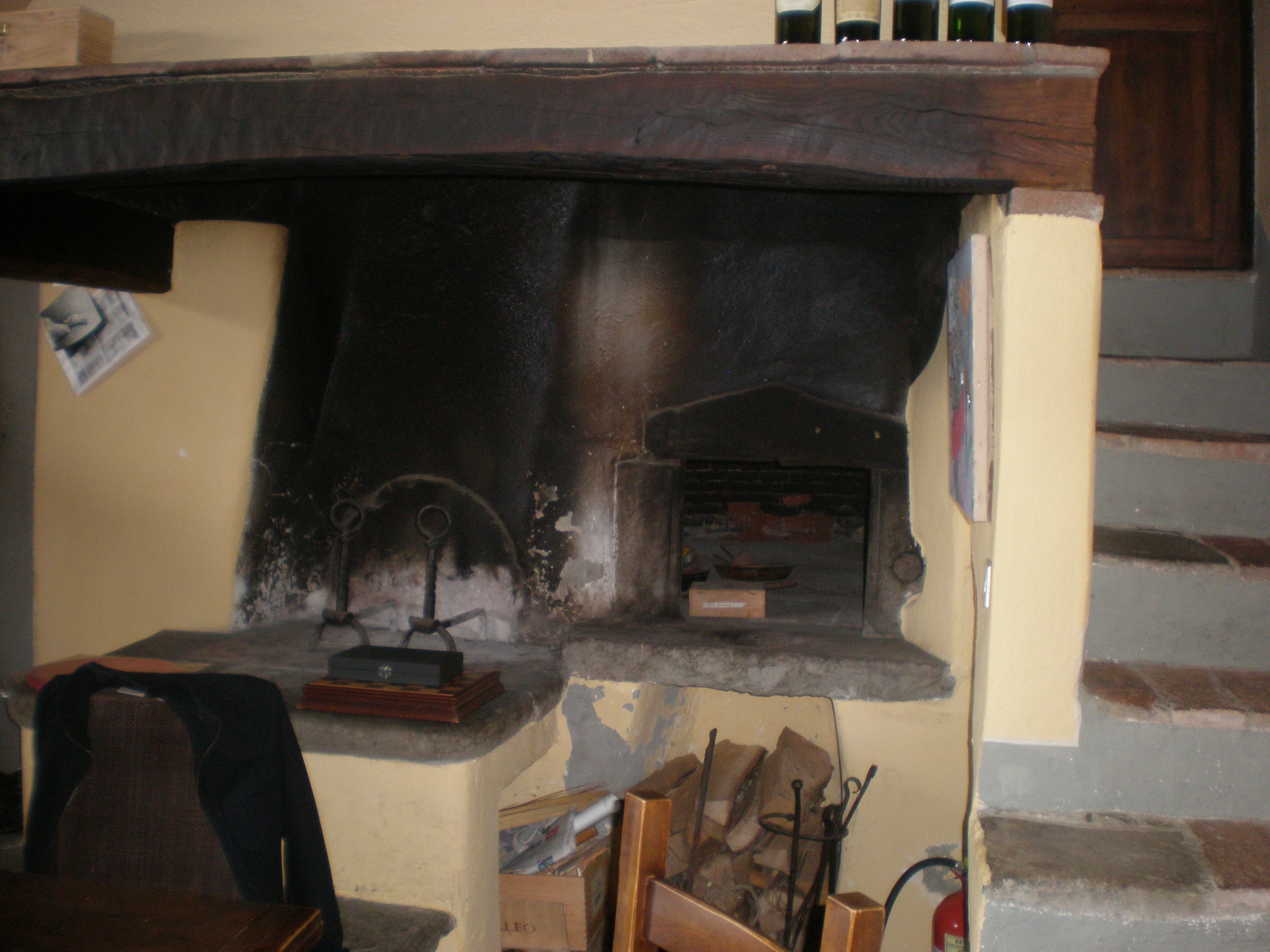

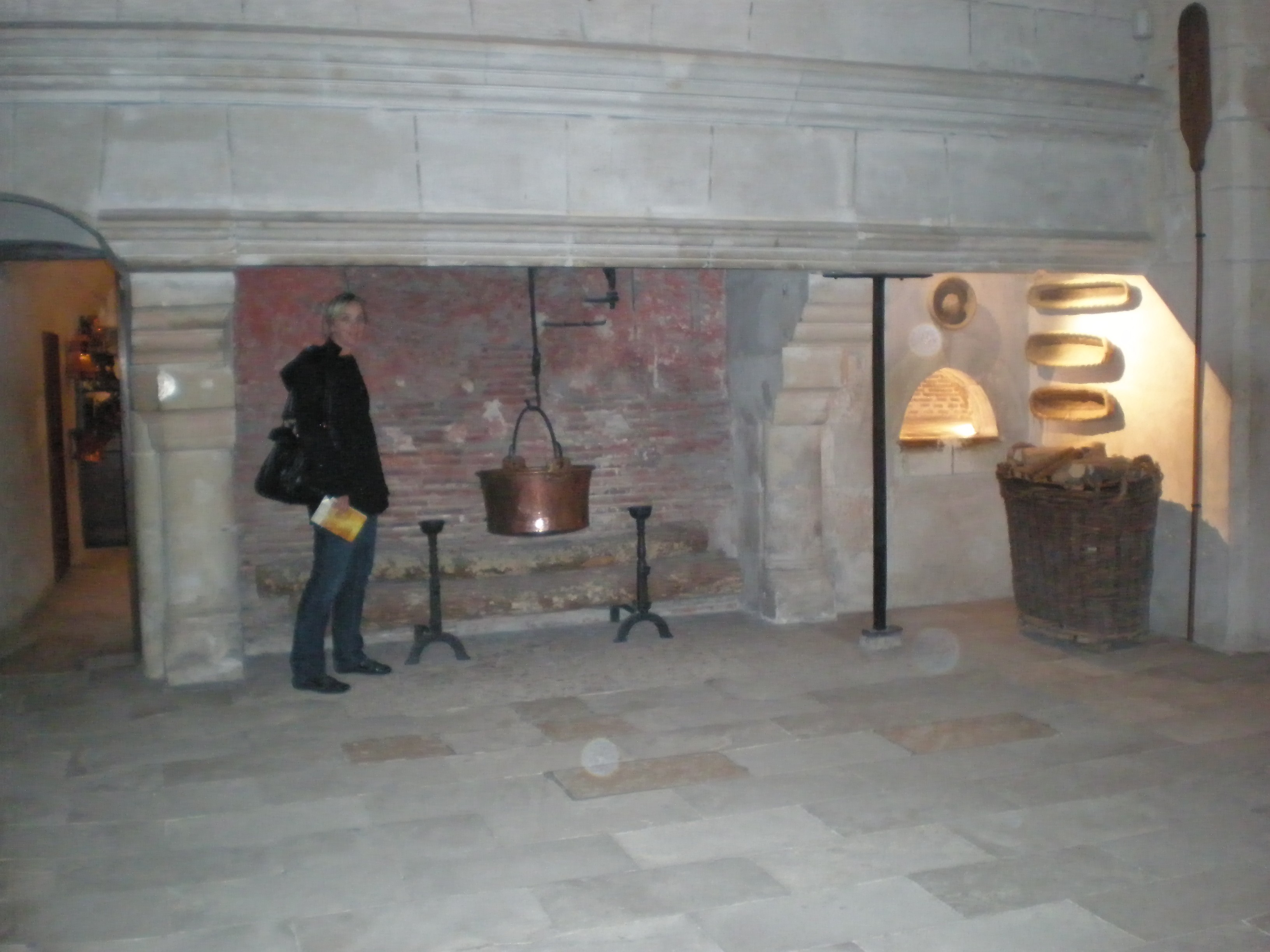

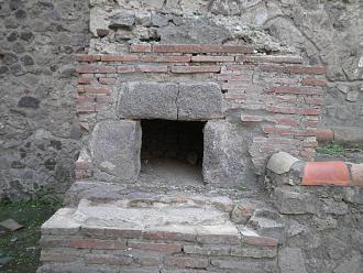

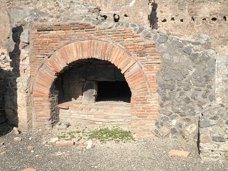

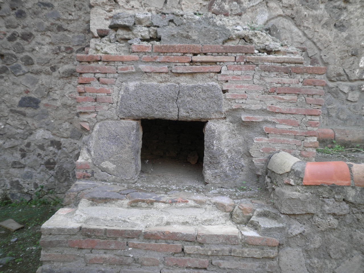

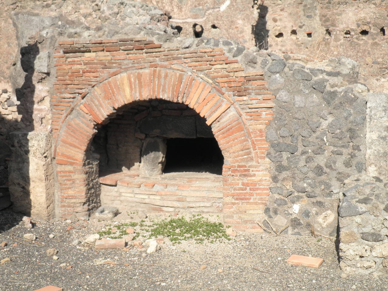

            For a Pompeii style oven, that is an oven with a flue at the front, it is a cross draft system which requires good smoke flow when the oven is cold and the cool flue is not creating a draft. In fact if you visit Pompeii the large oven at the bakery has such a cross draft flue, but in operation was probably never cold, being fired every day. Taking a decent look around there are many smaller ovens in private homes there where the ovens were much smaller and had updraft systems. That is, a flue rising from the apex of the dome in much the same way as ancient Roman kilns. Having built one of these kilns, I also built my first oven using the same system. One big advantage is that it draws beautifully from cold and presumably was the preferred option in Ancient Rome for private homes. Very annoying to fill your room with smoke. A second advantage is that there is no deep tunnel to have to work past creating much better access. The down side is that the heat jumps straight to the flue so there is a higher fuel consumption.
            These pics show an old oven in Penzano, Italy that utilises a fireplace to draw away the smoke. Most kitchens in old castles use the same system.
            Click image for larger version  Name:	Penzano oven.JPG Views:	0 Size:	1.42 MB ID:	419689 Click image for larger version  Name:	Penzano oven detail.JPG Views:	0 Size:	1.42 MB ID:	419690 PenzanoClick image for larger version  Name:	chinon castle.JPG Views:	0 Size:	848.3 KB ID:	419691 Click image for larger version  Name:	Pompeii 3.JPG Views:	48 Size:	365.9 KB ID:	419695 Chinonceaux
            Pompeii
            Click image for larger version  Name:	image_88767.jpg Views:	48 Size:	377.8 KB ID:	419692
              Click image for larger version Name:	Penzano oven.JPG Views:	0 Size:	1.42 MB ID:	419689 Click image for larger version Name:	Penzano oven detail.JPG Views:	0 Size:	1.42 MB ID:	419690 Click image for larger version Name:	chinon castle.JPG Views:	0 Size:	848.3 KB ID:	419691 Click image for larger version
ID:	419695 Click image for larger version

                              My apologies, I did not label the pics in that post, and that may have caused you confusion. I have now done so.That particular pic was not the one in Penzano, I think it was in Chenonceaux, Loire river France. Although the peel on the right is very long, the oven was not. I suspect someone mistook it for an oven peel but it was more likely a barge pole/rudder used when transporting goods on the river as Chenonceaux straddles the river.
