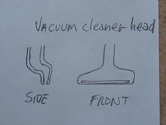

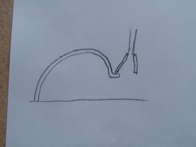

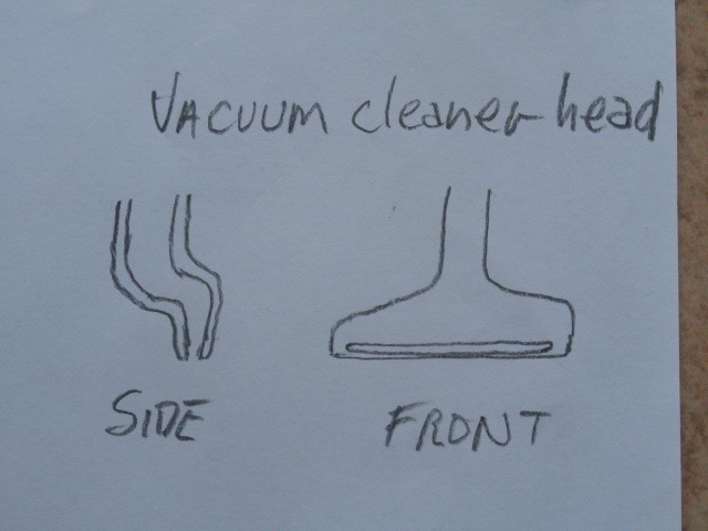

    Just to clarify, when you say oven size being the diameter of the oven's footprint (in relation to dtermining flue size) are you referring to the inside diameter of the oven?
    Yes it's the inside diameter. The draft ,pull or power of the flue is determined by its diameter and height, the diameter having a stronger effect.
    The flue gallery can be made reasonably shallow if cast in refractory or fabricated in sheet metal. It is extremely difficult, if not impossible, to do this with brick units. Vacuum cleaner heads rely on a similar principle where the width of the entry is wide but quite shallow. This means the area of the intake is about the same as the cross sectional area of the pipe. But for an oven you want the bottom area of the flue gallery quite generous but at the same time quite shallow. Think of a funnel being squashed flat.
    Click image for larger version  Name:	P3150871.jpeg Views:	0 Size:	46.3 KB ID:	419996 Click image for larger version  Name:	P3150872.jpeg Views:	0 Size:	41.4 KB ID:	419997

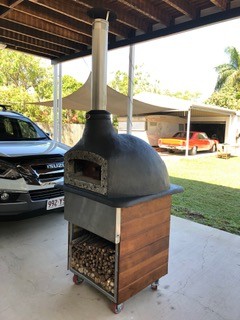

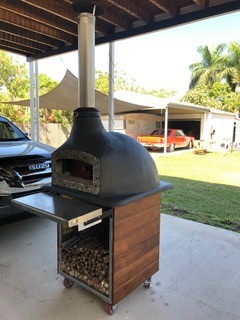

          A good solution is to have a flip up stainless shelf attached to the oven. That way you can use the oven both ways. If I get time I can search for a pic of one in a recent build.
            • 9211
            #20
            Here you go.
ID:	420033 Click image for larger version

            • Alomran
              • Jul 2016
              • 170
              #21
              Great idea! Many thanks for taking the trouble to dig the photos. I think I will try to work out the same mechanism if I can find a thick stainless steel
